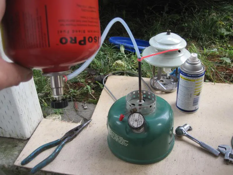

Keith, What adapter do you use to refill the small canisters?
Brian Falkowski
ICCC Member #1437
Posts: 4392
Re: WTB LP Fuel Canisters
You don't need anything fancy, you fill them on the appliance and just remove whatever jet/nipple is on top of valve. Which lantern/stove do you wish to refill?? If I have one I could shoot some pictures for you. I used to have a couple posts about this most got scrubbed.
Posts: 4392
You can buy cheapy china stoves off ebay to get the valve and hose.. That hose is fuel hose for those little gas powered airplanes. To do lilke above you need to remove jet. Those butane cans with plastic tips?? Just do like pictured above, you don;t need the hose, just stick tip down generator, open valve and let it rip. When can full enough, shut valve. Just that easy.
Having the can on the lantern cold, and the donor warm, will speed process.
Posts: 4392
This is just a parts lantern, but you get the idea
