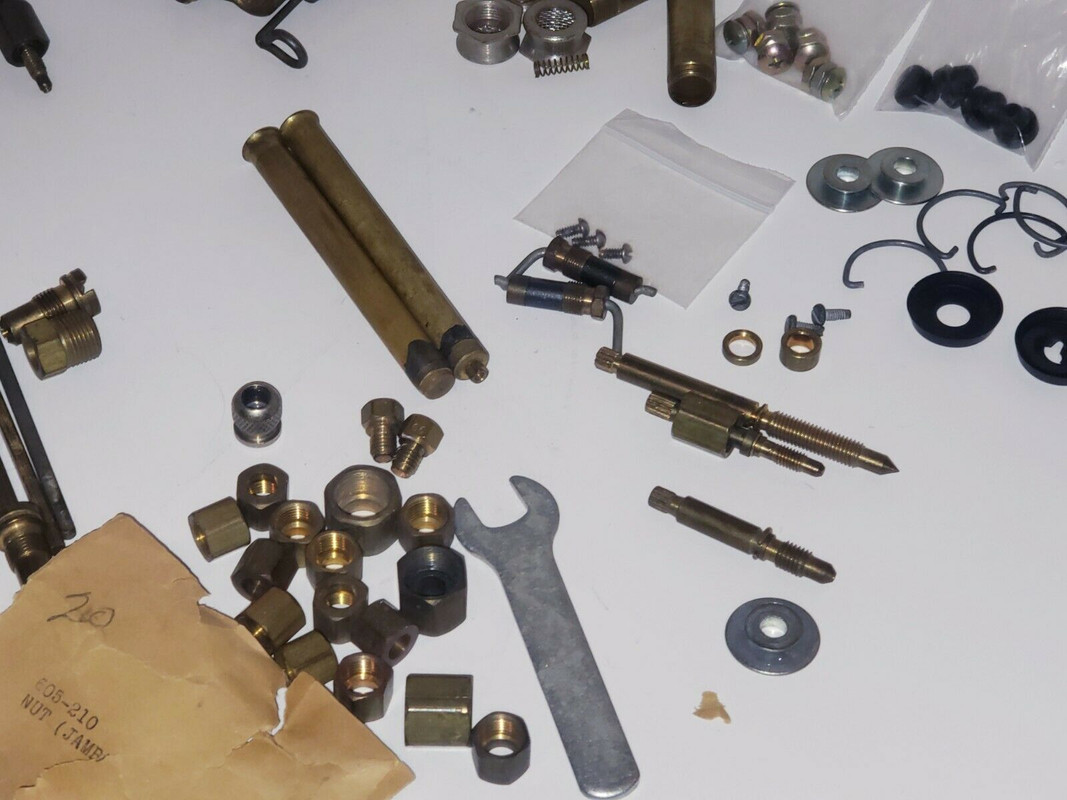

this is not my pic im lazy , but it shows em side by side for a pretty good comparison :-) this seller sold me the one on the right for 20 clams including shipping :-) i hope we communicated good enough that i get the right one LOL
Posts: 8791
Re: Coleman 249 scout generator
well , the seller of the generator wrote me telling me the pricker was missing and it only had springs inside no packing . for 20 clams i said send it anyways , that included the shipping .
