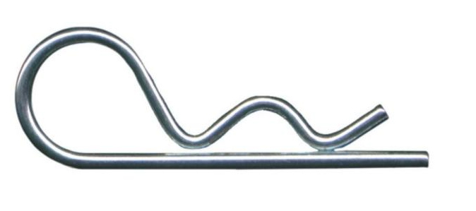

I still need to figure something out to make sure the cup doesn't slide up the generator and hit the mantles if the lantern gets tipped or jostled and clean the soot off the top half of the air tube assembly, but I'm just glad the thing works for now.
Good work on the DIY p-cup.
Take a look at your local hardware stores/farm supply for one of these:
Everyone seems to call them something a little different--hitch pin clip, hair pin clip. They come in some small sizes that should fit the generator tube thereby preventing your p-cup from crashing into the mantles.
Posts: 2411
Re: 220 kero conversion
Hey Leadfoot, I'm sure the regulars here are tired of hearing me say this, but elevation matters. That's why the tuning is required. At 338', not so much as 3800, but enough to make a difference.
I call those clips clevis pin clips. They work great.
