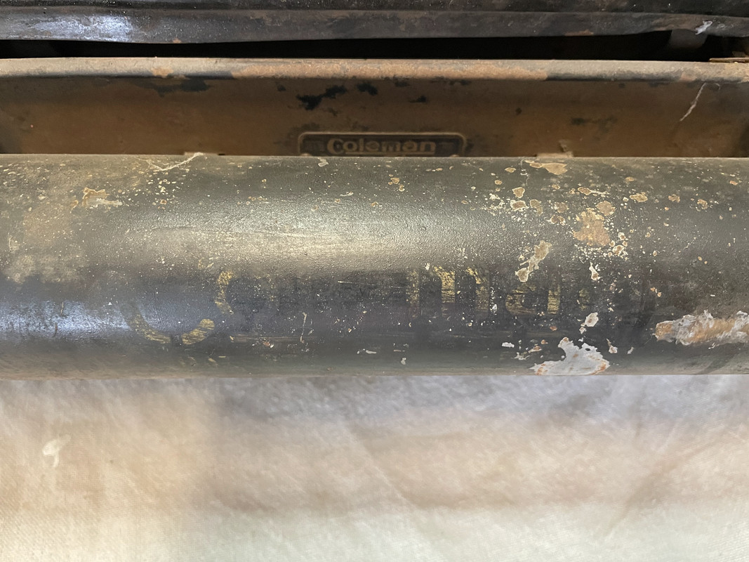

I have a model 2 of my grandad's and I've got it running thanks to your help. Now I think I'd like to make it look good. It's almost completely disassembled. I've pulled the hinge pins as much as possible to get the oven taken apart.
Questions about paint. What do I use? High heat I presume but I can only find this in flat black and I think the originals were gloss.
Also, any idea where I might get a stencil? "Coleman". "patent app'd for"
I'm also confused by the model number - the tag says "model 2" but I think there are 2B,C,D etc.
Thanks for any ideas.
Jack

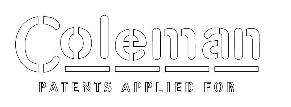

I have a version with the "PATENTS APPLIED FOR"
I'll have to see if I still have an actual cut stencil. I do have the graphic, if you have the means to get it cut.
When spraying the stencil, I recommend using an airbrush. If you have to use a spray can, mask everything around and spray it with the can about 2 feet away. As you can see, the gold paint on the original stencil is not thick...it's actually uneven with some areas of the lettering lighter than others. Give it that mass produced look.
Original stencil
Rodney

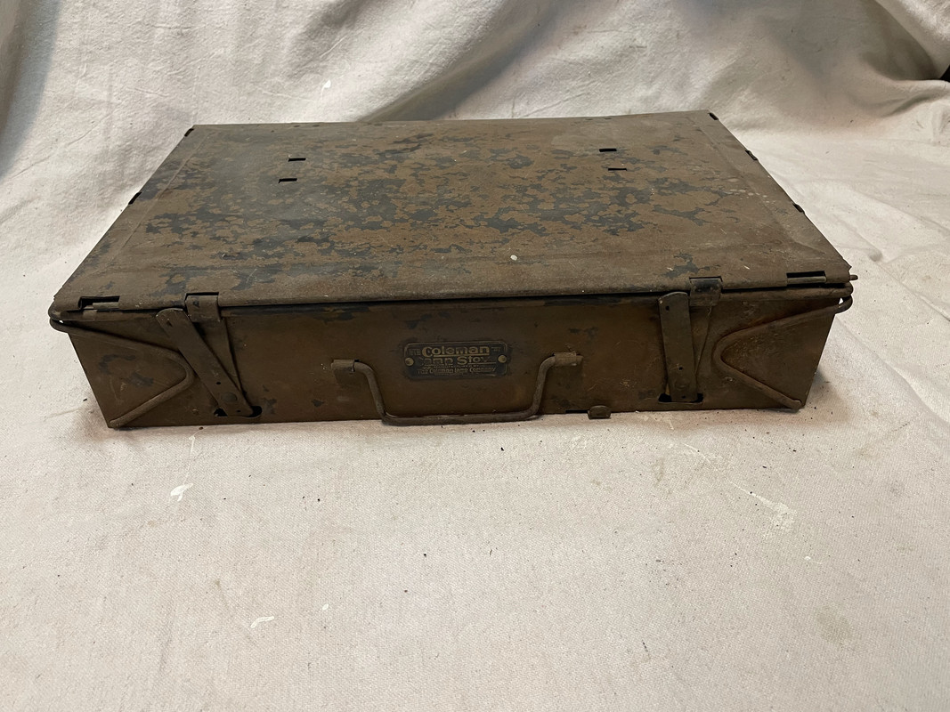

I'm taking all the comments under advisement regarding "to paint" or "not to paint." Funny I had read about the "patents applied for" on the 1 and not the 2 but it's there for sure although difficult to see in the pictures. Mine has wire legs and the funny latches on the front.
Thanks for the graphic. I think I can print, scale, and use this. It's pretty much exactly what I was looking for.
...and as always, still looking for an original key. I was able to fashion one out of an old skate key but not the same. Sadly the young lady at the antique store had no idea what a skate key was. Makes me feel really old.
Below are some pictures.
Jack
