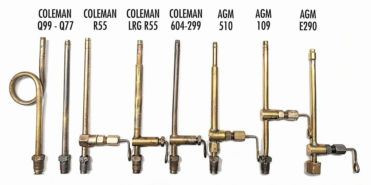

I'm working on a couple of 4A irons right now. One has a functioning gen, which has a T tip. The other has a gen that's pretty much FUBAR and missing the tip. I have several new R55s, which have V tips. I also have what seems to be a pretty nice condition rotary-type gen that has an O tip.
What is the O tip for? Is this an iron gen? Will it work on a 4A?

The 604-299 gens use a capital I marked tip that measures 0.0085 where a typical 220 gen is 0.008. This is minimal and should run just fine. I'm not aware of any O marked tips... Are you sure it's not marked Q?

What would the Q be? Are there other differences between lantern and iron rotary-type gens?

The Q is the same as a V at 0.008 but most are not shielded to protect the pricker although there are some out there. Only difference i see in a 604-299 and an R55 other than orfice is the gen body size.

I guess it could be a Q?
I have several old, salvaged R55s that look identical to the gen that came in the iron. I don't think I've seen the R55 version you have third from left.

If your gen has a thin body with the not easily removable pricker lever it is a 604-299 instead of the R55. These all run fine in Quickliteing lamps and lanterns. The R55 I have photoed was the original that came out for the 480 heaters... the Jumbo R55's all have the fatter body with not easily removable lever.

The V tip will work fine on a 604-299 iron generator. An iron generator will work on a lamp. A R55 generator will work fine in a iron.
My theory is the extra .0005” in the I tip allows the iron to be throttled down without shutting it off.
