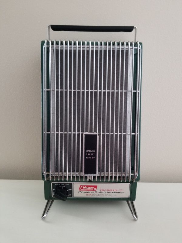

Posts: 1227
Re: Coleman heater melting
Not a fan of the stinky mushroom heaters. Come over to the dark side and get a propane one? No smell and they work flawlessly...campinut
