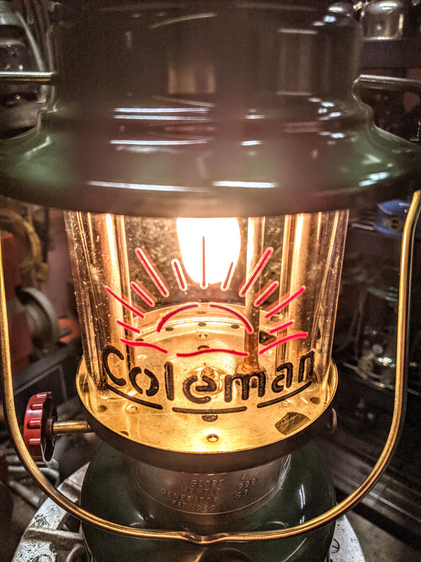

Al I've not tried restoring them but I have played around with painting some custom globes with good results using VHT

The logos aren't etched into the globes, they're painted on. You would need to find a way to apply the paint on top of a raised surface.

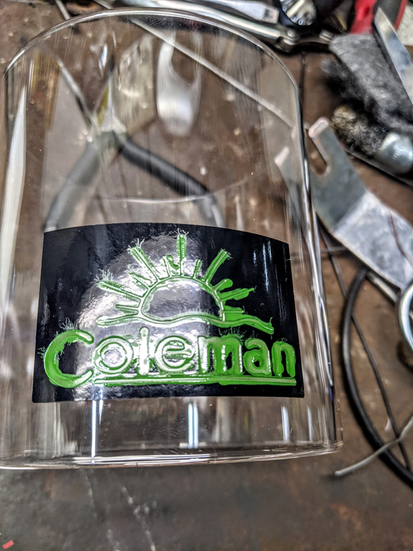

Al I'm going to get started on a painted globe project I had forgotten about... Hopefully pictures tomorrow. Time permitting.

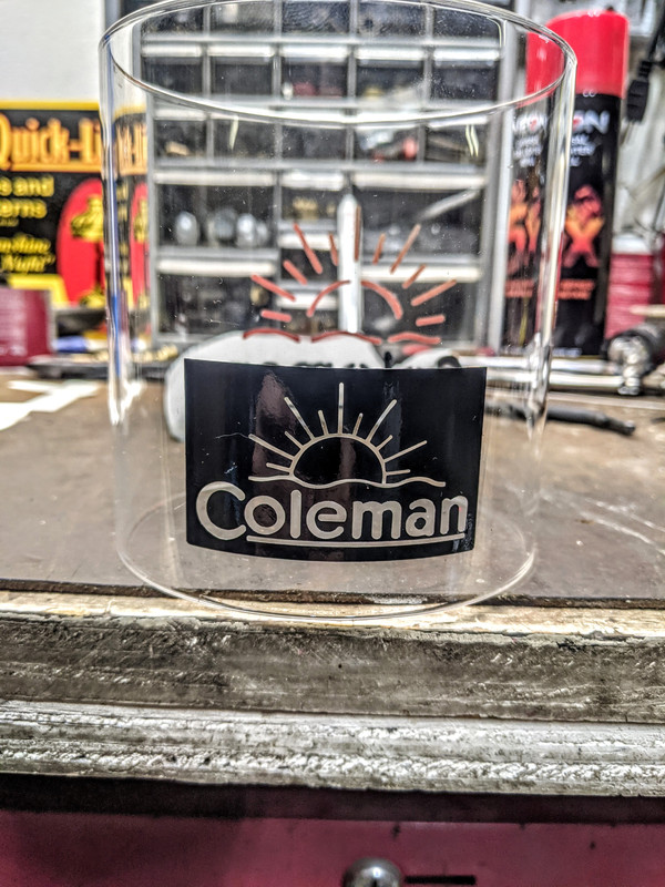

Kevin the one above was stenciled with vinyl then etched with a sandblaster and a couple coats of VHT baked per instructions on the can.
Tomorrow will just be a vinyl stencil and a high temp paint pen... Cutting stencils tonight.. Should have some results tomorrow.

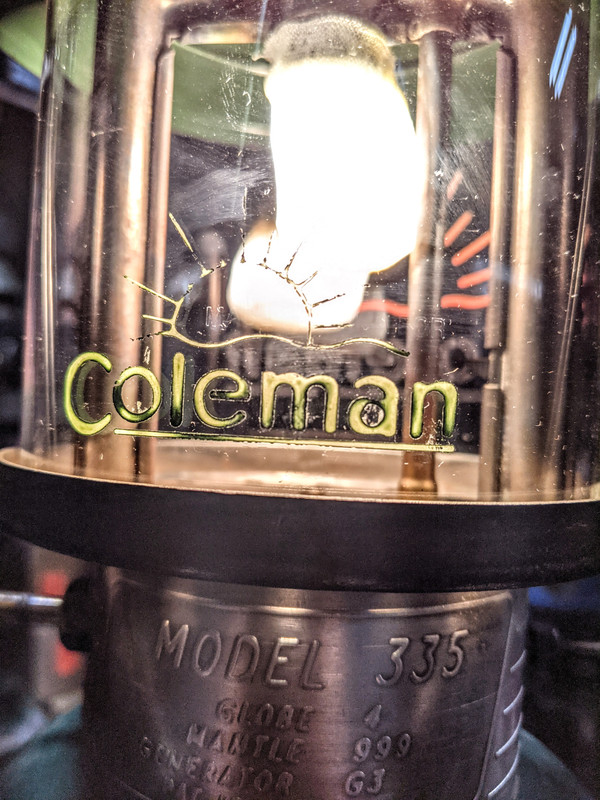

Okay I had a few minutes to run back to the shop this evening and get a stencil and some paint on my experimental globe... Actually laid down splochy kind of like the old Coleman straitlines looked... Will get some more results in the morning.
Posts: 4247
Re: Faded globes...

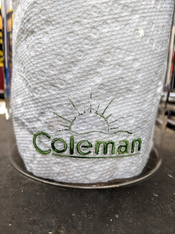

Well a little success, a little failure this morning. The large print came out looking really good. Even kind of splochy like the original straitline globes. The finer sunrise the paint wanted to stay with the vinyl when I removed it... Still looks better than some of my sunrise globes 😁
I will run this today to see if it burns off, then I'll give it a rub with my thumb and see if it comes off...

Toby, after baking the VHT to the globe, how well does the paint remain adhered to the glass surface?

Seems to hold up well. I've got lots of run time on it and occasionally rub it with my thumb and no paint loss to speak of. Have not tried common window cleaners on it yet.
