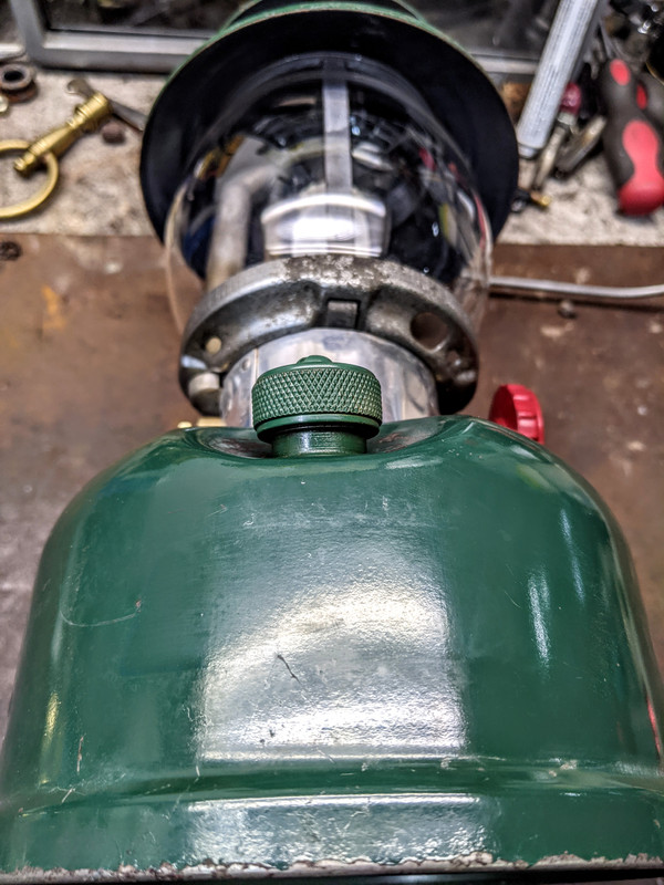

My experience with the water slide decals is acetone, or carb cleaner will eat it faster than the paint below it. I just wet a towel and dab the decal slowly making sure not to remove any of the paint underneath the decal. Then buff the renewing paint when through.
You can vaguely see where this one was.

Thank you.Tgarner01 wrote: ↑Fri Jan 08, 2021 8:58 pmMy experience with the water slide decals is acetone, or carb cleaner will eat it faster than the paint below it. I just wet a towel and dab the decal slowly making sure not to remove any of the paint underneath the decal. Then buff the renewing paint when through.
