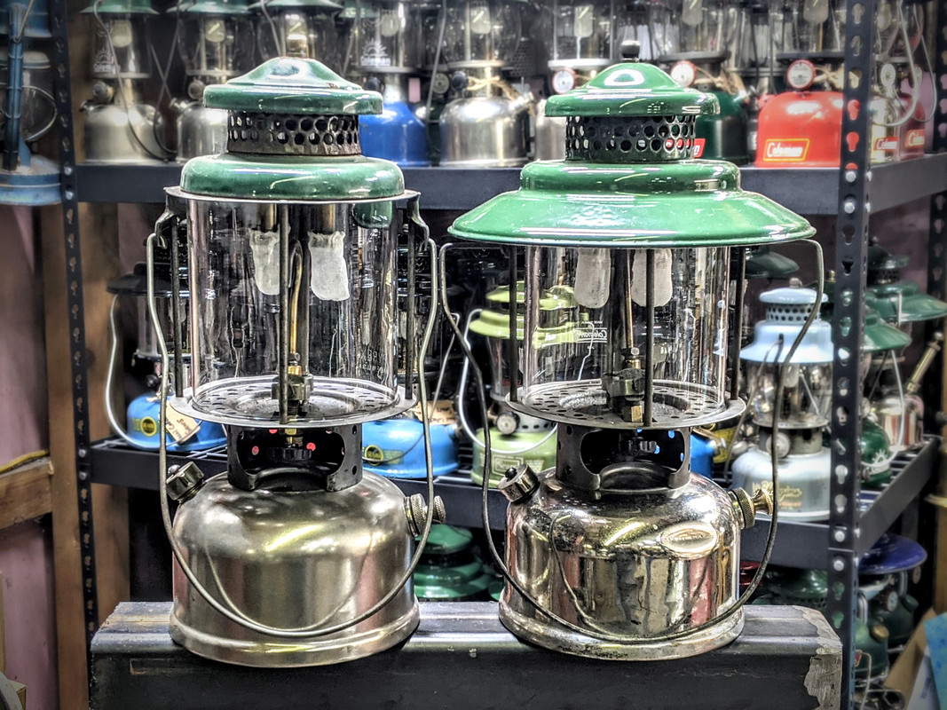

Here you can kind of see the slant design on this Frank I built.
