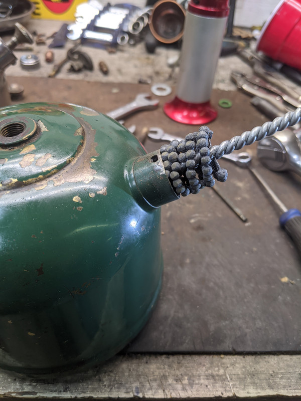

Brake cylinder honing tool.

Yep, does a quick job.

I see a hone.

I see the Flex Hone that Toby posted. That's the tool I use for rusty pump tubes. Works great.

Yes Kelly that is the one I ordered. You could get by with a finer grit, but the 240 does just fine. I'm shocked at the price increase... Possibly a cheaper source available?

This is what I use. The pump tube tends to be pitted from the rust, and a flat-stone type cylinder hone will have to remove metal from the tube until the surface is flush with the lowest pit. The Flex Hone is, well, flexible, so it just smooths everything out and removes much less metal. One of these will likely polish every rusted pump tube you encounter in a long life of fettling.

I just got the 7/8 flex-hone to use on rusty pump tube. It looks a bit big - do i need to kind of cram it in there? Or did i get one size too big?
Posts: 6712
Re: Pump tube
3/4"!
I didn't read the description from Azon.
3/4" fits perfectly.
Posts: 4853
Re: Pump tube
Phredd wrote: Tue Feb 16, 2021 10:24 pm I just got the 7/8 flex-hone to use on rusty pump tube. It looks a bit big - do i need to kind of cram it in there? Or did i get one size too big?
It'll go in there Phredd. It's a little snug, but works.
