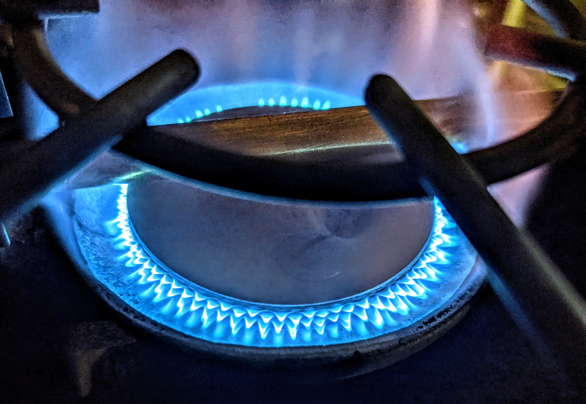

Re: 500 Stove Temp...
This is one of mine on the first fire up after cleaning it. Flame was definitely above the grill.

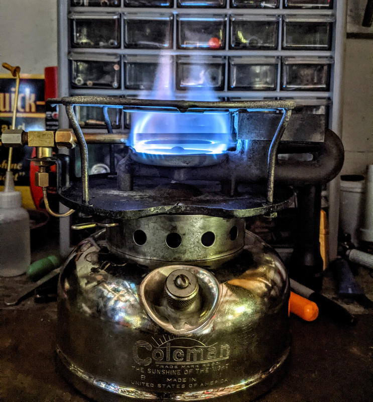

Mine runs great, but the flames seem to just barely exceed the height of the grate:
500A seems just a bit more:

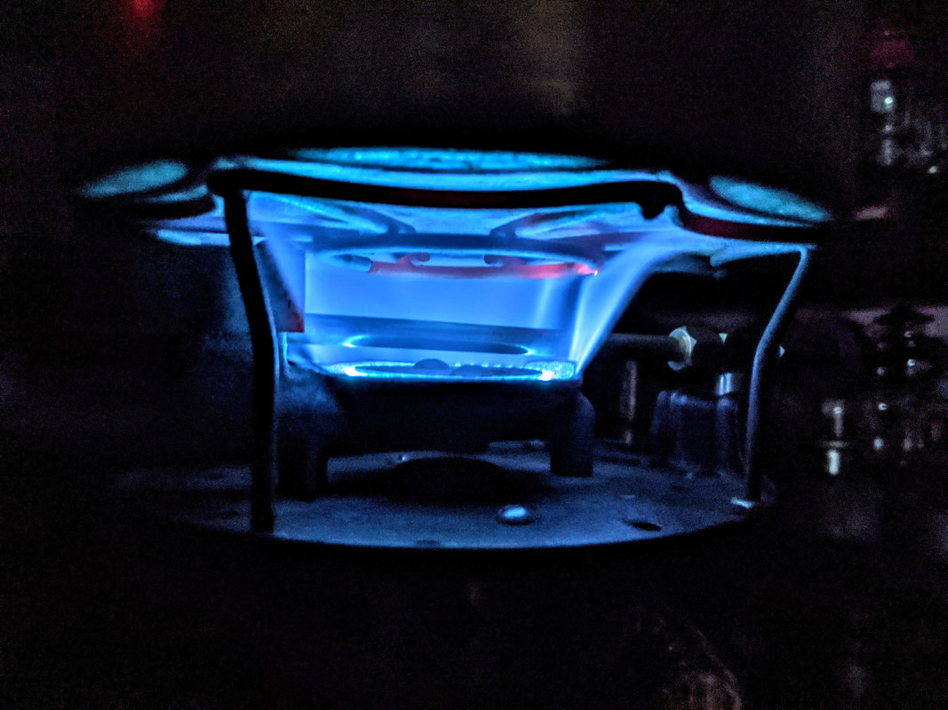

Had to heat up some citric today, so I got you a wide open shot of mine.
