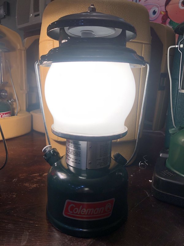

I have a 290 that I really like and I was looking for another on ebay and found a 290A without a frame like my 290 and it has the bulged globe like the 639. I bought it and it is on the way. The generators are hard to find. I would love to stick a 639 generator in it just to have the versatility. Is this confirmed to run Kero and CF like the 639? Also what mantles should be used? Thanks.
William

The 290 pictured arrived today with a broken globe. I have had really bad luck with globes lately :(
William

Ouch! Those large bulge globes really set them off nicely though.

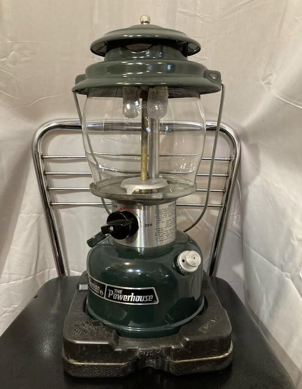

OK. I hooked up the 639 generator to the 290. I moved the preheater cup to use on the 290 as well. I preheated and got a nasty fireball. That was scary! decided to clean it up and try again with more preheating with a little torch. I got it plenty hot and openet the fuel slowly. Seemed good for about 5 seconds then same mess that nearly made me pull the trigger on the fire extinguisher. After the excitement I emptied it and pressurized it and checked for leaks then I put CF in it and it ran just fine. Not sure what I am doing wrong here but I will keep playing with it.
William

How long did you preheat? Usually I fill the cup and let it run until almost empty, so that's maybe a couple of minutes of preheat. Kerosene takes a while to get hot enough.

Round one - full cup and a guess of 2-3 minutes. Round 2 - full cup plus torch before and after and a guess of 4-5 minutes total and that time it was plenty hot. Generator is brand new and no leaks. It seemed as thogh it just shot it out so fast that it didn't have time to vaporize anything that was not already in the generator. Maybe the hole is just too big and I could control it more by just barely opening it. Problem with that is at a someone (me) will come along and turn it up after it is lit. I will get to it again hopefully this weekend. do you think there might be different generators that can be labeled for the 639? I can pull a used one off of a 639 and put the new one on that test it that way too.

1freshfind wrote: Mon Nov 15, 2021 4:47 pm OK. I hooked up the 639 generator to the 290. I moved the preheater cup to use on the 290 as well. I preheated and got a nasty fireball. That was scary! decided to clean it up and try again with more preheating with a little torch. I got it plenty hot and openet the fuel slowly. Seemed good for about 5 seconds then same mess that nearly made me pull the trigger on the fire extinguisher. After the excitement I emptied it and pressurized it and checked for leaks then I put CF in it and it ran just fine. Not sure what I am doing wrong here but I will keep playing with it.
You may have answered your own question here that I have marked in bold print. The 290 is not designed to burn kerosene, but CF. The 639 gen has a slightly smaller orifice than the original 290 gen, but should work fine on CF. Keep in mind that the 290 lantern is a dual mantle lantern, while a 639 is a single mantle jobbie.
This is just my guess, but I would say if a 639 gen works well with your 290 using CF, you have found the solution!

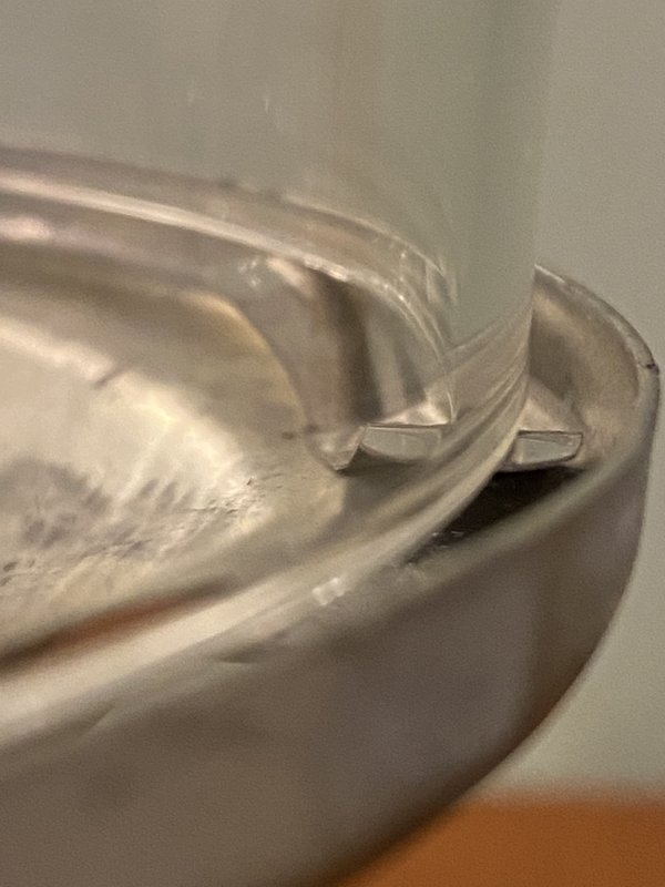

Coldwaterpaddler wrote: Tue Nov 16, 2021 3:57 am
1freshfind wrote: Thu Nov 04, 2021 7:14 pm The 290 pictured arrived today with a broken globe. I have had really bad luck with globes lately :(
I just read this, and that's really sad. My 290A with the bulge globe has a 2" crack and I glued it and used it every night for a week up in the mountains. I bought several replacements, but all of them are too short and the globe rattles around in the lantern. My 290A has spring supports at the bottom which holds the globe snug to the vent. I bought one from American Mantle, a Chinese Coleman version and and unmarked one from OCP and all were too short. If you find one that actually fits like the original, please post that info. Thanks.
This is a globe for a 639 and it is the best fit I have seen.
You can see in the second pic that the spring supports are about half way up the lip of the frame giving it a little push down without fear of sliding out . The diameter could be a tiny bit bigger. It wants to shift off center but at least it's not rattling around like crazy. It's not perfect but it is the closest I have found and is not that bad.
Here is a link to it in OCP.
https://www.oldcolemanparts.com/product ... at=&page=1
William
Posts: 1302
Re: 290 (CLX) Generators unobtanium?
I think that's the same one I have. My spring clips might be a little different than yours or just more worn out. I'm a little afraid to bend them back up again.
1freshfind
Posts: 127
Joined: Fri Jan 29, 2021 6:57 am
Post by 1freshfind »
Coldwaterpaddler wrote: Tue Nov 16, 2021 5:00 am I think that's the same one I have. My spring clips might be a little different than yours or just more worn out. I'm a little afraid to bend them back up again.
Are your springs laying flat or touching on the ends? I bet the original would rattle too if that's the case. I do not know for sure as I have never hade an original one for this lantern but he original globes on my other lanterns with these type of springs would rattle around if they got bent down too far over time. I have bent several of them up multiple times without any issue that I can remember.
William

1freshfind wrote: Tue Nov 16, 2021 3:50 am
Ok. Definitely gonna try and make sure there is Kero in the generator while preheating. The second try it was very well pre heated but there may not have been any kero in the gen either time. I didnt think about that making any difference. The generator you use is a straight up 639 without any modification right?
Yep, straight 639 Gen with no modifications. Take it apart before you install it, see the difference between kero and no kero gens. No fiber tube and two coils.
My mantles start to glow during preheat, as some of the fuel vaporizes and wanders into the mixing chamber. Lemme know if yours do the same.
Willy
Posts: 1302
The original does not rattle. The springs are rather bent over such that the ends touch the frame, however, they are still arched. Not flat.
1freshfind
Posts: 127
I have the same frosted globe that zoomkat has and I can say that it does not fit quite as well as the 639 globe fits the 290a but his mod looks like it would work just fine on either. Either way they are just a bit too short. If you tried that with that frosted globe it would slide right over the frame. I have no mods on my 290a just pulled up springs and I am comfortable with it but I like zoomkats mod and it is a whole lot cheaper.
William
