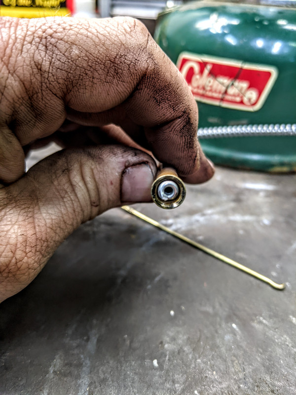

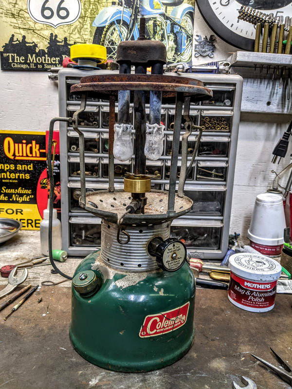

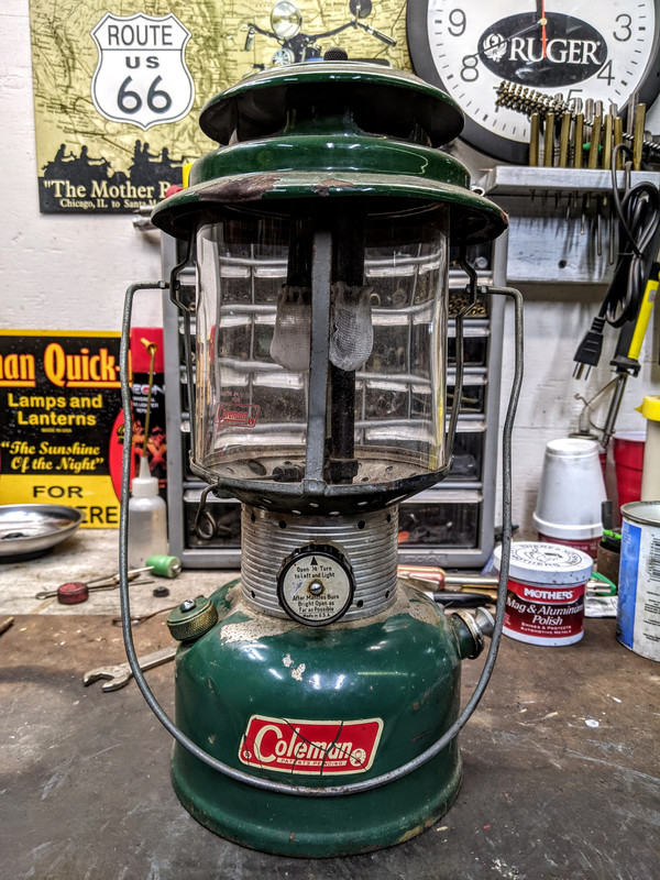

Thought I would share my failed attempt at converting a 220F into a Kero burner. I started off with this ratty ole 220 That had been sitting on the floor. I remembered it running fine the last time I fired it up so I immediately pulled the generator apart and started swapping parts.

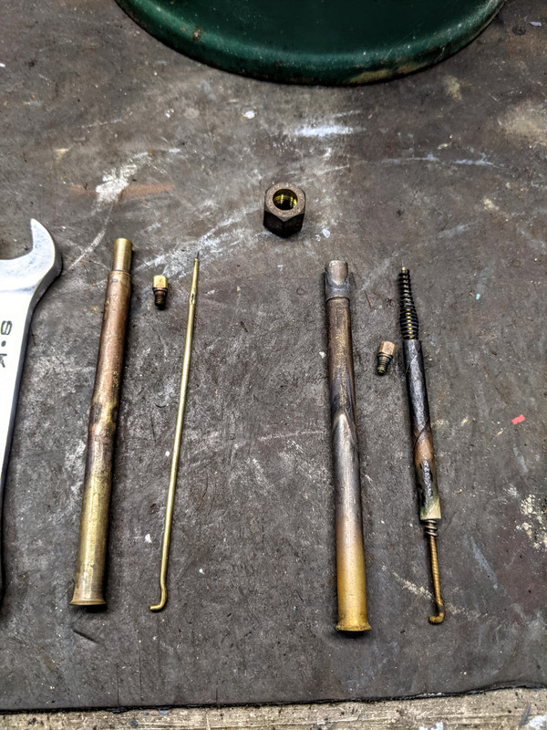

Here's the generator guts on the right with donor 200 pieces on the left.

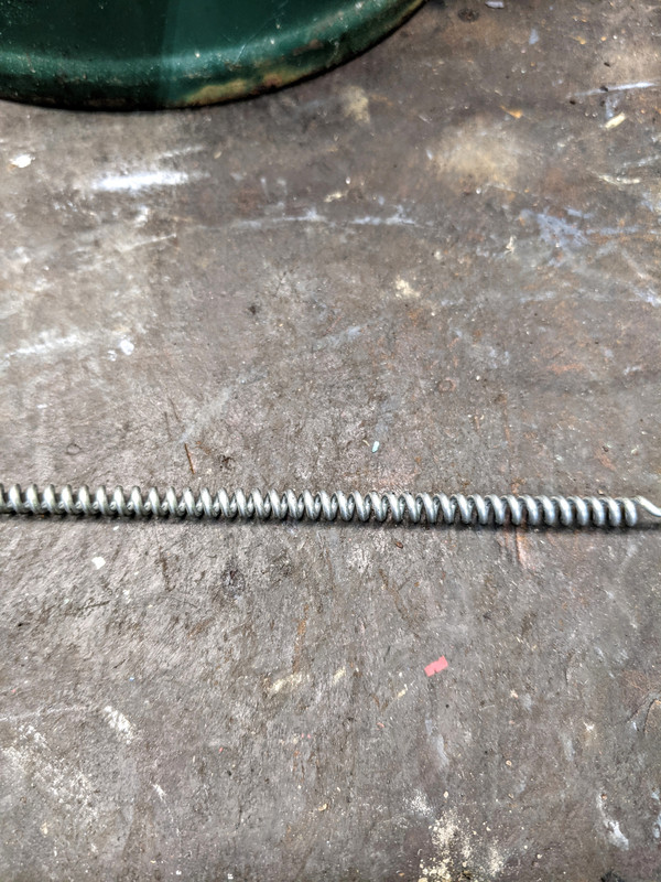

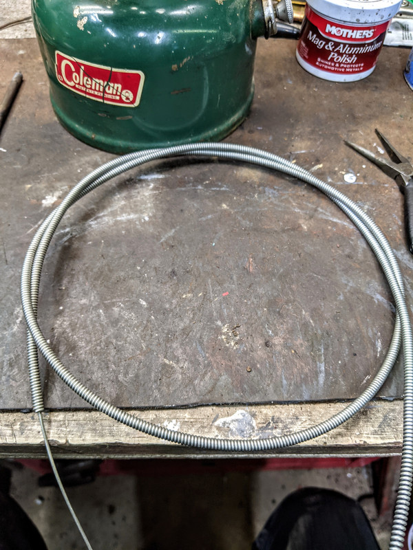

In the past I have used choke cable housing for generator guts on RUG burners. I thought it would work just fine here in a kero conversion.
Here we are all reassembled ready for a preheat.

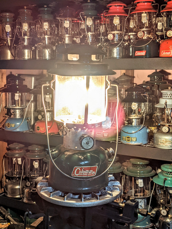

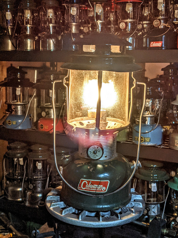

An original 220 orfice is .008 the 200 orfice is .007. I was getting a very yellow with slight over burning mantles with this setup, so I decided I would try the pricker and orfice from a 201 generator which is smaller yet at .006. It was still dim, with a yellow color to it but no over burning now. Scratching my head I decided to put it all back to factory, with clean white gas to make sure I hadn't imagined this thing running good in the past. Sure enough, it run like it's supposed to.
With a .006 orfice on kero:
With a factory .008 orfice on Crown:
This was never anything I was going to keep, just more of an experiment and to have a little fun. Curious though as Coleman had burners very similar to this without air restrictors that run fine on kerosene... Thoughts?...
PS what a pain to install a generator in a 220 with a preheat cup and a burner cage! Ham hands!!

I've only converted one 220, and it's an F. I did basically what you did, swapped the tip with a 200 and a coil in place of the packing. The coil was from a Coleman generator, but I don't know which one, I have a little bin of miscellaneous ones. It runs steady, nice and bright. Is that choke cable housing steel? Maybe it's not getting hot enough to fully vaporize the kerosene? Try a different coil material before you give up.

Mister_Wilson wrote: Thu Apr 01, 2021 12:24 am I've only converted one 220, and it's an F. I did basically what you did, swapped the tip with a 200 and a coil in place of the packing. The coil was from a Coleman generator, but I don't know which one, I have a little bin of miscellaneous ones. It runs steady, nice and bright. Is that choke cable housing steel? Maybe it's not getting hot enough to fully vaporize the kerosene? Try a different coil material before you give up.
John it is steel and that thought had crossed my mind as well. While it was running I used a propane torch at the base of the generators for a good while with no noticable change in the way it run.

Try a copper stranded coil. Heat transfer may be better. (But remember I'm nearly at sea level here, so everything I try works great.)
