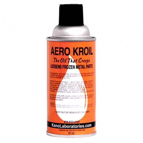

Old Style Filler Cap Issue
burnt bacon
Posts: 374
Joined: Mon Nov 09, 2020 10:22 pm
Re: Old Style Filler Cap Issue
#51
Post by burnt bacon »
zoomkat wrote: Sat Apr 24, 2021 6:17 pm "can't get the screw out of the disc on any of them..."
Not sure just how the tool previously pictured works, but something similar might be made from wood and two clamps to squeeze the cap and insert together to allow turning the screw. The below pictures are just a clearance test for using a small pair of round jawed vice grips ($1 from the DollarTree store) to clamp the cap and insert together. A little grinding on the vice grip teeth and small pieces of plumber's rubber for padding might get the cap and insert locked together. I'd use some 400 grit wet auto body sand paper with a flat wood block to make sure the tank filler neck surfaces are dressed smooth with no pits or rust on the edge.
TY for that insight...
Stovie at heart...
Rustytank
Posts: 907
Joined: Sat Nov 09, 2019 7:29 pm
Re: Old Style Filler Cap Issue
#52
Post by Rustytank »
Here's how the cap tool works
The small Allen screws clamp the body of the cap to keep it from slipping. The big bolt provides clamping force from the bottom to keep the cap insert from slipping.
The hole in the top provides access to the screw. Use a screwdriver that fits the screw head properly.
Put the whole tool in a vise clamp to hold it securely while removing the screw and the cap comes apart easily.
275 Appreciation Syndicate #0245
Looking for birthday lanterns 11/58, 3/68, 3/73, 11/96, 6/97, 11/97, 12/00
Rustytank
Posts: 907
Joined: Sat Nov 09, 2019 7:29 pm
Re: Old Style Filler Cap Issue
#53
Post by Rustytank »
Well the pics are a bit out of order and I can't seem to straighten it out. But you get the idea.
275 Appreciation Syndicate #0245
Looking for birthday lanterns 11/58, 3/68, 3/73, 11/96, 6/97, 11/97, 12/00
burnt bacon
Posts: 374
Joined: Mon Nov 09, 2020 10:22 pm
Re: Old Style Filler Cap Issue
#54
Post by burnt bacon »
Rustytank wrote: Sun Apr 25, 2021 12:37 am Well the pics are a bit out of order and I can't seem to straighten it out. But you get the idea.
Thanks for the explanation and pictures, Rustytank...!
Stovie at heart...
Posts: 1761
Re: Old Style Filler Cap Issue
#55
" But you get the idea."
Yea, that is basically what I was thinking of making up from wood. With wood I would use a small piece of wood or similar inside the cap to push in against the insert instead of a bolt. Just thinking of a way to use wood and clamps/bolts instead of having to source and cut/drill metal.
Rustytank
Posts: 907
Joined: Sat Nov 09, 2019 7:29 pm
Re: Old Style Filler Cap Issue
#56
Post by Rustytank »
zoomkat wrote: Sun Apr 25, 2021 1:38 am " But you get the idea."
Yea, that is basically what I was thinking of making up from wood. With wood I would use a small piece of wood or similar inside the cap to push in against the insert instead of a bolt. Just thinking of a way to use wood and clamps/bolts instead of having to source and cut/drill metal.
I'm sure it could be done.
275 Appreciation Syndicate #0245
Looking for birthday lanterns 11/58, 3/68, 3/73, 11/96, 6/97, 11/97, 12/00
A Seabee
Posts: 209
Joined: Thu Apr 15, 2021 11:28 pm
Re: Old Style Filler Cap Issue
#57
Post by A Seabee »
JimL wrote: Thu Apr 01, 2021 1:01 am Folks, unless I'm reading it wrong, he can't remove the screw to remove the insert and change the gasket.
To the OP, get and try some penetrating oil if you can. Although anything's possible, I suggest keeping expectations very low for using WD-40 as a penetrating oil.
better
burnt bacon
Posts: 374
Joined: Mon Nov 09, 2020 10:22 pm
Re: Old Style Filler Cap Issue
#58
Post by burnt bacon »
A Seabee wrote: Sun Apr 25, 2021 11:00 am
JimL wrote: Thu Apr 01, 2021 1:01 am Folks, unless I'm reading it wrong, he can't remove the screw to remove the insert and change the gasket.
To the OP, get and try some penetrating oil if you can. Although anything's possible, I suggest keeping expectations very low for using WD-40 as a penetrating oil.
better
+1
Stovie at heart...
Dmacp
Posts: 3011
Re: Old Style Filler Cap Issue
#59
Post by Dmacp »
when burning out the old gasket it is much easier if you apply heat to the back of the insert instead of directly on the rubber. The gasket often will come out in one piece.
ICCC member #604
Posts: 7294
Re: Old Style Filler Cap Issue
#60
I just burn the crap out of it, then dump the still-hot insert into a tub of water:
The gasket usually comes right out. No scraping needed.
burnt bacon
Posts: 374
Joined: Mon Nov 09, 2020 10:22 pm
Re: Old Style Filler Cap Issue
#61
Post by burnt bacon »
Dmacp wrote: Sun Apr 25, 2021 5:46 pm when burning out the old gasket it is much easier if you apply heat to the back of the insert instead of directly on the rubber. The gasket often will come out in one piece.
Interesting...would like to try it... ;)
Stovie at heart...
Rhubarb
Posts: 918
Joined: Mon Apr 29, 2013 9:03 pm
Title: The Pie Plant
Re: Old Style Filler Cap Issue
#62
Post by Rhubarb »
My Old Style caps just twist off!
  Image- Andy
burnt bacon
Posts: 374
Joined: Mon Nov 09, 2020 10:22 pm
Re: Old Style Filler Cap Issue
#63
Post by burnt bacon »
Gunhippie wrote: Sun Apr 25, 2021 5:57 pm I just burn the crap out of it, then dump the still-hot insert into a tub of water:
The gasket usually comes right out. No scraping needed.
more than one way to skin a cat
Stovie at heart...
Posts: 1050
Re: Old Style Filler Cap Issue
#64
Here are some photos of one i made based on GeorgiaBoy's tool. I made this with aluminum stock, a hacksaw, a file to clean up the edges, a drill press, some taps, and old bolts.
It works by putting the cap between the two plates with the screw oriented into the hole in the middle of the upper plate. The bolts are tightened down and clamp the cap so it won't move as you try to loose the screw. There is also a small piece of rubber that helps prevent paint damage.
If it does not turn easily - i take it out squirt a bit of PBBlaster into the cap let it sit for a couple hours and then try again. I have never had a screw that I could not remove with this tool.
And I add again my thanks to GeorgiaBoy for sharing how to make this GREAT tool.
Filller Cap Tool 01.jpg
Filller Cap Tool 02.jpg
Filller Cap Tool 03.jpg
Filller Cap Tool 04.jpg
Filller Cap Tool 05.jpg
burnt bacon
Posts: 374
Joined: Mon Nov 09, 2020 10:22 pm
Re: Old Style Filler Cap Issue
#65
Post by burnt bacon »
Phredd wrote: Tue Apr 27, 2021 4:47 pm Here are some photos of one i made based on GeorgiaBoy's tool. I made this with aluminum stock, a hacksaw, a file to clean up the edges, a drill press, some taps, and old bolts.
It works by putting the cap between the two plates with the screw oriented into the hole in the middle of the upper plate. The bolts are tightened down and clamp the cap so it won't move as you try to loose the screw. There is also a small piece of rubber that helps prevent paint damage.
If it does not turn easily - i take it out squirt a bit of PBBlaster into the cap let it sit for a couple hours and then try again. I have never had a screw that I could not remove with this tool.
And I add again my thanks to GeorgiaBoy for sharing how to make this GREAT tool.
That's fantastic
Stovie at heart...
burnt bacon
Posts: 374
Joined: Mon Nov 09, 2020 10:22 pm
Re: Old Style Filler Cap Issue
#66
Post by burnt bacon »
Trimmed a piece of drawer liner for use with GeorgiaBoy's device...worked well.
Stovie at heart...
burnt bacon
Posts: 374
Joined: Mon Nov 09, 2020 10:22 pm
Re: Old Style Filler Cap Issue
#67
Post by burnt bacon »
The other thing is working on the little screw without creating a burr or chipping the paint off of it. I have a few that look like they have never been disassembled. Wonder if they will still look that way after I'm done with them... :|
Stovie at heart...
burnt bacon
Posts: 374
Joined: Mon Nov 09, 2020 10:22 pm
Re: Old Style Filler Cap Issue
#68
Post by burnt bacon »
Dmacp wrote: Sun Apr 25, 2021 5:46 pm when burning out the old gasket it is much easier if you apply heat to the back of the insert instead of directly on the rubber. The gasket often will come out in one piece.
I tried this, it worked great. The gasket didn't come out in one piece, but it wasn't hard to remove all of it.
Stovie at heart...
Rustytank
Posts: 907
Joined: Sat Nov 09, 2019 7:29 pm
Re: Old Style Filler Cap Issue
#69
Post by Rustytank »
burnt bacon wrote: Sat May 08, 2021 3:03 pm The other thing is working on the little screw without creating a burr or chipping the paint off of it. I have a few that look like they have never been disassembled. Wonder if they will still look that way after I'm done with them... :|
That is where a proper fitting screwdriver comes in, don't be afraid to get one that is a bit oversized and grind it to fit. But many of the interchangeable bit screwdriver sets have a flat bit that is about perfect.
275 Appreciation Syndicate #0245
Looking for birthday lanterns 11/58, 3/68, 3/73, 11/96, 6/97, 11/97, 12/00
burnt bacon
Posts: 374
Joined: Mon Nov 09, 2020 10:22 pm
Re: Old Style Filler Cap Issue
#70
Post by burnt bacon »
Rustytank wrote: Sat May 08, 2021 10:29 pm
burnt bacon wrote: Sat May 08, 2021 3:03 pm The other thing is working on the little screw without creating a burr or chipping the paint off of it. I have a few that look like they have never been disassembled. Wonder if they will still look that way after I'm done with them... :|
That is where a proper fitting screwdriver comes in, don't be afraid to get one that is a bit oversized and grind it to fit. But many of the interchangeable bit screwdriver sets have a flat bit that is about perfect.
Got it, thanks...I'm using a decent gunsmithing screwdriver, but the end could be just a tad larger.
Stovie at heart...
Rustytank
Posts: 907
Joined: Sat Nov 09, 2019 7:29 pm
Re: Old Style Filler Cap Issue
#71
Post by Rustytank »
burnt bacon wrote: Sat May 08, 2021 10:38 pm
Rustytank wrote: Sat May 08, 2021 10:29 pm
burnt bacon wrote: Sat May 08, 2021 3:03 pm The other thing is working on the little screw without creating a burr or chipping the paint off of it. I have a few that look like they have never been disassembled. Wonder if they will still look that way after I'm done with them... :|
That is where a proper fitting screwdriver comes in, don't be afraid to get one that is a bit oversized and grind it to fit. But many of the interchangeable bit screwdriver sets have a flat bit that is about perfect.
Got it, thanks...I'm using a decent gunsmithing screwdriver, but the end could be just a tad larger.
Go bigger and grind to fit
275 Appreciation Syndicate #0245
Looking for birthday lanterns 11/58, 3/68, 3/73, 11/96, 6/97, 11/97, 12/00
burnt bacon
Posts: 374
Joined: Mon Nov 09, 2020 10:22 pm
Re: Old Style Filler Cap Issue
#72
Post by burnt bacon »
Rustytank wrote: Sat May 08, 2021 10:42 pm Go bigger and grind to fit
+1
Stovie at heart...
burnt bacon
Posts: 374
Joined: Mon Nov 09, 2020 10:22 pm
Re: Old Style Filler Cap Issue
#73
Post by burnt bacon »
You'd think one of these would work...but, noooooooooo... LOL
Stovie at heart...
Posts: 3525
Re: Old Style Filler Cap Issue
#74
Rustytank wrote: Sun Apr 25, 2021 12:37 am Well the pics are a bit out of order and I can't seem to straighten it out. But you get the idea.
Putting that on the list to make one!
