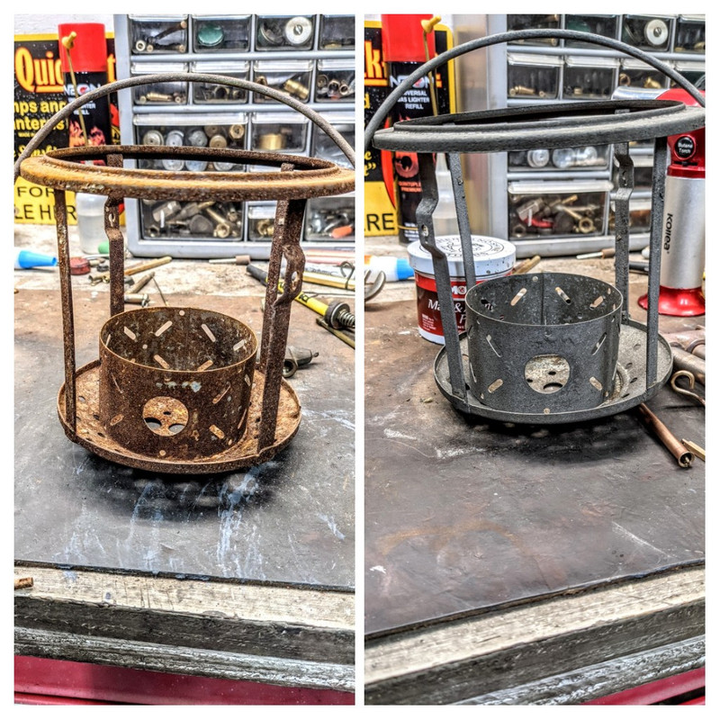

I acquired an early 220b not too long ago. Fount tested good so putting some effort into the rest of this old girl. The frame is structurally sound, but looked like it was painted brown due to rust. I put it in an electrolysis tank for about 8 hours today. Some of the thick bits of hot dipped tin actually remained! Everywhere else has that black coating that often is left from electrolysis. I have scrubbed it with a scotch pad, but just can't seem to get it all off. I have never painted a frame before, but then i have never had one with rust this bad. Any thoughts?

Electrolysis works, but is a little slow for my liking. I always go back to warm Evapo-rust...

Wpavlis wrote: Sun May 02, 2021 1:58 am That is pretty close to what i was working with. I usually use evaporust for smaller parts and will probably use it on the collar (don't need to warm it this time of year in phoenix).
I bet not 😁 the photo above was 2 1/2 hours in 140 degree Evapo-rust... My experience it would take all day or two using electrolysis with scrubbing in between sessions. I'm in a hurry and lazy too boot 😉 Citric acid is another option but is hard on the original plating as well.

Here it is after taking out of the tank. No rust. I think it would look good if it were plated, but i am going to try the rustoleum cold galvanizing compound. I will post pictures of how that looks as well.
