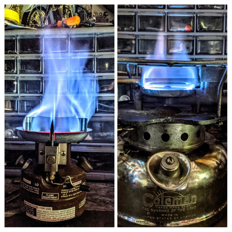

Posts: 1863
Re: 502 on high
Perhaps somebody with a good running 502 can fire it up and take some pictures, which at times can be worth a thousand words.

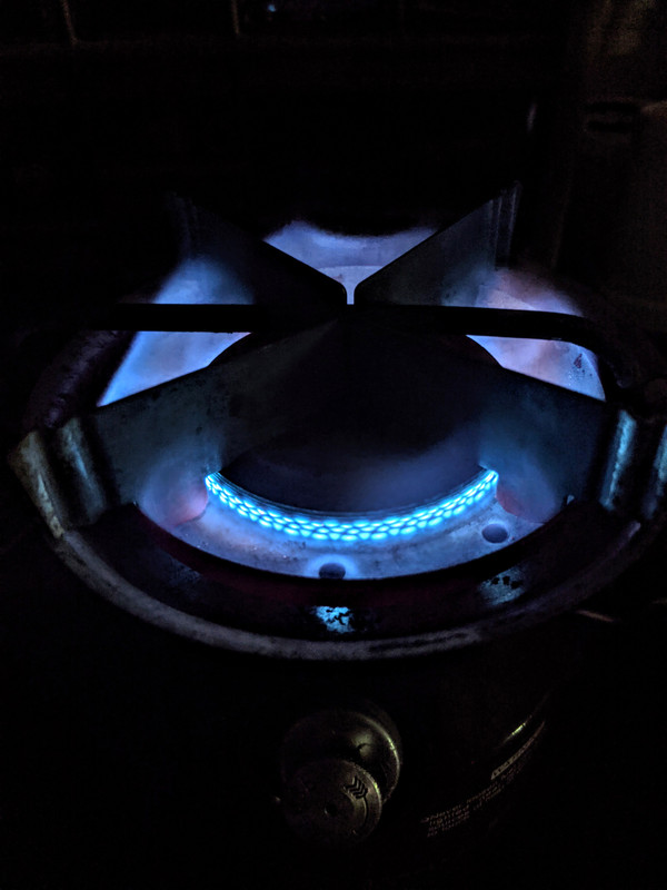

Emorr123
Posts: 300
Joined: Sat Nov 03, 2018 12:53 pm
Re: 502 on high
Post by Emorr123 »
501 flame pattern
