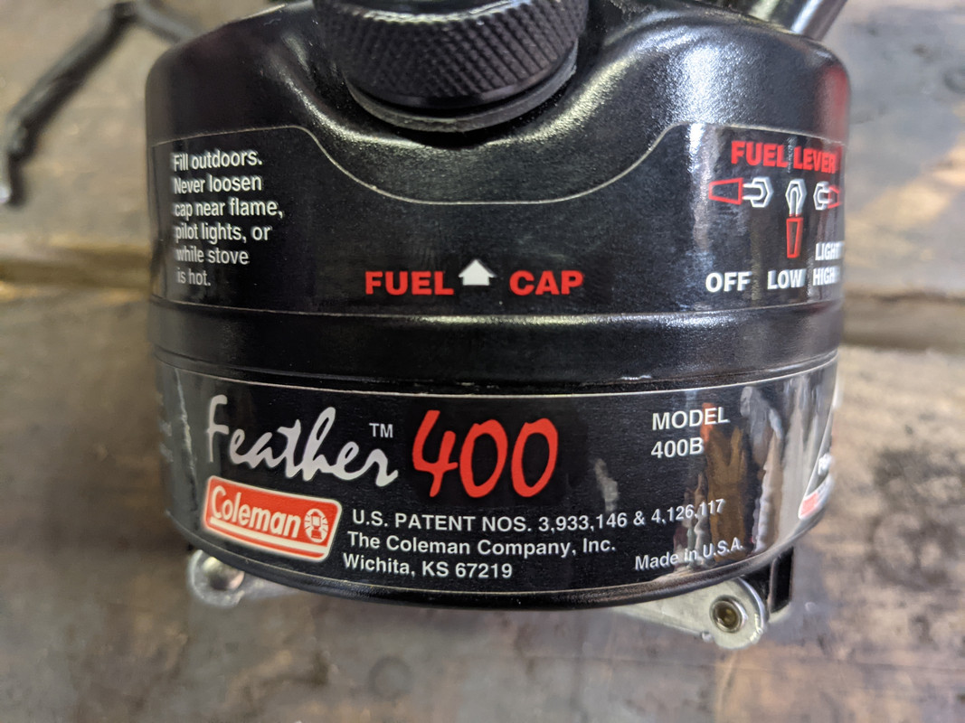

If you look closely at my Feather 400 decal just to the right of it says 400B. These do not use the early gen with the adjustment lever.

Not a typo. The feather 400, pictured by Toby in this thread, takes the later style generator. The label says real big "feather 400." The earlier Peak1 stoves (model 400/400a) take the earlier generator. The Feather 400, 442, 440, Exponent, Xcursion, Mountaineering(3024) and probably a couple other labels, take the later generator.

Thanks for the clarification, John, and my apology to Brian for introducing more confusion than necessary. For the record, I have two Peak1, Feather 400, Model 400B (400B701C) stoves, and they are the best single burner Coleman stoves I own. I hope you enjoy yours as much, Brian.
