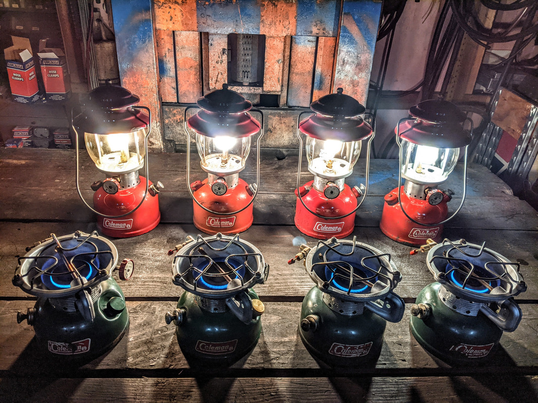

I personally use a 3 fingered spring loaded oil filter wrench and an oxygen/acetylene welding tip on my torch to pinpoint heat where I want it... Usually just a dull red on the bowl will break it free... If you think the Bunsen got too hot you can dribble a couple drops of water in there which will also help quench it free from the bowl... I've never had to heat one more than once with this method.
All 4 of these Christmas gifts had to be heated to be disassembled.
