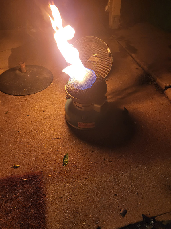

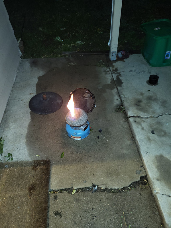

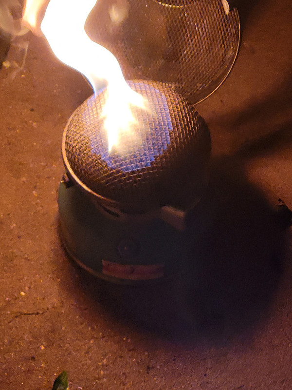

sorry I've been hoping around from project to project and think I got it working the lever that controls it isn't working but it was a pain in my a$$ but here's some pics and if you guys see anything I'm not noticing pls let me know it's kind of chili in the garage to night so I'm going to give her a test run

Did the flames die down? I’ve never used mine but I thought the flames covered the entire mushroom and were barely visible??
Posts: 9508
Re: sears blue kerosene heater
The flames will cover the dome if you have fuel all over the dome. Not the ideal startup procedure. I can't recall if the one I got as a teen said to turn it over until the wet spot was the size of a half-dollar or dollar. Regardless, once that flame goes away, you should begin to see the glow if it's running. If not, try again. If not then, use the head cleaning procedure.
