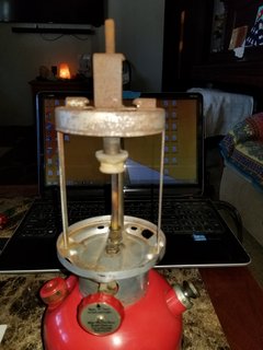

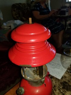

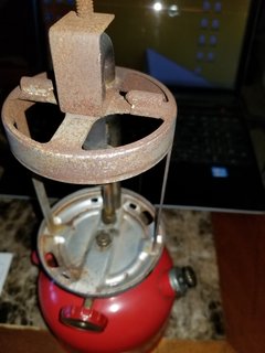

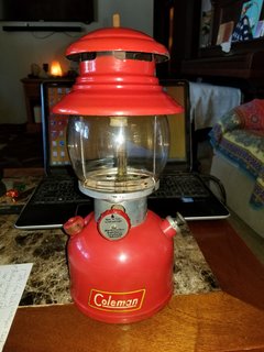

Photos of my present project (1 of 2) lanterns I'm doing, a 6/54 200A with the green logo glass. I'm about to use some car wax on the fount and was thinking perhaps using Mothers on the upper portion to clean up the cage?
Not sure if I really need to remove the burner assembly, etc., and have new mantles and fuel cap gaskets ordered. I'm pretty sure I can get it fired up without breaking it down further but, won't know for sure until I get those initial replacement parts. This 1 looks well cared for. Just a few small scuffs on the fount, and a few chips on the vent. I'm wanting to keep this 1 as original as possible.

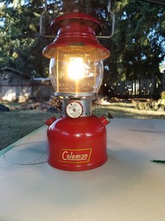

New added photo. I cleaned out the tank, rinsed well, emptied and added some alcohol to remove the water. Let it dry out, borrowed one of my fuel caps from a stove tank that fit, filled it up, and it's running beautifully and quiet.
