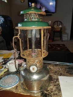

Hey guys. I have a mystery lantern to me.
Cleaned the glass which is a Coleman red letter, made in the USA.

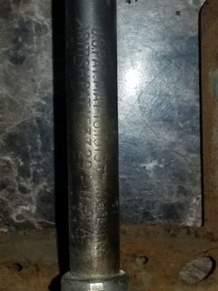

On the air tube next to the generator of this dual mantle is the following stamp: US PAT
MAY 13, 1919. Under that is BRITISH PAT 153329 USA.
No legible stamp on the bottom or side of the fount nor on the collar that I see.
The vent on top? May not be the correct one because it doesn't cover the top of the frame. Not positive that it's even the proper globe although as a red letter I'm pretty sure it has value.
It uses a screw on type pump but, it was missing when I got it.
Perhaps you can help me through this mystery? Any and all help would be greatly appreciated!
Bryan

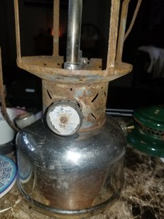

Looks like a 220B. Vent looks correct. How is the bail attached? Cotter pins, key hole slot? The key hole will only line up and allow the bail to be removed when it's hanging straight down, so the lantern has to be disassembled to remove it.

220 b. Appears to be a early one. Everything is original except the globe from what I can see. I don’t believe these were marked with a model number.

Hot_Diggity wrote: Mon Sep 12, 2022 8:23 pm Looks like a 220B. Vent looks correct. How is the bail attached? Cotter pins, key hole slot?
I wasn't even aware in checking out how the bail is attached.
They are secured with cotter pins.

31-35 220B from what I can see. Get enough rust cleaned off the button and I bet the date stamps will show up.

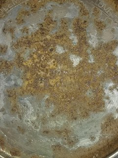

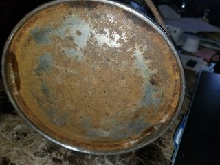

Well, look at that! We have a winner. After I saw your reply I hesitantly decided to set the bottom of the fount in a shallow tray of vinegar I have setting on the workbench.
( Still not sure if that is safe for that type of fount?)
I pulled it back out fairly quick and rubbed it lightly with a bristle brush and the Coleman stamp is appearing. I set it back in to see if I can get enough off the see a date stamp.
If I shouldn't have it in vinegar can someone shout it out before I ruin the fount?

Lye (oven cleaner) would be preferred on the nickel. I don't know if the vinegar will harm it, but it turns brass pink.

I always use spray oven cleaner. No worries about container size or waste disposal. Put a trash bag over a plastic bucket outside for a stand. Wear gloves. Let it sit 20 minutes and scrub gently with a potato brush and old tooth brush.
Rinse thoroughly. That will get you ready to polish.

Lye is great for ogranic material removal (dirt, grime, old fuel deposits). It won’t harm nickel. But it does nothing for rust.
Citric acid or acetic acid (vinegar) will dissolve rust but doesn’t do much for organic removal. These acids will dissolve the nickel plating!
Take your fount and turn it upside down and fill the bottom rim with vinegar or citric acid. Doing what you are with it sitting in a plate of vinegar will make a nice ring where the nickel disappears. You also probably don’t have the steel bottom touching the vinegar unless you removed the air pocket when you set it in there.

I edited above and added a couple photos of the bottom of the fount after a night of its vinegar soak and some brushing.
I can see a stamped date of 5/7 and most of the outer ring of writing is fairly legible. I can make out faintly the "Coleman, sunshine of the night" emblem in the center but I don't think I'll be recovering any more of that than I already have. Other than some fine steel wool, I'm running out of ideas on what else to do.
On a positive note, it still looks intact enough that it is still a usable fount but, I'll know for sure when I cross that bridge. I'll have a replacement for the pump which was missing later this week.
Any suggestions anyone?

Bryan, me personally I would use some fine 0000 steel wool on that rust, then either oil it, or use some boiled linseed oil on it... Anything to keep moist air from getting to it. Looking good so far 👍

With the wording Lamp And Stove (no &), it’s post 1934. My derusting approach if you want to go further is to use naval jelly to spot treat the heavily rusted area. The phosphoric acid slowly softens the rust and you then mechanically remove it with a flat edge. I use a curved pick. It’s labor, but depends where you want to stop.

It's got a 5 7 date clearly legible (in person anyhow) which I believe makes it a May 1937?

BryanWP wrote: Tue Sep 13, 2022 8:10 pm It's got a 5 7 date clearly legible (in person anyhow) which I believe makes it a May 1937?
That would be July 1935. I like your idea on the clear sealer.

So, that was when they were doing the reverse numbering on month year (meaning year followed by month), and year having only the last digit?

BryanWP wrote: Tue Sep 13, 2022 8:54 pm
Tgarner01 wrote: Tue Sep 13, 2022 8:19 pm
The majority of Coleman lanterns from late 1924-late 40's had single digit year stamps on the left and month stamps on the right... A few exceptions of course for reasons unbeknownst to collectors. Coleman Canada avoided the confusion with double digit year stamps from the beginning... But that's no fun 😁
