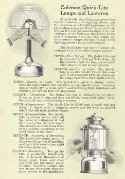

I agree that it's a white gas lantern. Aren't Quick Lites from before the advent of the instant light circuit? That means the vapor generator has to be hot before firing this lantern, correct? I can't imagine the lantern was intended to just be a gasoline fireball until the generator gets hot. So again, shouldn't there be an alcohol cup? On the other hand, things were a lot different a century ago, maybe a gasoline fireball was okay back then.

Posts: 9706
Re: Quick Lite 427 questions
M114171 wrote: Wed Sep 14, 2022 11:26 am I agree that it's a white gas lantern. Aren't Quick Lites from before the advent of the instant light circuit? That means the vapor generator has to be hot before firing this lantern, correct? I can't imagine the lantern was intended to just be a gasoline fireball until the generator gets hot. So again, shouldn't there be an alcohol cup? On the other hand, things were a lot different a century ago, maybe a gasoline fireball was okay back then.
Quicklites were designed to be match generating. At the time, this was "quick" lighting, much faster than the torch lites that predates them. Here's some illustrations and some wording if you can see it clearly describing the process.

Interesting, I thought it was only pigtail vapor generators that were intended to be pre-heated with a few kitchen matches. Please forgive me for side tracking your thread a bit, Bartholomew068. I thought all the pre-instant light lamps and lanterns, except the ones with the loop generator, had an alcohol cup for heating the generator. Had no idea that people back then had to carry a blow torch with them to get their lantern going.

I’m pretty sure this 427 would have originally had the Q99 (pig tail) generator. The R55 was introduced in the early 1930’s, but wasn’t a factory installed gen on the 427 until late 30’s. Coleman54 (Larry) has the timeline on this I believe.
