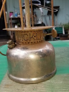

I have 2 more lanterns I'm trying to sort out that I can use your help on.

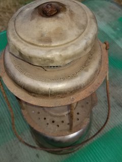

A 34-36 242A that I'm not sure about the glass, the vent, and definitely thinking the bail is incorrect. The glass in it is the green Coleman underlined with a sunrise on one side, and PYREX made in the USA on the opposite side. The fuel cap is a tiny 3 piece.

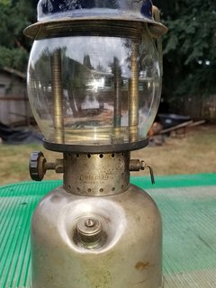

Also have an early Quick Lite that I'd like to get a better handle on the date. On the vent it is listed as "The Coleman Lamp Company".
It has a winged pump/fuel lid combined
Photos included. Just need some proper information to understand what would be needed to have them the way they were.
Bryan

It’s an AGM vent on the 242A and a 327 Quicklite. No wings on the filler plug. It has a thumbscrew.

I think you have a 327/Air-O lite and a 242 of some sort that has an AGM vent on it. Sometimes asking here is the best bet, especially when you have a mix of brands on one lantern, like the little 242/AGM hybrid.

So, it's marked as a Quicklite on the band, and a couple of you have identified it as a 327. I'm a bit confused if it's also considered an Air-O Lite. Can you help me understand the additional designation?

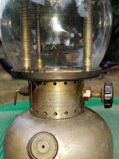

Mr. Dean isn’t quite there. The early 327 models were Air-O-Lanterns. There was a lamp model Air-O-Lite. But the Air-O-Lantern did not have Quicklite punched out in the collar.
Your 327 is in the 1922-early 1924 range. The embossed vent started in 1922. The stamping of the fount under the filler plug began in early 1924. You are somewhere between those dates. The bakelite valve wheel is a later replacement. Those began around late 1928-29. The original fiber wheels were often replaced.

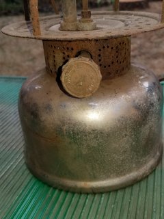

Bryan, a picture of your mixing chamber and letting us know if it's a single or double patent stamp on the air tube can really narrow down your date range. Appears to be late 23-late 24 from the features I see... The outlier being the bakelite valve wheel.

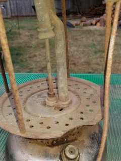

I've run into an issue in removing the vent and wonder if anyone has some insight I lack. The nut was rusted to the steel bolt on top but, a few rounds of the heat/quench method overcame that quickly.
My issue is now that although the vent turns freely there is what appears to be a washer on top that doesn't seem to touch the bolt but, it does not turn with the vent, nor does it come right off like a normal washer.
Is there something to the design of this that I'm unaware of?
Has anyone else removed the vent on one of these that understands what I'm running into?

Yes this is very common. When the globe/mica is already off the lantern like yours, I just remove the burner, vent and all from the lantern. Then it's easier to work with. What has happened is the vent bushing has wedged itself onto the rusted vent stud. A good penetrating oil will help, but once the burner is off the lantern you can more easily tap it from beneath.

And I’d recommend you remove the generator first before you try to spin the burner assembly off. Looks like a Q77 gen that could be centered in the burner, but don’t risk tweaking it.

Vent and bail are off of an AGM. Could be a 3606, 3608, or 100 model. All three had that small blue vent.
