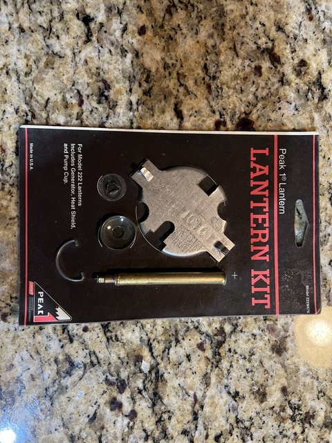

I have 3 226 lanterns and one is missing the heat shield so when this kit popped up BIN for very cheap I jumped on it. The shield looks identical to the ones on the 226’s, so my question is about the generator that came with it. If I remember correctly one of these gens is difficult to find. Maybe this one?,but that you can use the newer version generators on it? Does that sound correct? So can you use a 222(this generator) on the newer 226 lanterns? Thanks!!

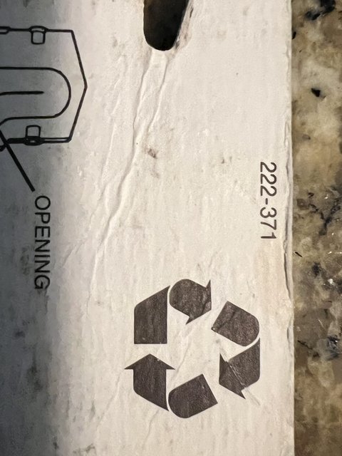

Can you list the part number for us? I can read it in the photo. I think it is in the upper right corner. Or could be on the back near a barcode.

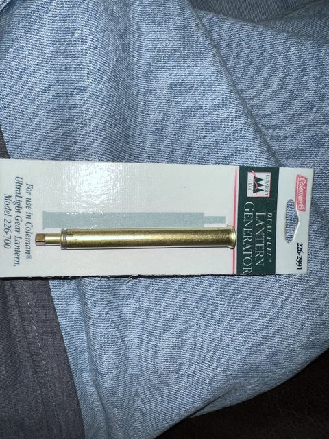

Is that the fat generator or the slim one?? Hard to see in the package. Gonna have to grab my 226 and 222 and look now...

Great score. I have found a few of the carded generators, but I have not seen that kit. I'd actually be tempted to keep it as is due to the scarcity of the kit itself. If all you need is the generator for your lantern and are considering opening the package for just the generator, I'd be interested in trading you a NOS, unopened 222 carded generator for that one. I can throw in some goodies to make it worth your wild. No pressure, just a consideration.

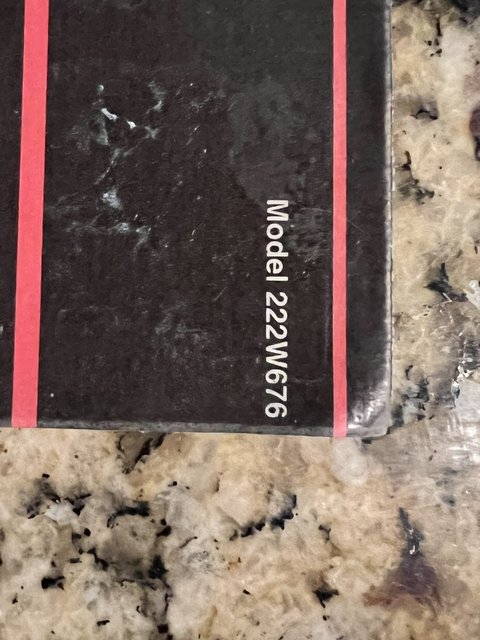

Phredd wrote: Thu Sep 15, 2022 3:40 pm Can you list the part number for us? I can read it in the photo. I think it is in the upper right corner. Or could be on the back near a barcode.
Thanks
I don’t see a”part#” listed directly but I see these numbers. Let me know if the pics don’t work for you.

Majicwrench wrote: Thu Sep 15, 2022 4:08 pm Is that the fat generator or the slim one?? Hard to see in the package. Gonna have to grab my 226 and 222 and look now...
The only mini’s I have are the 226s. Holding the package up to my lantern the gen in this packet appears to be the slimmer one. I assume that 226 is dual fuel and this one is intended for camp fuel only?

Rfieldbuilds wrote: Thu Sep 15, 2022 5:05 pm Great score. I have found a few of the carded generators, but I have not seen that kit. I'd actually be tempted to keep it as is due to the scarcity of the kit itself. If all you need is the generator for your lantern and are considering opening the package for just the generator, I'd be interested in trading you a NOS, unopened 222 carded generator for that one. I can throw in some goodies to make it worth your wild. No pressure, just a consideration.
Randy, actually the part I was initially interested in is the heat shield as one of my lanterns was missing it when I bought it. One of my reason for starting this thread was me wondering if I should even open this package “kit” just for the shield. I doubt many of these lanterns have become parts lanterns so finding a heat shield may be difficult. I may just sit on it unopened and look for another shield and if that falls through just go from there. If I need to run the lantern I can just borrow one from another 226 as I doubt I would have a need to run all 3 at the same time. I just like to have things complete.

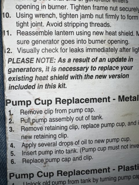

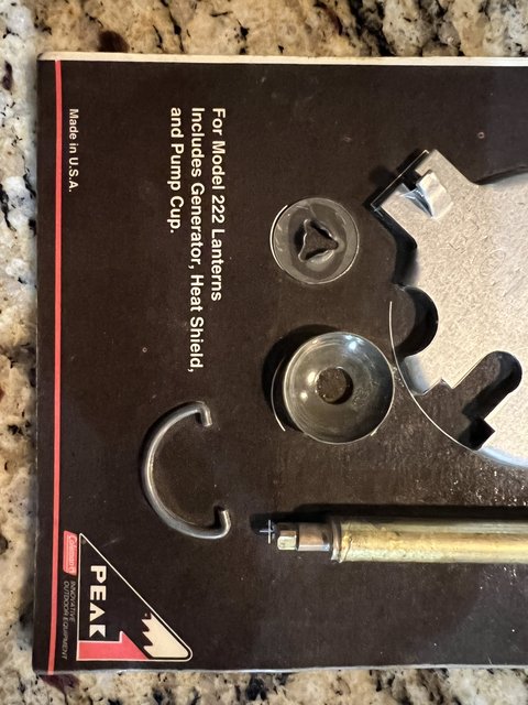

Does the generator in that kit have a dimple about a half inch or so from the flared end? If so, it is the 226 generator and not the 222. That and the 222 generators taper down in size just a bit above the nut. I doubt that they would have bothered including a new heat shield if it is a 222 generator.

BusyB wrote: Thu Sep 15, 2022 10:22 pm Does the generator in that kit have a dimple about a half inch or so from the flared end? If so, it is the 226 generator and not the 222. That and the 222 generators taper down in size just a bit above the nut. I doubt that they would have bothered including a new heat shield if it is a 222 generator.
I don’t see any dimple on the gen but it’s labeled for a 222. The package says peak1 on it and don’t believe the 226s and 229s were designated as part of the peak lineup.
Posts: 9508
Re: Mini lantern 222 gen question.
Jason,
My 229 is referenced as a Peak 1 on the box. I didn't pull the lantern itself out of the box. This lantern annoys me so with the seemingly incessant pumping required that I don't even want to look at it.
BusyB,
I doubt there's any mistaking the 222 gen for a 226 or 229 regardless of a dimple. The 222 is the desirable generator with the smaller tip orifice, allowing the lantern to run more than maybe 20 minutes between pumpings. I believe Coleman discontinued the 222 generator long before they discontinued the 226 and 229 generators.

Just looked at my 222B, has a much skinnier generator that the one in package. And dug out a 222 Canadian generator in package, it too is skinny. My 226 has a generator that looks like the one in the OP's package.
Busy B has a good point, why would they include a new heat shield, unless it was to fit the fatter, 226 style generator.
All that said, it still could have the smaller tip I suppose!

Hmm, interesting! I don’t have a a 222 lantern or a known original 222 gen but sidexside with a 226 generator they do look the same. I now see what busy b was saying. This is probably a replacement kit in substitution for the discontinued 222 gen.
I figured the difference was slight but I would like to see a pic of a 222 generator if someone has one handy.
