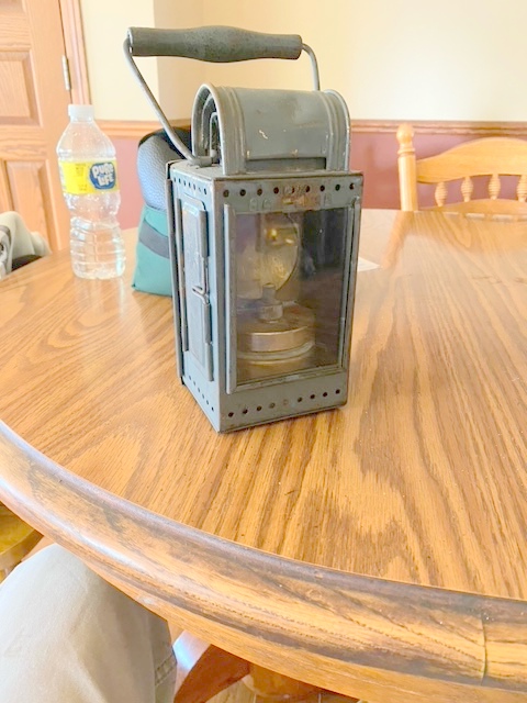

The first photo.
Tyler

Re: Carbide lantern
Post by Farmer Brown »
the second photo
Tyler

Does that have a screen flashguard? I can't tell from the pics.

It appears that your German carbide lantern is much different that the common mining and spelunking carbide lamps compared to here. I enlarged your photo, and that lamp seems to be more like the early kerosene bicycle lamps, where you had a flame with a reflector behind.
I think your flame you described is probably what it was supposed to be, like a candle with a reflector perpendicular to the flame.
The mining lamps are more like a mini blow torch coming from the center of the reflector.
Farmer Brown
Posts: 139
Joined: Fri Oct 30, 2020 3:47 am
Re: Carbide lantern
That’s about how it burned Bob. It also has a blue and red side if you open the spring latches. I originally bought it just because it was a different-interesting source of fuel.
