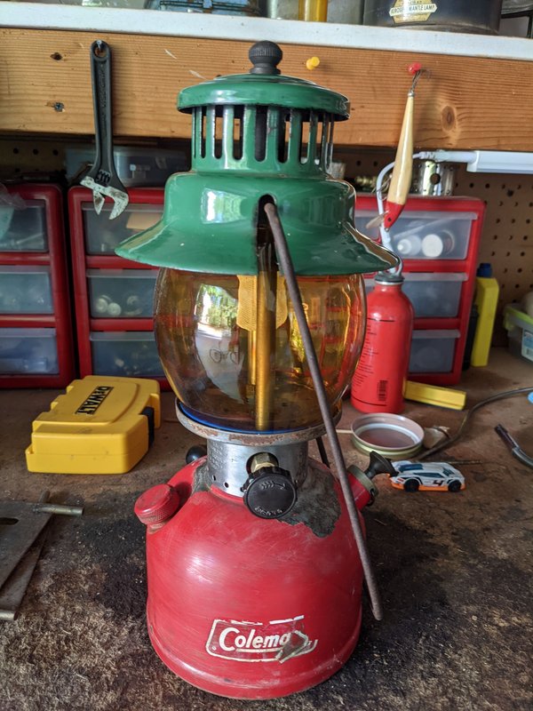

You'll want to keep the 242b collar. Otherwise, it's plug-and-play. An improvement, IMO (full size fill neck, extra capacity). Here's mine; an early 242c on a '76 200A, with Ash Flash vent. My favorite user single. I call it my US 242D.
