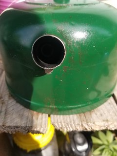

Has anyone run into a fount with a pump tube so corroded that even after removing the corrosion the resulting pitting in the tube damages the leather pump cup when trying to pump up the fount?
Smeone has to have run into this before so, I'm asking is there some way to work around it to correct the issue, or is the fount garbage as a result and needs to be replaced?
Any ideas?
Is it possible to reline the pump tube so it is smooth to salvage the fount?
I may be grasping at straws but an old fount saved is an old fount back in action, right?

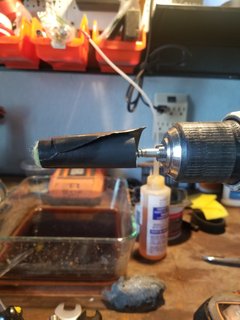

I didn't want to invest it the honing tool at the moment, nor did I have any wooden dowels laying around.
My make do for the moment was a search for a long enough bolt laying around which I cut the head off of.
Then wrapped with scrub pad material surrounded with some 1000 grit wet/dry finishing sandpaper and a squirt of chain and cable lubricant .
Much better than it was!

Okay. Decided to do a sort of reverse test, and poured water into the pump tube itself.
YIKES! I could eventually fill the tank through the tube itself. Kept draining into the tank until only leaving about 1/2" of water in the bottom of the tube. Never could visually see a hole though. Just lots of air bubbles as it went through the side of the pump tube somewhere.
Now I see how collectors end up with numerous parts. :D
Looks like I'll be fountless on my 1955 220 E but, I gained some great experience that I'll be applying in the future!

You should be able to smooth out the tube inside with a gizmo similar to the below us a dowel, scrub pad and wet auto body sand paper. A smooth tube should not be tearing up leather pump cups.

Used this brake cylinder hone on the one rusty pump tube I have come across. Won't remove pitting but will get cylinder walls smooth. Should be able make a workable tool with sandpaper a dowel. With smooth walls should not have problem.

I’ve also used the sandpaper and dowel if you don’t have a brake hone. However I’d make sure the pump tube isn’t rusted through by doing a dunk test before putting a lot of effort into it.

I have used a brake hone like Daryl is showing with good results. Brought both lanterns back to life that I used it on. I have a 200a Christmas on the bench now that is going to get this treatment.

Sorry to hear about your fount Bryan. Not much that can be done with that without doing advanced restoration. I do wonder if one could install a permanent pump tube sleeve with JB Weld or something as a sealer. I've seen founts where the tube was completely replaced, but that requires a repaint and lots of work. I'm sure somebody has sleeved a pump tube. Fortunately on a 220 it's easy enough to find a nice fount. Maybe one with a complete lantern attached. That's how we end up with so many spares.

I haven't tossed the faulty fount so, I may try to make a insert sleeve just to try out the theory. If successful maybe we can add that to the list of ways to bring it back to life? :D
