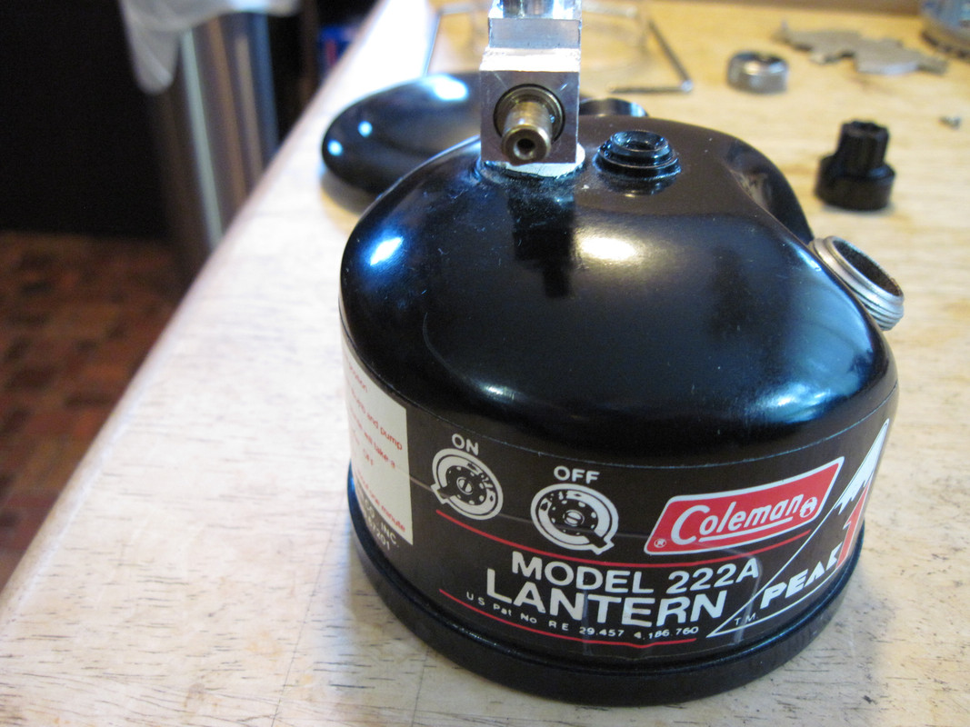

I was lucky enough to pick up this lantern, a week or so ago. Even though it appears to be almost in like new condition, it was manufactured in January, 1987! That's almost 37 years ago. Since we're all pretty much aware of the high failure rate of o-rings, I decided to disassemble this, inspect & clean it and replace the two o-rings. So, while I was at it, I thought that I'd break my 7-year hiatus and come out with another one of my (useful - exciting - useless - boring -- pick the adjective of your choice) tutorials! We'll call this one (of course, what else?), Project 222A!

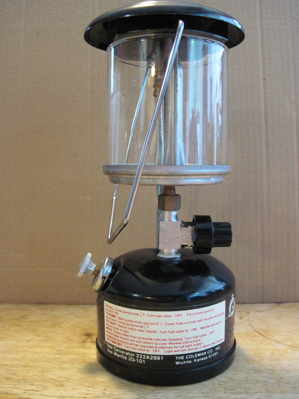

Here is the subject as I received it, in really great shape for its age:

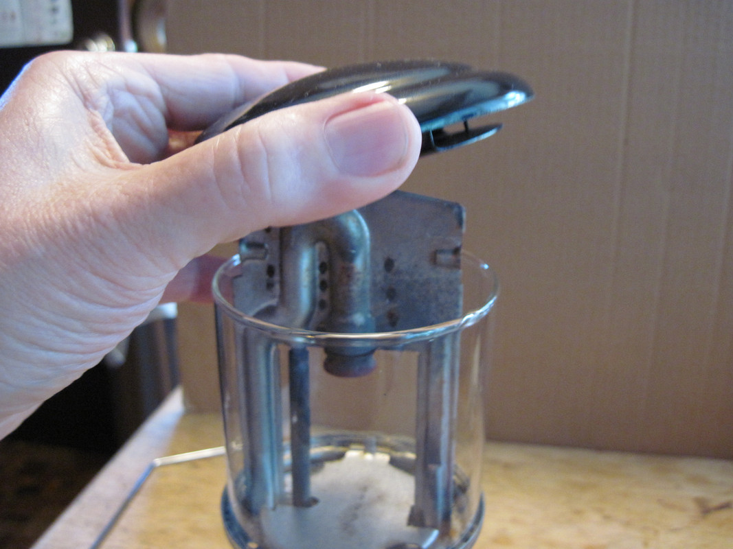

Lift off the vent.

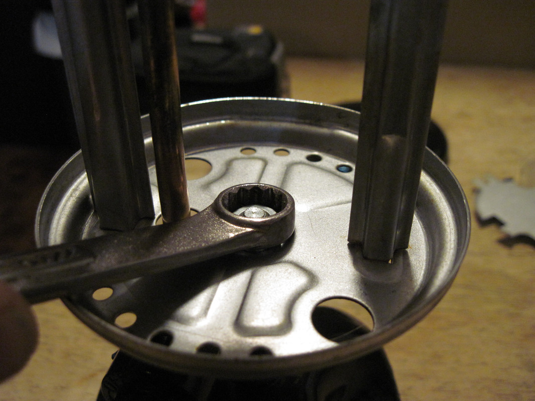

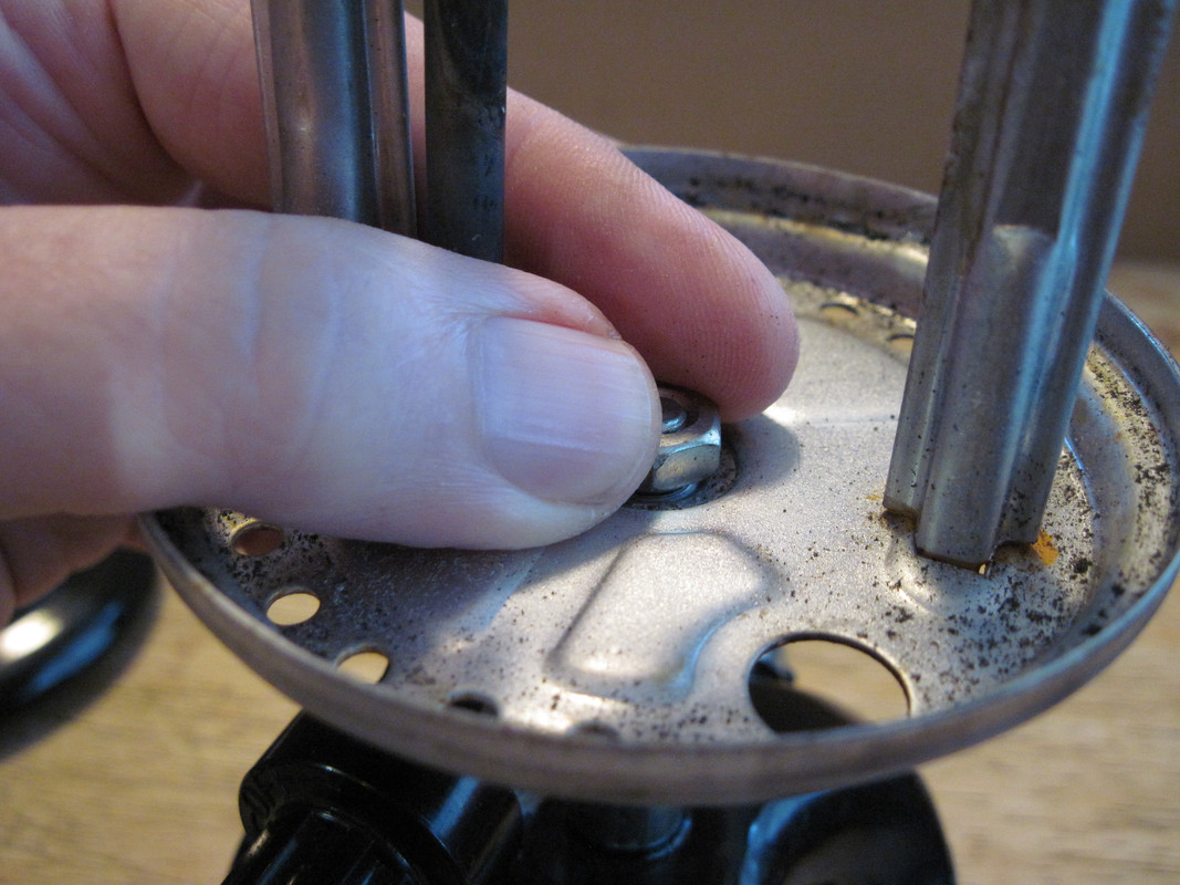

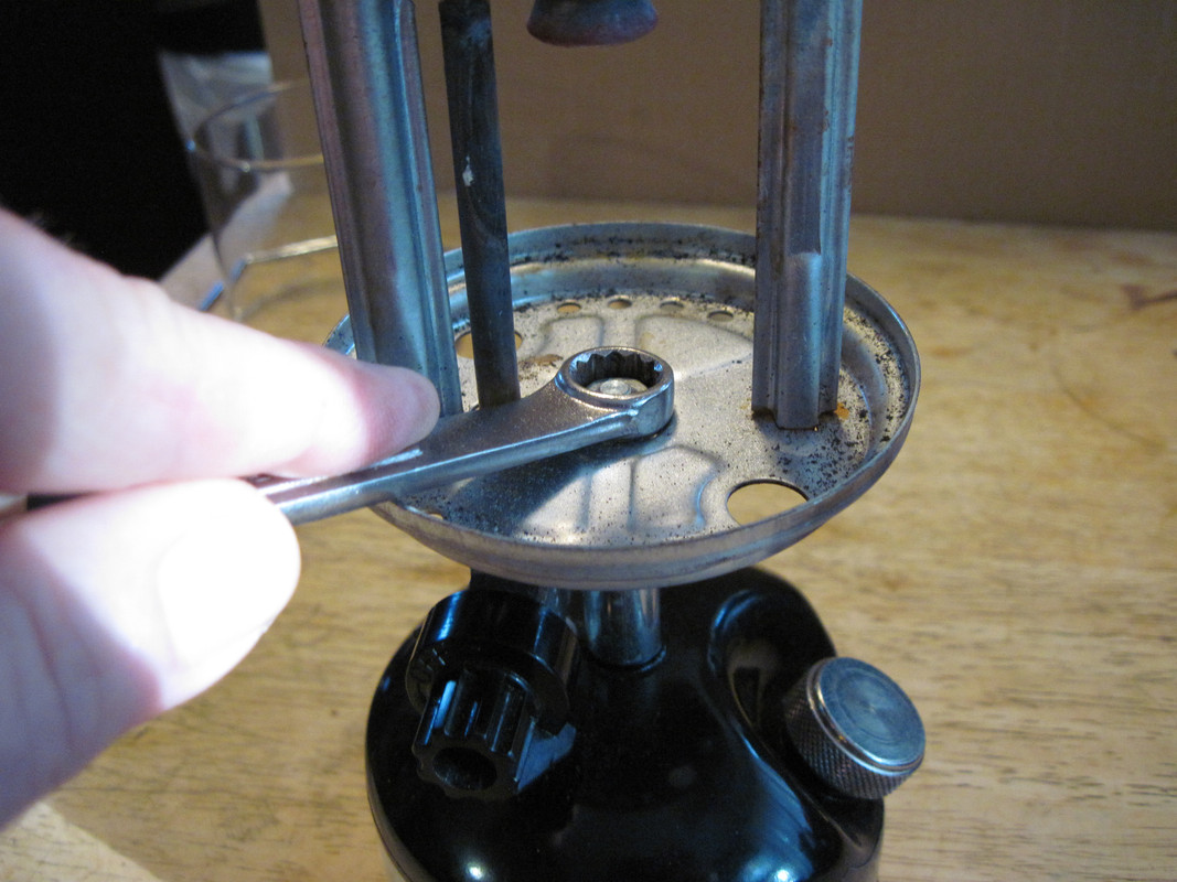

Loosen and remove the frame nut.
Lift the frame off.

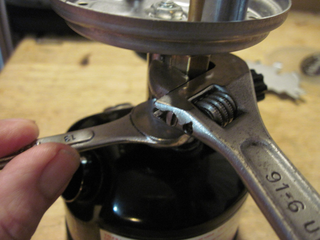

Loosen the generator nut and remove it.

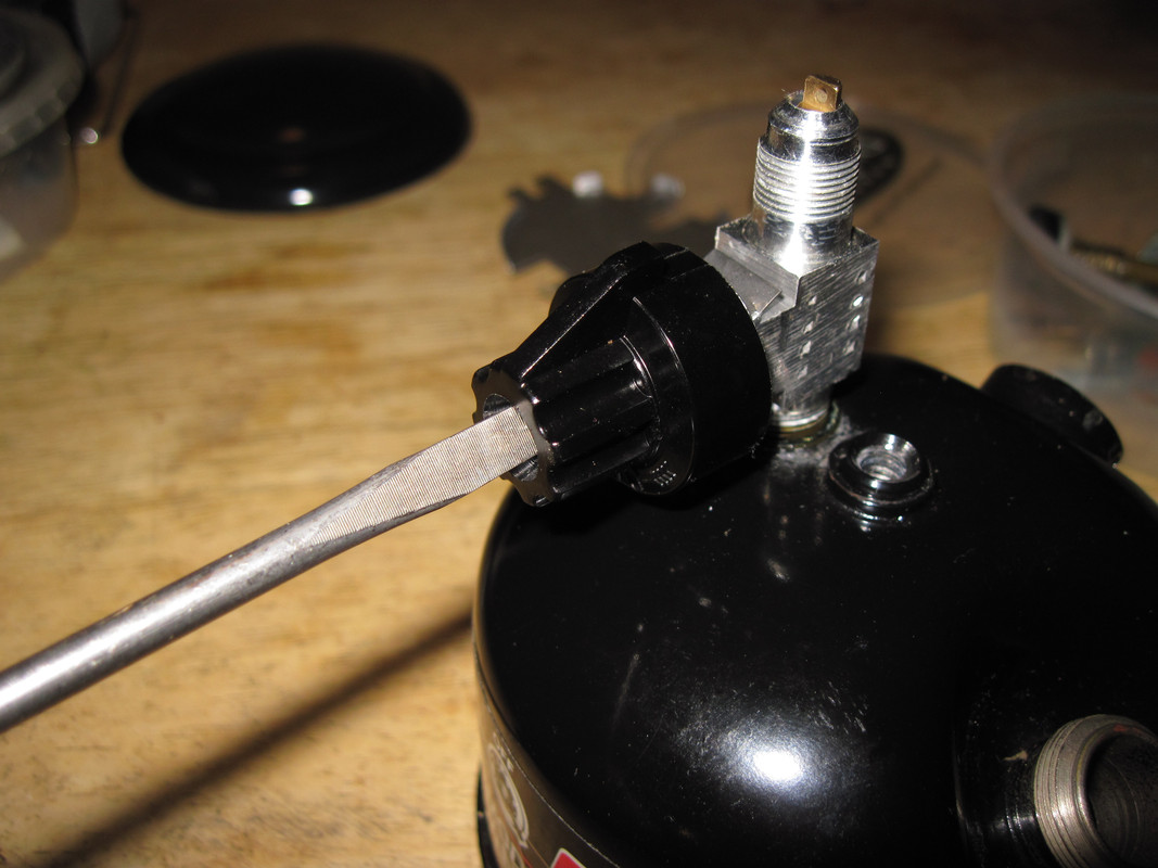

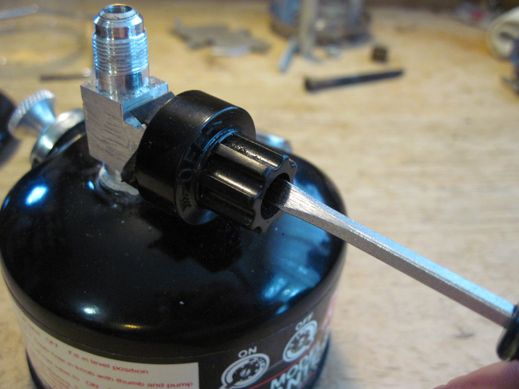

Loosen the knob screw and remove the knob.

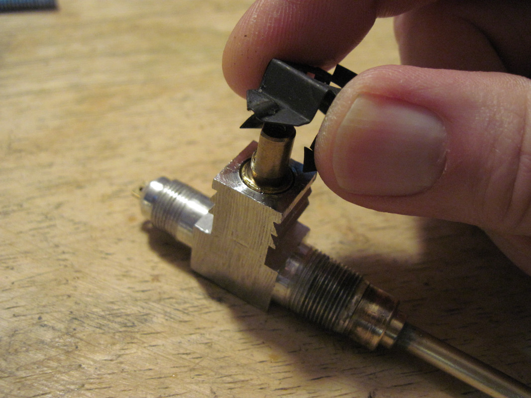

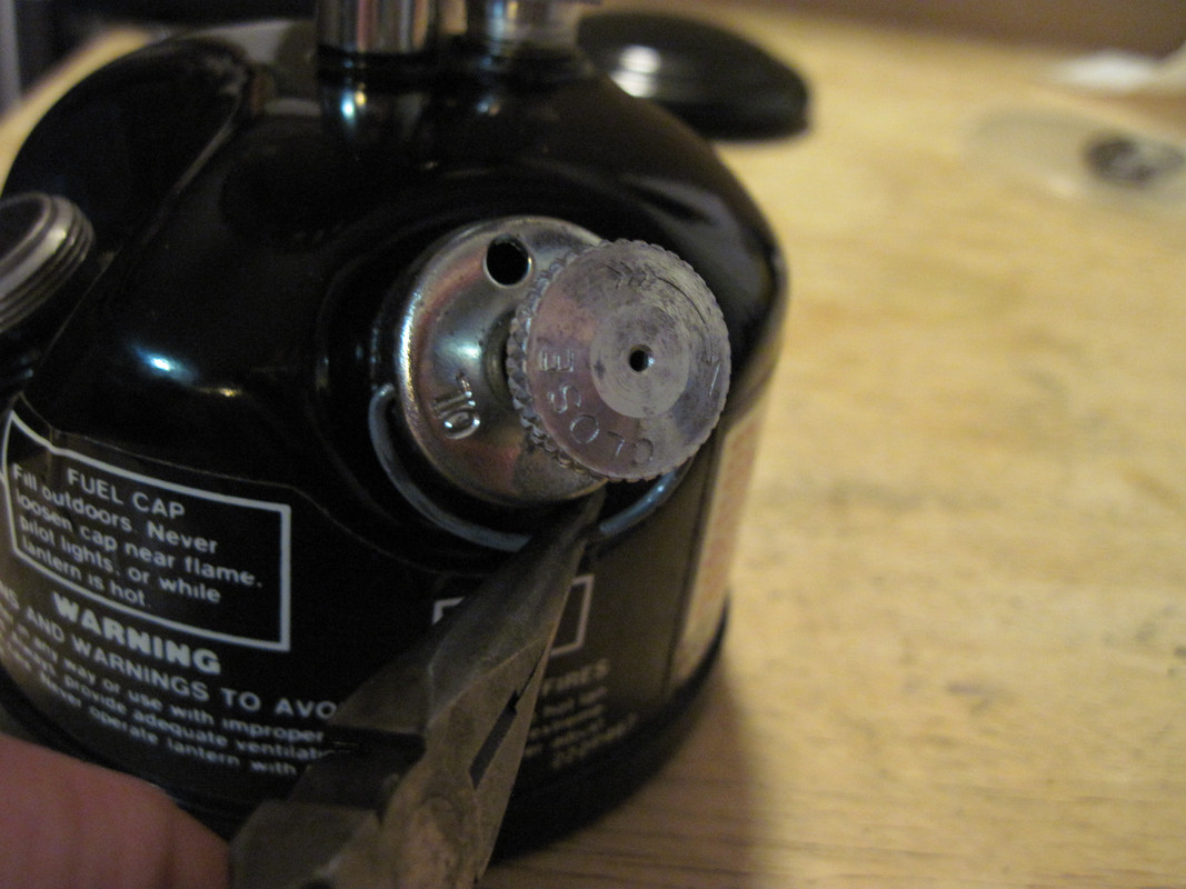

Remove the valve stem retaining clip, working from top to bottom - one step at a time.

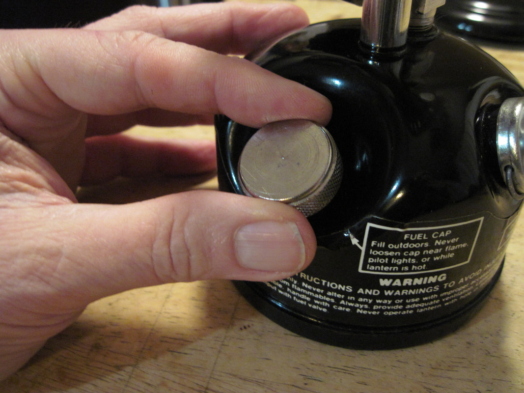

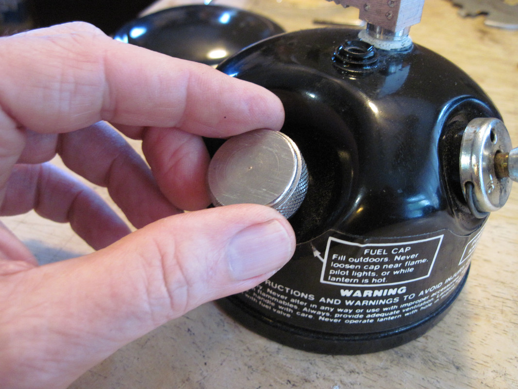

Removing the fuel cap.

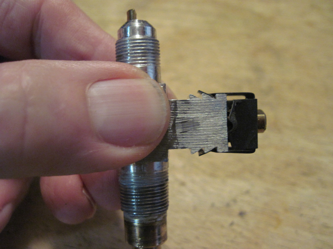

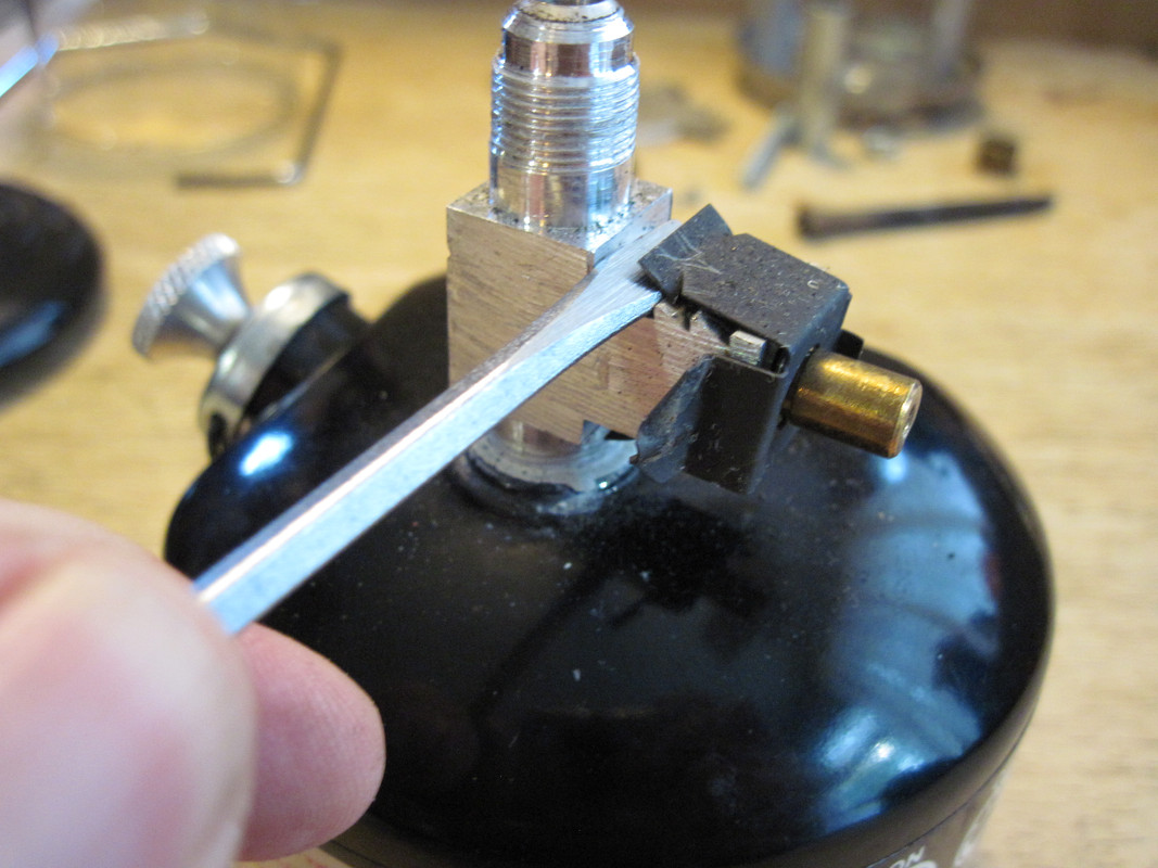

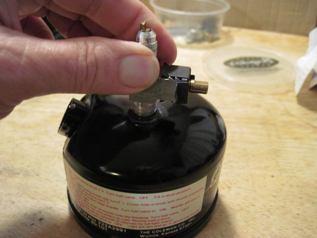

I took these next two photos in order to illustrate the correct clocking of the valve:

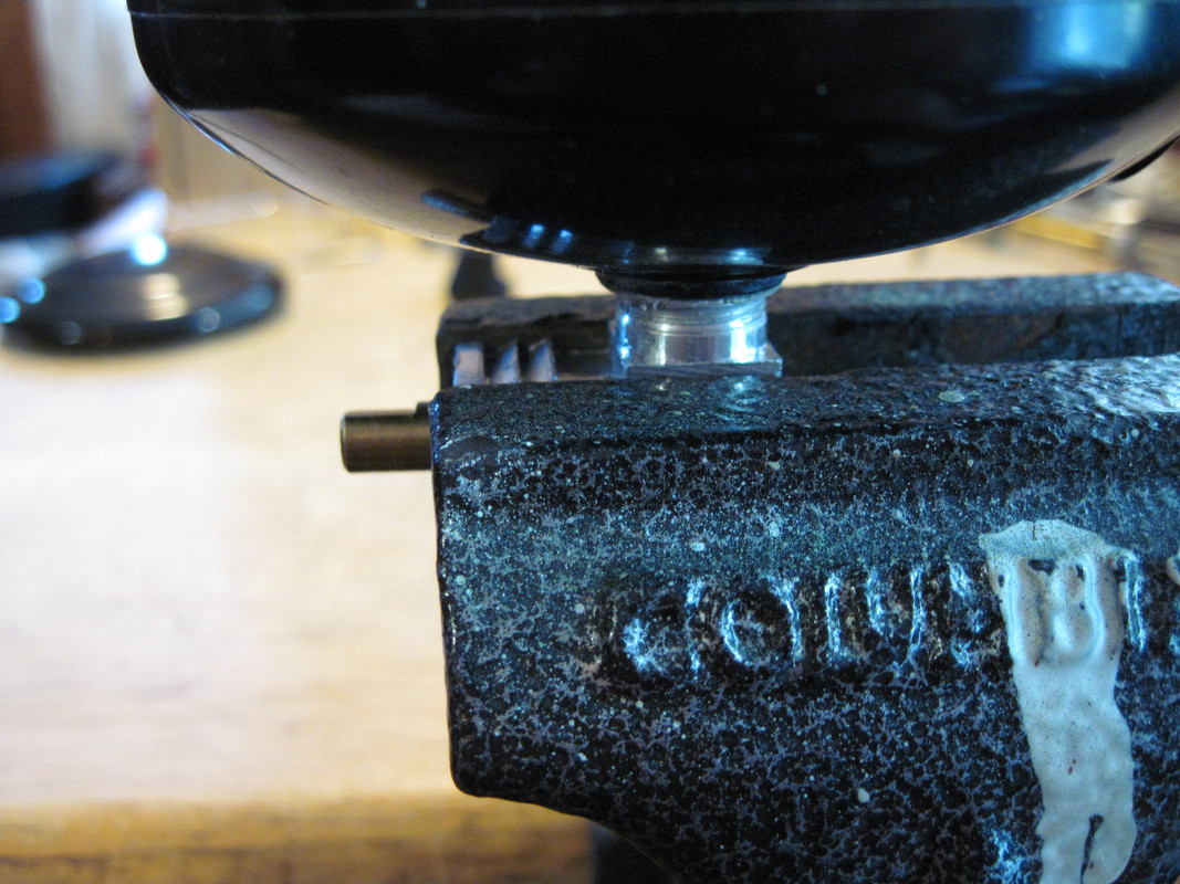

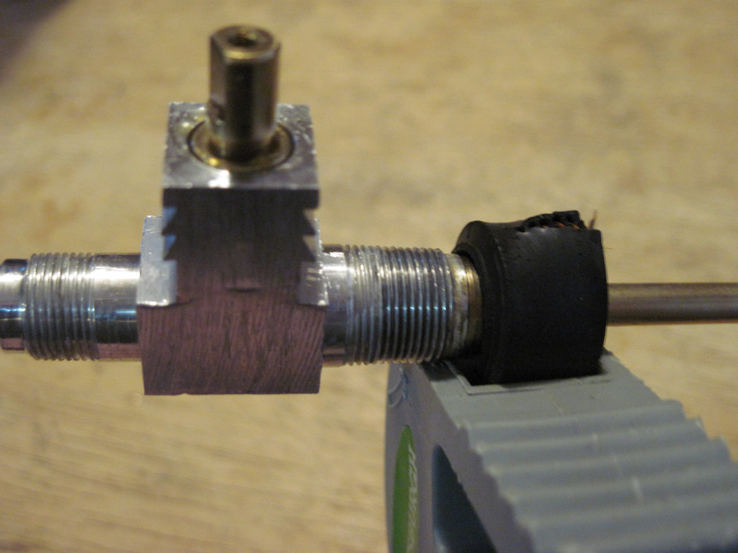

Carefully clamp the valve in a vice. VERY LIGHTLY!!! Just enough to hold it - no tighter! This valve body is aluminum and is incredibly easy to distort and bend!

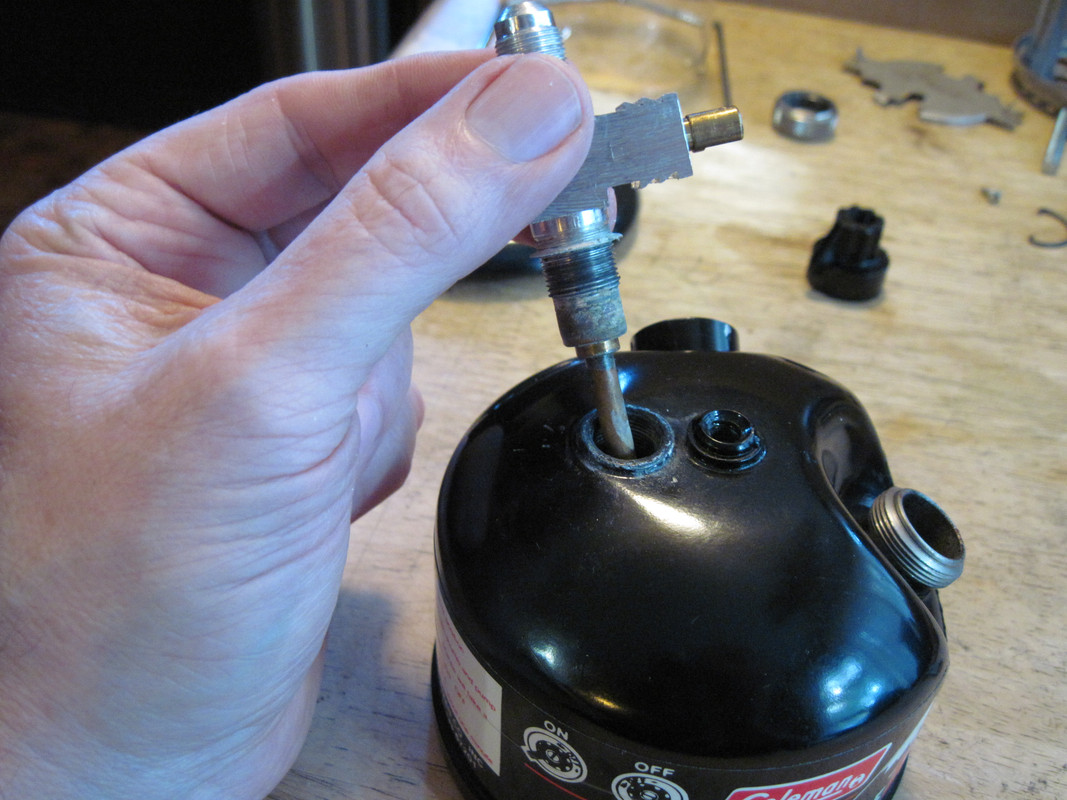

Firmly grab the fount and turn counter-clockwise to loosen the valve. Then remove the valve by hand - counting the exact number of turns it takes until the valve comes out. You'll need this later when you reinstall the valve!

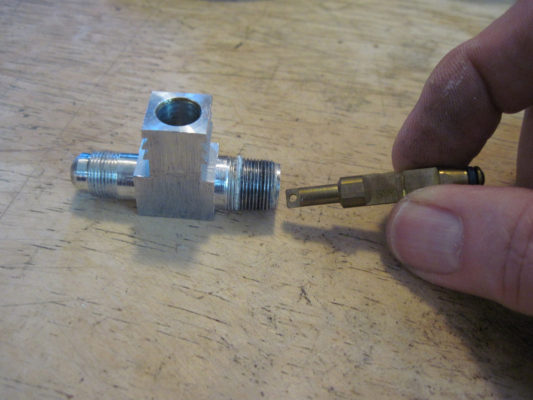

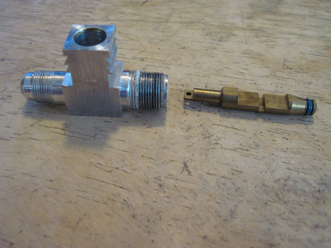

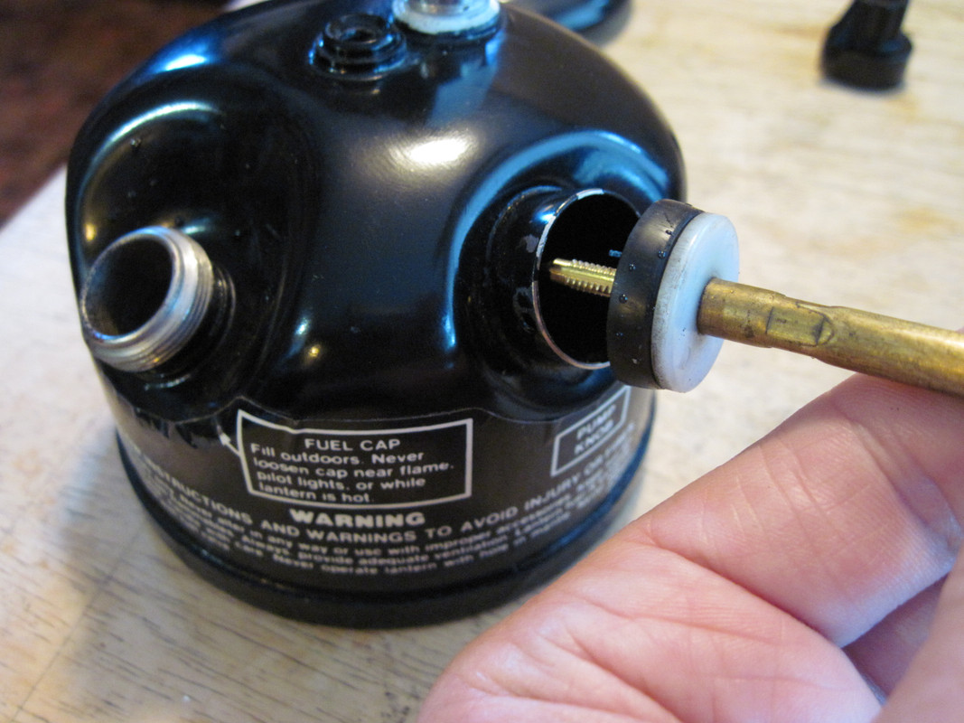

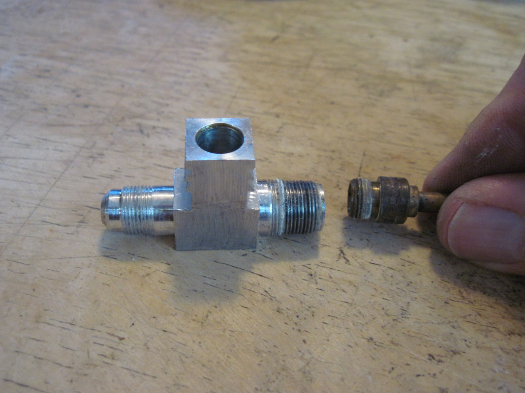

Remove the valve stem by twisting back & forth as you pull it outward.

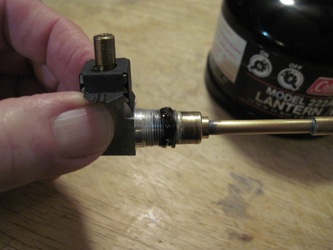

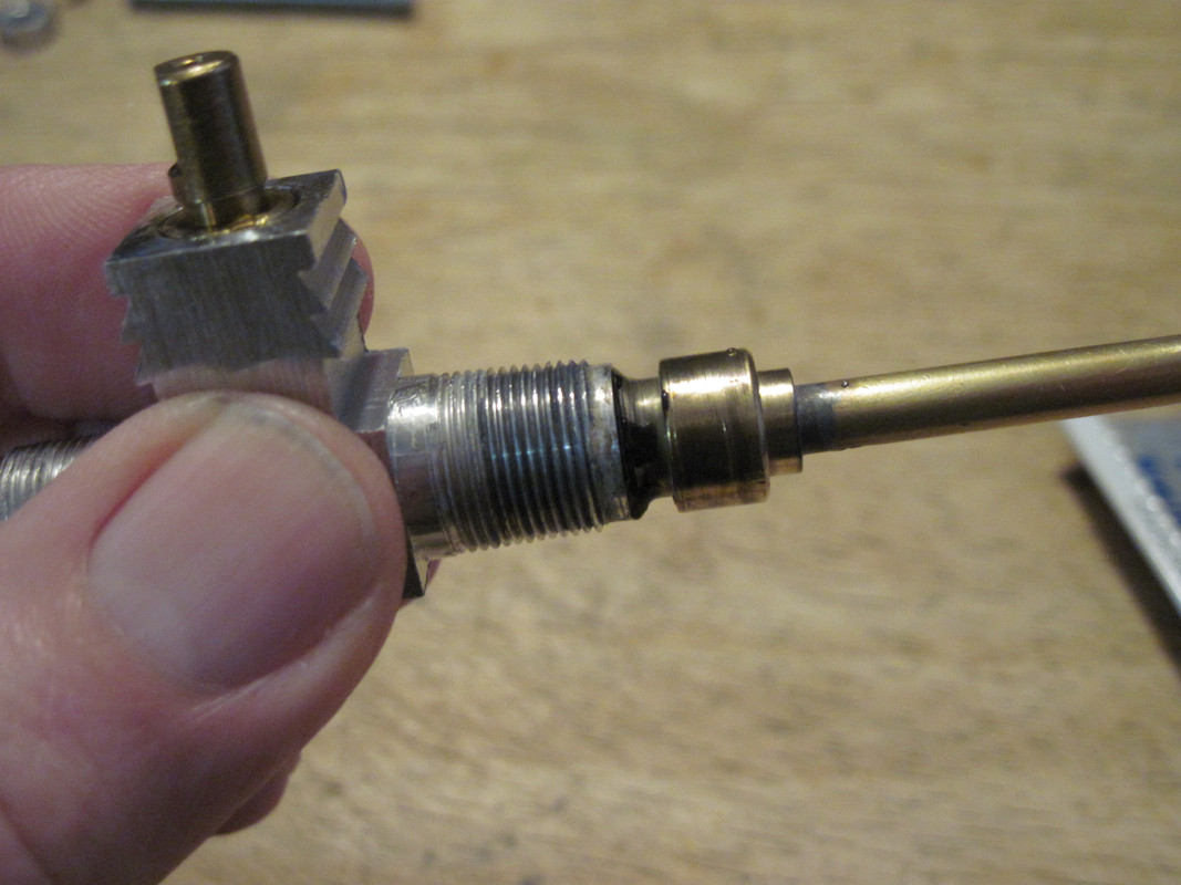

Now, unscrew the F/A tube from the valve. I tried using my strap wrench, but it was on far too tight for that. I used my vice-grips and a piece of leather wrapped around the tube to prevent marring, as shown. When loose, unscrew the tube by hand,

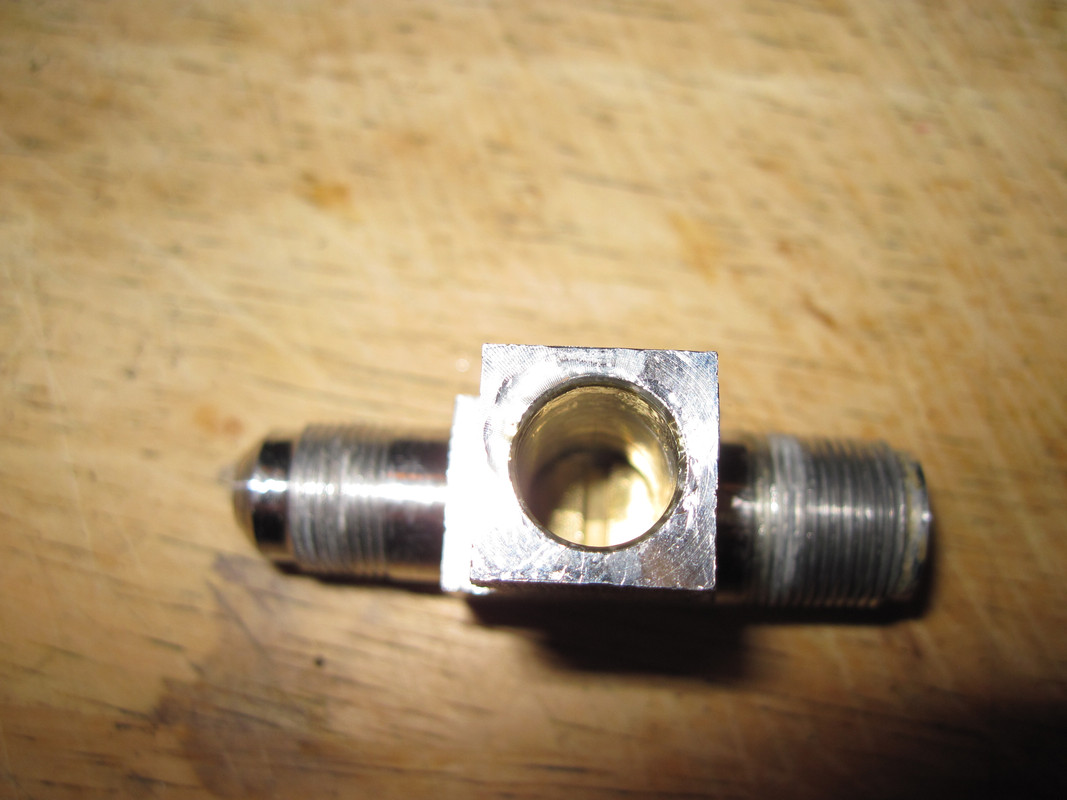

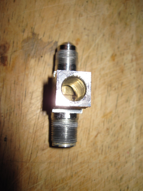

Now, remove the eccentric block.

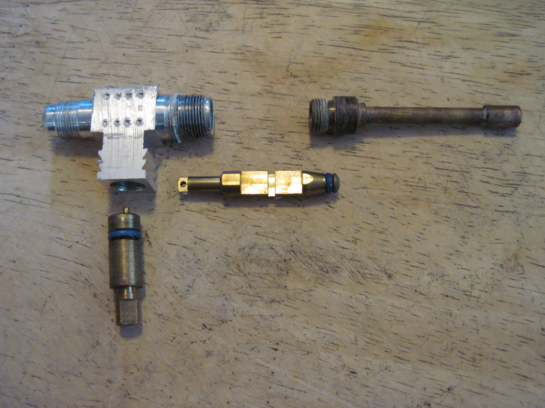

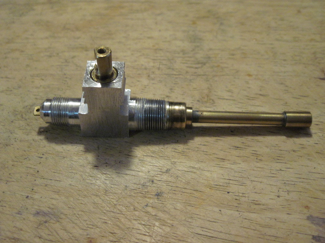

The disassembled valve...

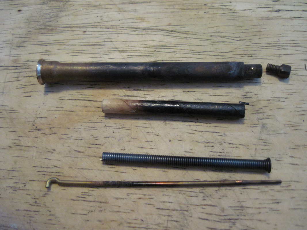

Here is the generator, disassembled...

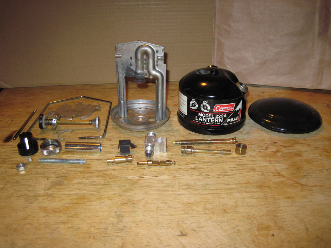

Here is the entire lantern disassembled and after a good cleaning.

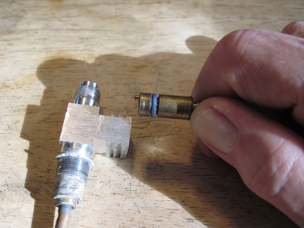

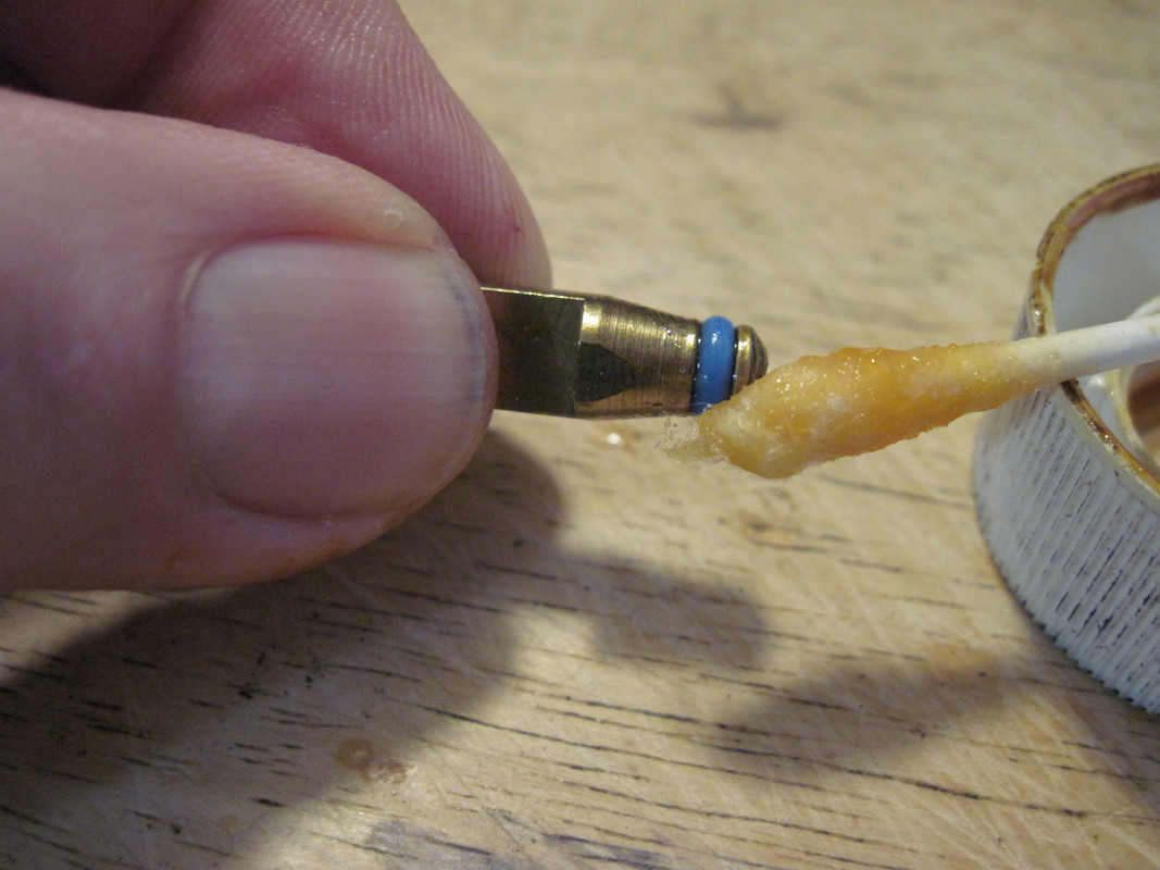

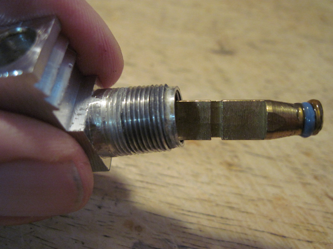

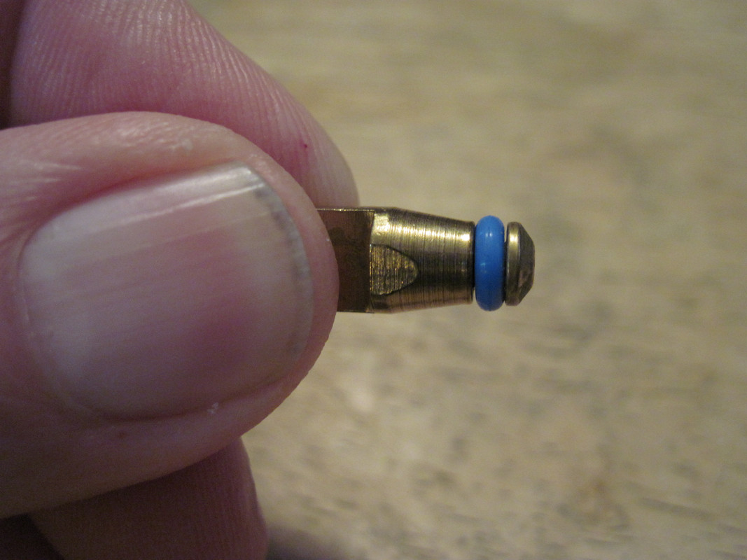

Here are the new o-rings below the old ones.
The o-rings installed on the eccentric block and the valve stem, respectively.
Applying a little hi-temp silicone lube to the o-rings...
Insert the eccentric block into the valve body, aligning the flat portion with the valve stem hole as shown. Center the slot on the block in the hole, also as shown.
Insert the valve stem by gently twisting, while pushing in slowly. Ensure that the pin of the stem enters the slot of the block. You'll know this by two ways:
1) The stem will be flush with the valve body, as shown -AND-
2) Turning the valve stem will cause the eccentric block to move up and down

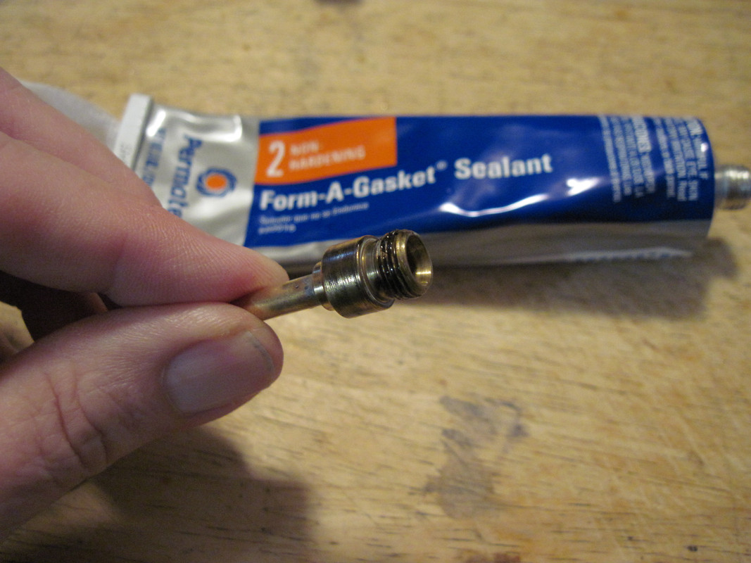

Apply thread sealer to the F/A tube threads, screw it into the valve body and tighten...

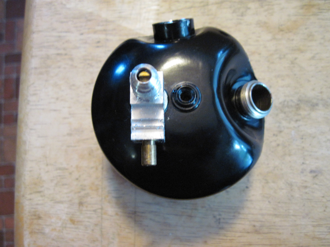

The assembled valve body...
Now, install the retaining clip, one step at a time, until it is fully seated.
Apply thread sealer to the valve body threads and screw it into the fount. Tighten it the same number of turns that you counted when you removed it!

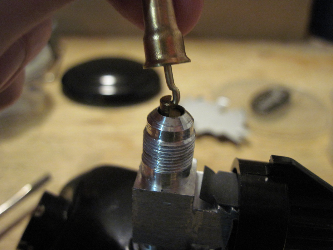

Turn the valve knob to the 12 o'clock (up) position. Hook the generator's cleaning rod into the eccentric block, as shown.
Lower the generator to the valve body flange, then install the generator nut (lightly finger-tight only).

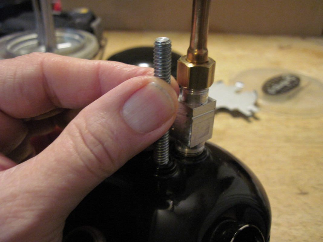

Install the stud...

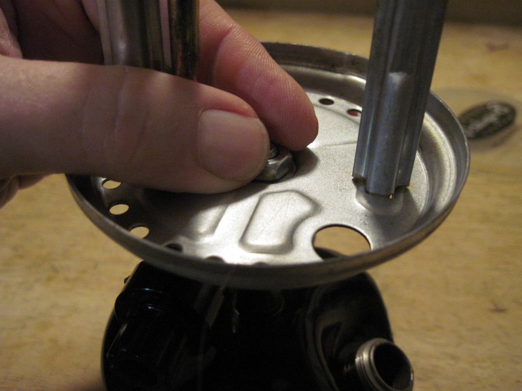

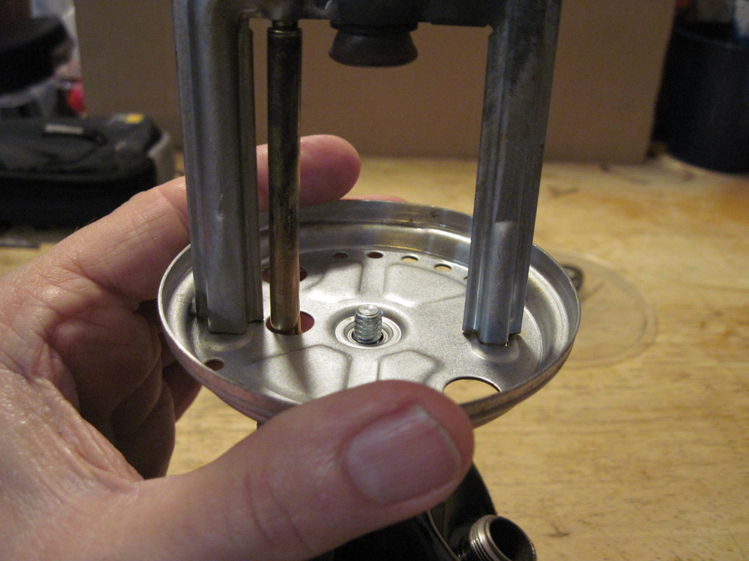

Lower the burner assembly on the stud, making sure that the generator enters the hole in the upper part of the frame.

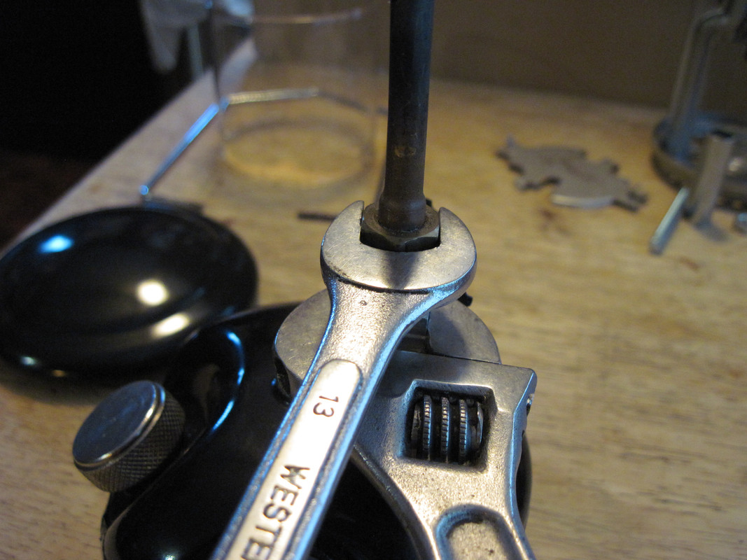

Install & tighten the nut.
Finish tightening the generator nut.

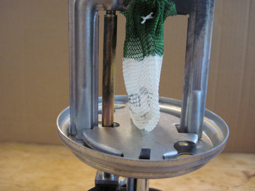

We're in the home stretch. Tie on a new mantle...
...and burn it in.

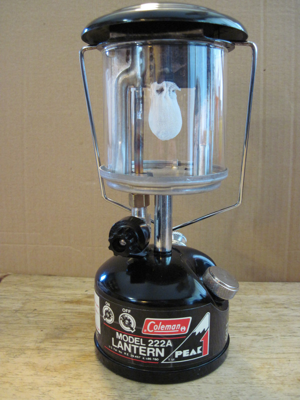

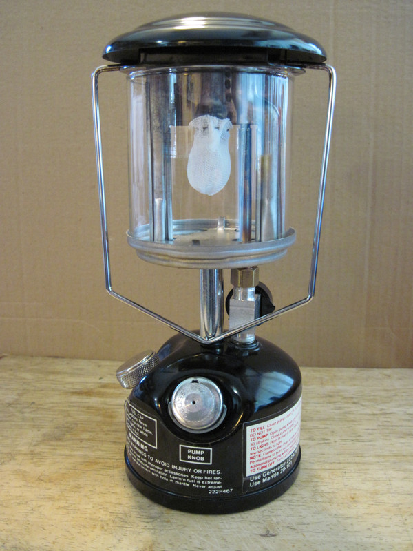

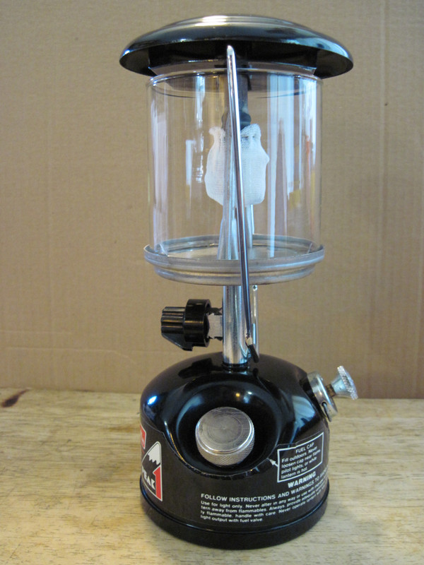

She's complete!
A mini-Sunshine of the Night!
