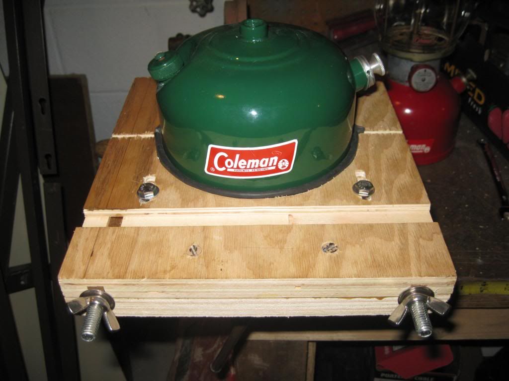

Supply list:
⅝” [16mm] plywood, 10½” x 8 or 9”, x 2 [205mm x 270mm]
2 - 12” x ⅜” threaded rods [300mm x 8mm(?)]
2 - ⅜” wing nuts [sized to fit threaded rod]
2 - ⅜” nuts [sized to fit threaded rod]
6 - ⅜” washers [sized to fit threaded rod]
2 - 2” x ¼” bolts [50mm x 6mm?]
2 - ¼” threaded inserts
1½” wood screws [40mm?]
This assumes you have some woodworking skills. I didn’t take pictures until I was finished, so I'm hoping that between the description and the photos you'll get the idea. Sorry to the non-United Statesians out there, I use nothing but the metric system at school, but at home, I measure as Home Depot does. [I've tried to add metric conversions, but I'm not familiar with the hardware that is available in other countries. I'm sure you'll be able to improvise.]
I started with ⅝” [16mm] Baltic birch and cut two identical pieces about 10½” x 8”. I planned to go wider, but forgot and had to make it a little tighter. No big deal, really.
On the table saw, I set up a ⅜” dado and cut slots, 3/16” deep, lengthwise, centered about ½” from the edge of both pieces. This makes a channel for the threaded rods.
I centered a 220 fount on one piece so that it was about 1¼” from one end, and traced the outline. I cut that in half across the center of the circle, then cut out the outline of the fount on the jigsaw. Unfortunately, I suck at using that machine because I lose focus too easily, but it didn’t come out too badly. A little touch-up with a drum sander bit on the drill press cleaned it up reasonably well.
I cut the bottom piece crossways about 2” from one end. I then assembled and glued the upper and lower pieces to make what is shown here:
I put it back together and drilled a ¼” hole all the way through the top and bottom for the hold-down clamps. (My thought was that these would keep the two pieces from buckling under stress, but this probably isn't necessary because of the threaded rod. They could be changed to lag screws and be used to clamp the vise to a benchtop.) I drilled another about an inch closer to the fount hole on the top only, then cut a slot to join them. (I got lazy and didn’t feel up to putting a router to the task for such a small job.) You can picture that in the photo above and below.
Using 2” x ¼” bolts and a washer, I cranked them into the threaded inserts on the bottom and pulled them up into the bottom of the vise. (I had to drill a slightly larger hole for the threaded inserts.) The bolts are a little long, I may cut them down some. Wing nuts would be better here, but I didn’t have any on hand.
I cut a block of double-thick plywood to fit across the bottom of the vice, drilled pilot holes for 1½” wood screws, and glued/screwed it down. (See above photo) This gives a vise something to grab onto. If I was to make another one, I would cut a dado slot for the clamp bar to help brace it against the strain of trying to get the valve loose. If you don’t own a vise, you can leave the clamp bar off and use wood clamps to clamp the vise to a bench. I believe that was how the original version worked.
Cut two strips of sheet rubber (I used an old bicycle inner tube), and lay the strips around the fount before tightening to help the vise grip and to protect the fount.
To put it to use, clamp the bottom bar in a vise, loosen the wing nuts, loosen the clamp-down bolts a bit, open the jaw and slide a fount in. Tighten the wing nuts, then tighten the clamp-down nuts finger tight, then finish tightening the fount. Tighten the clamp-down bolts before proceeding.
I thought about making another for a 200A size lantern, but realized that I could modify this one to work with smaller founts also. I took the half-round remnants from the original round cut, put them back in place (this is where a slightly jagged cut is a good thing), then centered and traced a 200A fount. I re-cut the scrap pieces, and now I have a 200A fount vise. If it’s a little loose, more rubber sheet around the fount could help to take up the slack.
I could make another insert for a 242 fount, but...
I can’t guarantee that this won’t scratch or otherwise mar the paint on a fount, but it could be handy for your less than pristine specimens. The pay-off for using this is that you don’t have to risk tweaking the tip cleaner housing, or dumping fuel all over if you don’t want to empty the fount and the fuel cap leaks, and you can actually see what you’re doing as you’re doing it. There's probably less risk of bending the top of the fount if you put uneven pressure on it while turning too.

That looks really good, John. Thanks for all the pictures, they are very helpful.

Nice work on a super handy tool any Coleman nut would be glad to have.
Well done, John!

Thanks for the kudos! Since Carsten reminded me that we have a world-wide audience, I've tried to add metric measurements to help. I'm sure anyone who is at all competent with woodworking doesn't need measurements anyway, but there it is.
The cost for me was mostly in the hardware. It couldn't be more than $10 for the threaded rod and wing nuts. The rest I had laying around. I bought a bunch of pieces of Baltic birch at Rockler a long time ago for making jigs and such. They've often got odd pieces left over from a factory run or something. It's ten times better than the crappy plywood available at Home Depot and Lowes. Those were 22" x 21.5" and they cost about $4-$5 each. I could almost make three of these from one sheet.
Dan, I might be able to get a picture of the 1954 Delta Unisaw if I took all of the (lightweight - not heavy) junk off the top of it, but you know what those look like! Otherwise, a basic Craftsman benchtop drill press and a small Delta? jigsaw...oh, and a Craftsman sliding miter saw.

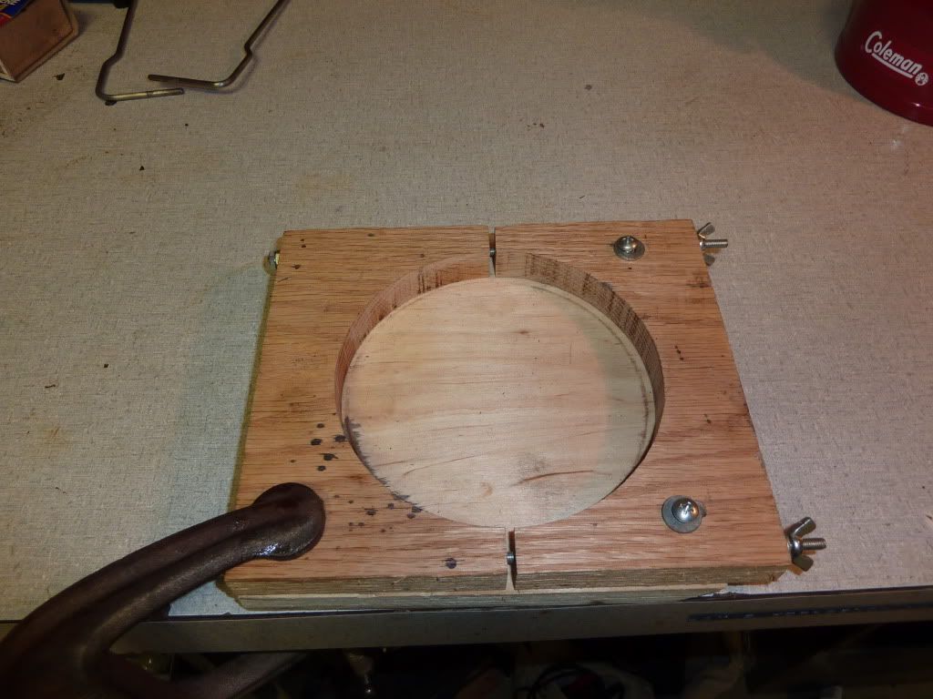

I had some scrap wood and cobbled this together using your plans. It works well, the rubber holds tight without scratching or denting. Thanks for the detailed post:

Home made fount vise
If it was mine I would glue a thin strip of felt on to it where the lamp would make contact then see if I could scratch the paint. Just a thought though as I have neither a lamp or gismo vice.
could this vice also be used for removing and installing a check valve?
Pastor Jeff
God said "Let there be light" so He let His Son shine.
SoCal and Lovin' It. Desert Rat Division
US Navy Submarine Cold War Veteran
MilSpec Ops #1960 "Feel the Roar"
It could certainly help keep the fount more stable.
