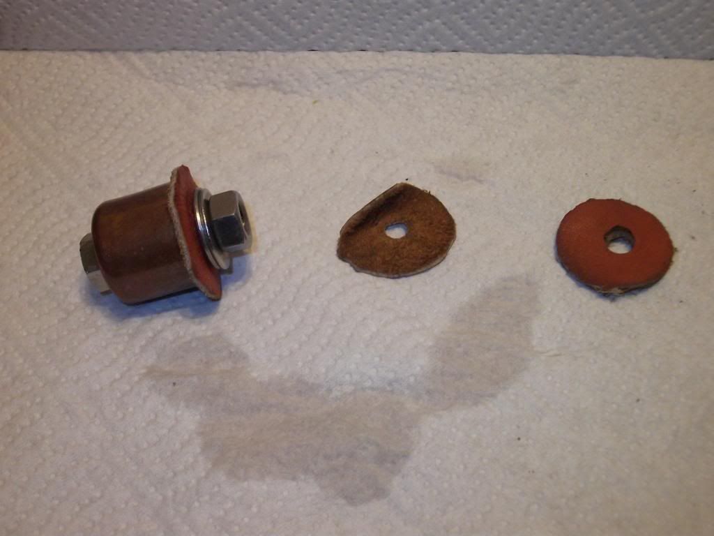

Here you go Lee. Tools and supplies; 1 in. dia. galvanized pipe w/caps ground sharp, 1/4 in. punch (for center hole); scissors; 3/4in. copper cap, drilled center; SS hex bolt 1 1/2in.; 2xSS washers; scrap leather.

Here's a close up of the copper cup with wet leather ready to be tightened down. Leave for 24 hours.

Bob, thanks I'll leave it up to the mods of course but I can go step by step if it will be helpful.
STEPS:
1. Select leather. Use leather that is top grain with a rough side also. The rough side will be the side in contact with the pump tube.
2. Purchase or fabricate a 1 1/16th in. punch from 1in. dia. steel pipe 1ft. long. Cap the pipe so you can hit it with a hammer. Grind down the inner surface to a sharp edge with a cone shaped stone from a Dremel type tool. Punch out the leather. Don't worry if your punch does not go through the leather, it will leave a trace mark after hitting it with a hammer and you can cut that with scissors. NOTE: A 1 in. punch may be very close to the neoprene pump cups but I haven't narrowed that application down yet. I recall having to trim one of these down a bit to fit my red 286 a couple of months ago.
3. IF YOU HAVE A NON-STANDARD CUP NEED: Trace the diameter of a current pump cup from your GPA (assuming you have one) onto aluminum flashing (not shown) or similar including marking the center hole. Cut the template out with snips or heavy scissors. Punch or cut the center hole out of the template. Use this to trace on the leather and cut out. Cut as many as you have the need. I usually cut 6-7 and I'm done in one week and it will take me a couple months to use them up.
4. You can use the aluminum template to mark the center hole in all your cup leathers. Use a 1/4in. hole punch. If you are good at eye-balling it, go ahead. Again, leather is very forgiving.
5. COPPER CAP. Take a 3/4 in. dia. copper pipe cap and determine dead center. I'm not a plumber but the actual I.D. of the cup is 7/8ths. I suspect it is designed to accept 3/4" copper pipe so it is labeled as 3/4in.? Drill it out with a 1/16 bit then 1/16th increments until you have it out to 5/16ths.
6. The SS bolt is 1 1/2in. long and 1/4" dia. and 7/16ths hex head (12mm?). The SS washers are 3/4in. dia. and the center hole is 5/16ths. Shove the bolt up into the cup from the bottom. Next I usually lock the hex head in my bench vice. Wet the leather with warm tap water for 1-2 minutes minimum, with smooth side UP thread the leather onto the bolt from the top (See pics). Place washers onto leather, thread hex nut on by hand and finish by using a deep well 7/16 socket. I usually center the leather a couple of times at the top of the cup before I tighten it up.
7. Let it sit over night; 24 hours is good. If you have some binding in the leather or 'ripples' on the side simply soak in warm water again but longer and add two or three more washers. Repeat final process. Remove nut and washers then place the leather, lightly oiled, into whatever container you want. You may need to pluck or push, with a small screwdriver or awl, the leather out of the cup as it may stick. Repeat as necessary.
STEPS:

thanks Bob, great tutorial. I have heard that saddlesoap softens the leather better than water, I guess I will try making some cups as I am running out of them

I''m Larry most of the time, but today I'll be Chuck.
When the water dries, the leather will retain the cup shape.
With Neetsfoot, the leather won't dry and probably won't hold it's form as well.
The real Chuck can chime in here with his own theory.

Hi Larry (or Chuck II) and thanks for the feedback guys. As Larry points out the water on the leather probably is more effective at shaping the leather as it dries. The bigger question might be to oil or not to oil when it's formed. I use a little 3-in-1 oil or Marvel Mystery Oil because I'm typically going to use them in a month or two and they won't loose enough shape to worry about. Too much oil and I believe they will loose form - but is it enough loss to worry about?
I'd use Neatsfoot oil or even Sno-Seal for long-term storage. No one carries Neatsfoot in this small town so I'd have to order it off the web. No hurry since even olive oil will work when its the only stuff you have.

I have left mine dry for months and they don't deteriorate or lose shape. The same goes for NOS ones that I've found in rat holes and the like that have obviously been dry for decades. I'd leave them dry until you use them as keeping them moist will attract dirt. As long as they are sealed up and kept dry, they shouldn't have any issues.

Leather pump cups from scratch-Follow up W/pics
OK, I propose a new rule. No more homemade tools or parts. Now I have to find the way to build pump cups. Does it ever end?
As far as the leather 1.5-2mm range leather falls into the 4/5 oz leather thickness. 1oz equals 1/64" so 4/5oz would be fairly close to the 1.5-2mm that is recommended most places. When buying leather from a leather shop they usually list it by weight instead of thickness. Just my 2¢

If anyone is thinking about doing this I just made 3 and replaced the neoprene in my sons birthday 288 and it works like a charm! Thanks Chuck!
-Cain-
I lift my lamp beside the golden door.
ICCC Member # 1288
ICCC Member # 1288
Fuzzfarmer wrote: Using this method, how do you "pluck" the leather and washers out after its dry?
I unthread the hex nuts, remove the bolt, then use a small screw driver and push up from the bottom through the hole. Sometimes I use an awl to push it up.

Wow Chuck! So far I've been lucky with leather pump cups. But as the collections grows I'm sure I'll turn to this as a reference.

Hello Rand? I don't recall ever using FB but I may have. I think after so long images get nixed here automatically to keep from taking up too much space on the forum.
Anyway - we have just purchased a new computer and I will have to ask my step-son to pull those off the old one. I may have them on my work puter as well and I'll look tomorrow.
The pics were just a pic of scrap leather, ss bolt and washers, 3/4 in. copper end cap, a punch I ground of of 1 in. galvanized pipe, and heavy scissors. Not a big help I know but that what I used.
I'm glad to answer any questions about the tools, materials, and process if you want to PM me.

Ok. Thats helpful. Yeah, it looks like they check out ywere published yo this site from Photo Bucket rather than Favebook if that helps. Check out the first two photos in this thread. They are missing. Thank You in advance.
What sized ss washers might those have been? Std for 1/4” bolt? WAIT. now I see you used 3/4” Dia washers. Thank You.
QL #15, Slant Saver #59, #0269 Turd Hurdler, #0269 Mil Spec Syndicate, Coleman Blues 243 #0269, BernzOmatic Appreciation Club #072, and a few others too.
P.S. I only used a ss bolt and washers since the leather was to be soaked in water every time. Regular grade 5 steel bolt, nut, and washers is fine.

I am posting here because I need to make some pump cups that are no longer available. The photo bucket photos do not appear for me. Might there be an alternative for the photo's for this thread so we can all see the photo's. As time go's on I believe this thread will become more important for all of us.

Sweet! Thanks Chuck. Now that I know how to whip up a tool so easily I'll have to see how horsehide pump cups work. I was waiting for it to get cold, but you have renewed my interest.
I'm thinking the horsehide might last forever.

some time back now Dan Boschen sent me a few of his homemade leather pump cups . well i needed a 427 penis style pump cup yesterday . there a smaller diameter than regular pump cups . i found the baggie of em with Boschen written on the bag , and sure enough i found a little green pump cup that fits n worked perfectly !!! thanks again Dan !!!

My home-made pump cups don't look quite like those in Steve's post above.....
