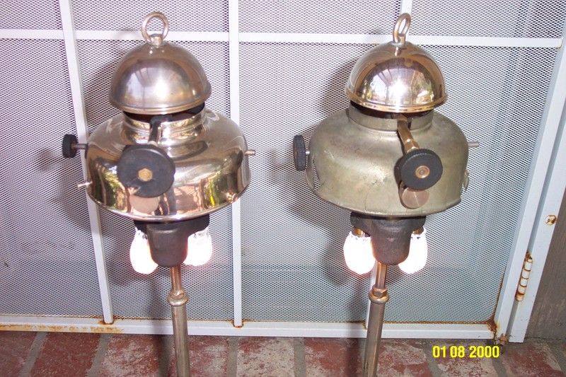

Good work Steve! I know you are excited. You polished the one in the center today?
Posts: 8254
Model R reading lamp
#53
ya , pretty excited here !!! but the one in the middle was the first and oldest one i got . it had a lot of rust inside and in cleaning it it developed a pin hole , but since it looks so nice from the outside i do plan on trying to seal it . all 3 of these founts are different , two have cork feet , one has the coleman badge soldered to the bottom , one has no feet . two fiber handles and one nickel handle . i think there was lots of parts modifications along the way in the factory . no two alike here .

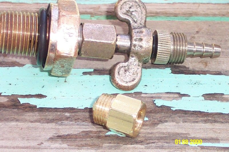

and just so others know , a quick lite lantern valve shaft fits right in with no real modification for those who are missing there valve wheel . thats how i added missing wheels for both the valve and the shade holder here . i do have the original wheels but the big one is broken off and the little one is in good shape but the shaft is broken , so im working on trying to press the wheel off and on to another valve shaft ..... gatherd tools for that last night , just been to chicken to hit on it today :-)

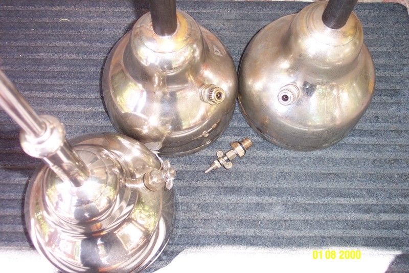

I found an "R" fount w/ nickel handle for a few bucks at the flea. Hole in the bottom. It has the fuel cap/valve

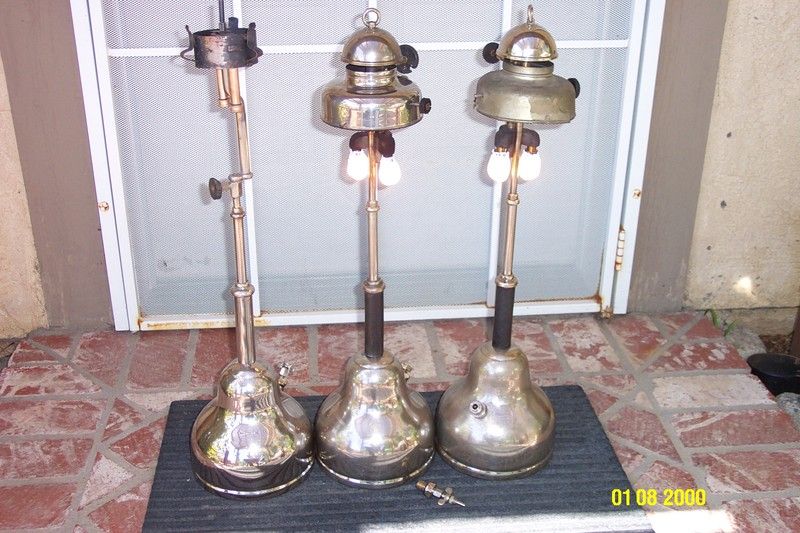

Well Steve.......congrats, at last. Some time ago you said you did have an incomplete R lamp, now it turns out you got two and a half. You must feel like over the moon. Will try completing my own R now.

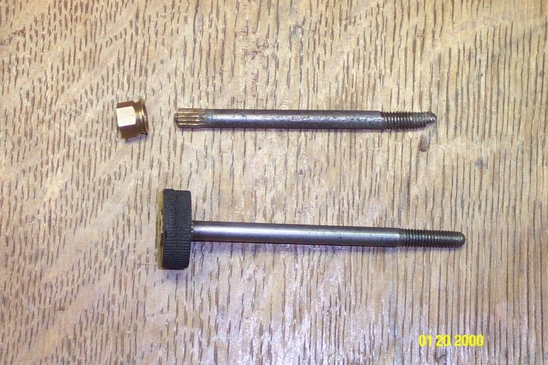

scared to death i tried something and it worked , the shaft to hold the shade holder on the model R lamp uses a very small valve wheel . one of my lamps was missing the wheel , and the other shaft had the wheel but the shaft was broken off about an inch short .... i contemplated this for a few days , and finally went for it . knocked the wheel of the one and tapped it into the good shaft . wish it would go on just a bit deeper but i was having to hit it pretty hard so i stopped before i jacked something up .......im calling it a success !!!

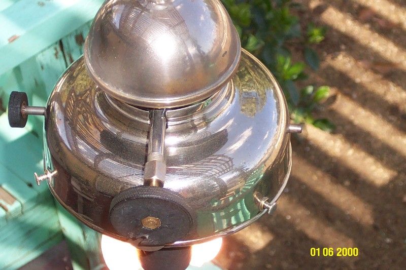

something i forgot to mention here is , on all the model R's i have seen the valve wheels are in backwards ( i know there not backwards as its how coleman did it) but there reversed compared to all other valve wheels i have seen with the brass hex part showing towards the front instead of the the round brass ring , so thats how i did it too , just looks odd after seeing so many quick lite and air o lites done the oposite way .
[20080617_333029]
Posts: 8254
#62
here is something else i just noticed , i thought it was just a plyers mark but with my good readers on i can clearly see this model R gas tip is stamped with a number 1 on it .......similar to how a Q99 gas tip is stamped Q .

Model R on the left & Model C (R) Q on the right. Found the fount and handle/fuel tube at the flea for like $3 and put a CQ burner and 306 shade. There is a hole the size of a half dollar rusted thru on the bottom
[Coleman%20R%20amp%20CRQ%20Reading%20Lamps_zpswkgogltr]

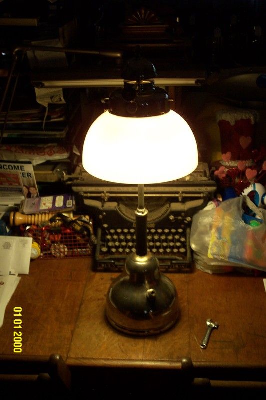

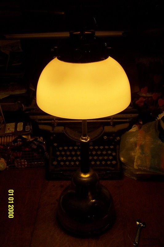

i finally have the first one up n running [sHa_yes2]
as if i were at the Academy of Coleman Awards i have to give thanks to many of the CCF members here .
a big shout out to
Darren Pruitt
Will Nelle
Greg Diehl
Dylan Bowers
Honerable mentions include
Mel Taylor
Glenn Knapke
Roland Chevalier
Smitty
Mike Merz
Dean Williams
and many others .
as none of this would have happened without you guys , im eternally grateful for all your help n continued support here !!! the next one isnt too far behind :-)
Posts: 8254
#71

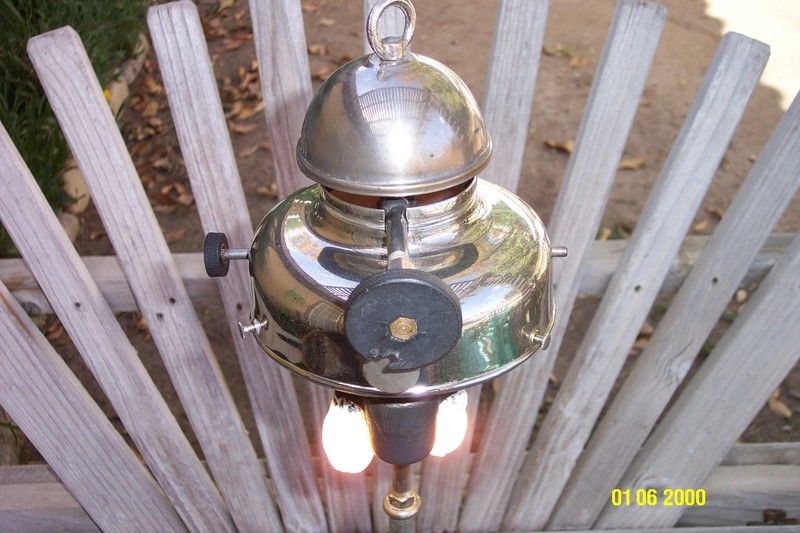

now it took a bit more pre heat that i expected before it settled down , i was a bit nervous sticking a propane torch up inside the the burner so close to the lamp shade . after it lit i had to keep the torch there for another minute or so before all was well . my blood was really pumping , im sure there was some adrenaline in the mix . so so happy to see this fired up . only issue was on shut down i noticed the small shade holder wheel was smoking a bit as i had just oiled it yesterday to darken it up , i wont do that again as it gets pretty hot there . then when i went to shut off the main valve it was like stuck , i had to turn it pretty hard to make it turn , i was using the original packing in the packing nut as it turned pretty easy cold n sealed good , i may want to put in a new packing as i think that was the issue but not absolutly certain just yet , still to hot to inspect . im all smiles here !!!!

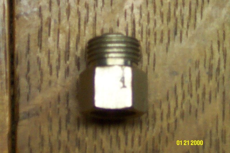

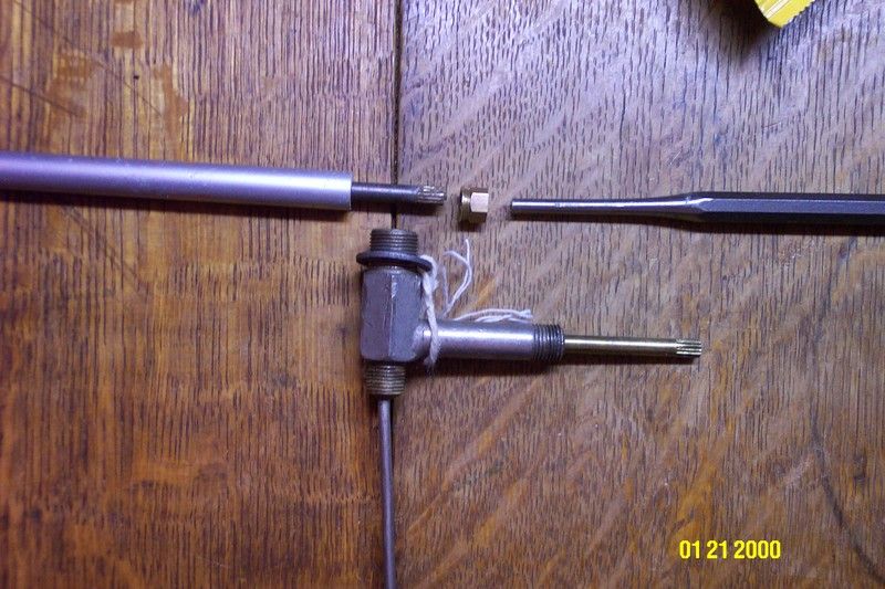

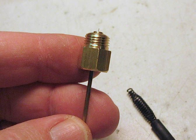

check this out , remember when i posted this pic of a little check valve at the base of the model R generator , i couldnt figure out why it was there , and still dont . after the lamp had cooled off i opened the fuel cap to let the pressure escape before i attempted to see why the valve wheel got so stiff , i had completly taken the fuel cap off the lamp yet when i open the valve wheel its releasing pressurized gas that is held between this check valve and the valve . i dont really think this check valve seems necessary yet i wonder what its purpose is , i probobly dont understand something that may be important ? its not like any other coleman i have worked on .....you guys have any ideas ???
like maybe so it holds some fuel in the generator for the preheat ?
this pic was when i first took it apart , its nice n clean now .

I remember that Phil offered a really neat explanation for the valve, but Ill be damned if I can remember what he said. [sEm_blush8]
Roleman Coleman - SAY NO TO "NO LETTER"

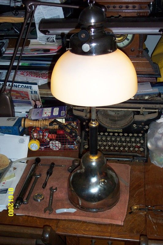

UH OH , figured out why the valve shaft was hard to turn after warm up i could see a spot on the valve shaft where it looked like it was rubbing as it was shiney in this one spot , i just used some emery cloth on the shaft there , then some steel wool and put it back together and the shaft feels super smooth so im gona do another test fire .
pump it up REAL good ( i think that was a mistake ) get the propane torch out and start pre heating , after a bit i crack the valve and it came to lite for a second and then it flared up ( and was getting soot on the shade ) so i keep the torch inside untill it settled down had it burning only for a couple of minutes and i heard a loud " TINK " i know this sound and immediately shut it down . when it cooled off and i take things apart a chunk of the shade had broken off where one of the 3 screws hold it to the shade holder , i want to CRY ............the good thing is if i turn the shade there is still enough neck to be secured by the 3 screws .......in hind sight i think i had it pumped up too much so it had to get real hot to vaperize the fuel under so much pressure and i just got it too hot to handle the heat expansion . makes me think these screws should almost be left loose and not snug , i didnt have em tight but i snugged em till the shade was held firm , im thinking a little loose in the future ....... time for another test fire under LESS presure ..........still crying thou [tissue]

OUCH Steve, that really sucks! Sorry to hear that. Hard to tell exactly why the shade broke, but your explanation sounds plausible. I usually just touch the glass then back off a 1/4 turn, just cuz it seems about right. Not sure if this is a good rule, or I've just been lucky so far. One of my No. 74 shades is quite thick, and I've made it my user for that reason. My other two No. 74 opal shades are whisper thin, and I'm afraid to even look at em.

the neck on this shade had a few little chips in it when i got it , i wonder if i put one of the screws right near a chip might have contributed too . i have it all back together and it still holds the shade just fine ...........keeping my fingers crossed as im gona fire it up again ......
still trying to figure out what this check valve is for ?

you can see the piece of neck that broke off here . this thing takes more preheat than im used to . it must have been hard trying to lite these with an alcohol dipped torch .

Gosh, I'm sorry to hear that, Steve. I'd be inclined to try a nice epoxy job on that with
JB weld. It's already broken out, so it won't hurt the shade value, right? Also it will be
hidden under the bell and it may give it a little more support, just in case.
On shades like that, or any kind that used the three screws to hold a shade to a lamp, my
dad always used to say just screw them in enough to touch, then back off two just a bit
so the glass could "move".

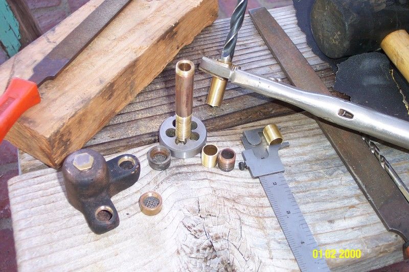

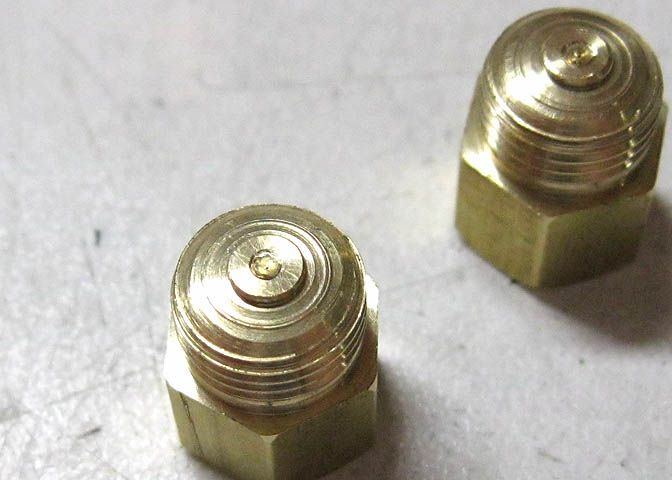

made some burner tubes , repaired the air tube , and cleaned up a bunch the burner threads . really nice have the right size tap n die to do these things .

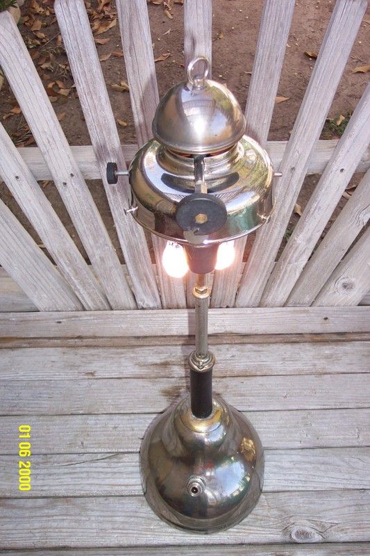

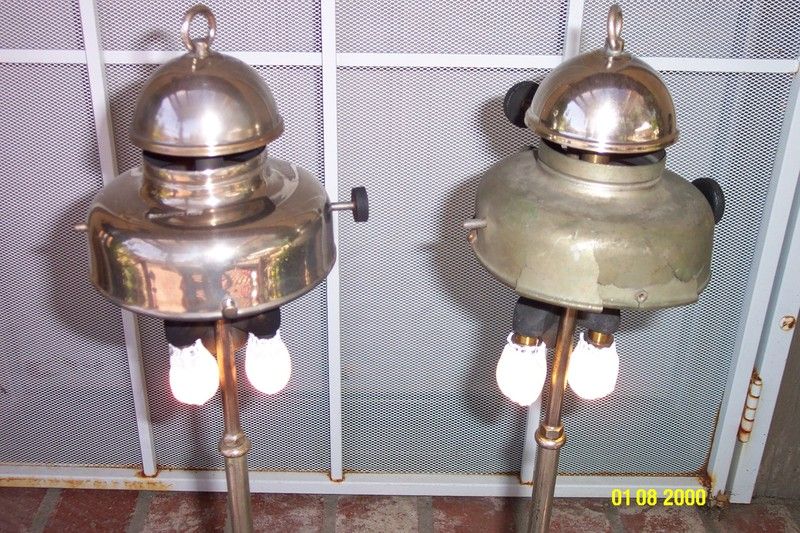

more test fireing today . im using a different valve body from the last time and i have reattached the original large valve wheel . it was completly broken away from the valve shaft and has a chunk missing , im still contemplating ways to fill missing chunk . but i went ahead and used JB WELD to reattach the wheel to the shaft . its kinda tricky getting it a perfect 90 degrees i just kept eye balling it till it had set up , its pretty darn close . im very happy having both original fiber wheels on this lamp now so its all original ( the other lamp i have substitute quick lite valve wheels ) ... before the JB weld set up i used acetone on a Q-tip to clean up the excess so the JB weld isnt even really noticeable from the front side .
this valve is also nickel plated (the other valve is plain brass ). on this lamp i have used all the best looking parts . ( i do have a better looking earlier nickel handled fount but it has a pin hole yet to be repaired )
i used some peerless mantles today , i had used some coleman #20 mantles for the first fire tests . im just playing around see what if one is better than the other . one of the peerless mantles when it had puffed up and SET turned and is sitting very close to the generator . il probobly change it just cuz i hate when that happens as it makes it very hard to move the burner without braking mantles .... i meant to turn in the air adjuster and play with that adjustment but it was way to hot to turn by my fingers , il have a screw driver handy next time to turn it in and out next time ..
i keep doing little things as i think of em , as far as coleman goes all my thoughts n focus are still on the model R's ........ it takes way more pre heating than i have ever had to do with any other device before it comes to life . and i lit it this time with no shade on it trying to keep the shade safe as im learning the ins n outs of the R's ....but i wonder if that is part of the long pre heat issue , with the shade on it funnels all the heat up to the burner , with out it and a little breeze here may be why it took so long to preheat , but once burning right it never even flickerd from the breeze . i heard of another person " Dwayne " who used a clip on Tilley pre heater to preheat his model R , i may try that too . i was using a propane torch .

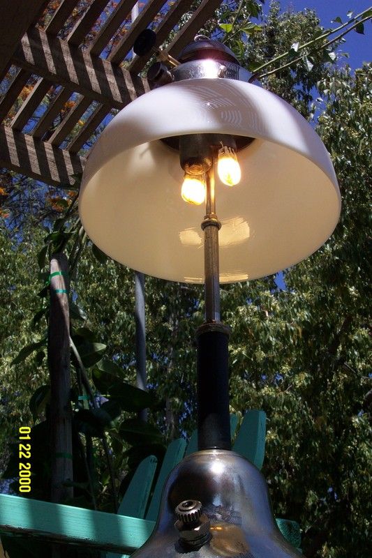

did some more test firing today . here is the updated info . there may be more variation to the founts than this but here is what i see , of the three founts i have all three are different . have a look at the bottoms , i believe the earliest has the cork feet and the coleman badge soldered on (this one also has the nickel handle BUT MAYBE YOU CAN ALSO SEE THE PIN HOLE ? ) , next has the cork feet but no badge and the last one has no badge or cork feet (THESE BOTH HAVE THE BLACK HANDLE ) .

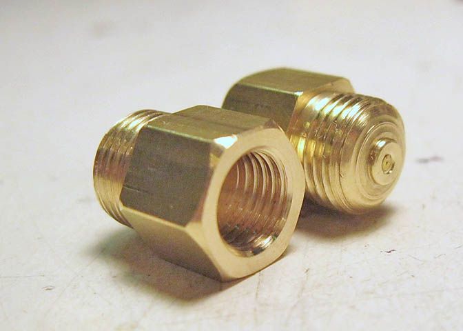

But the real EXCITEMENT is here [sHa_yes2] i asked Deanofid if he could help me out with a 2nd Gas tip as i only had one . Dean Williams is a true craftsman to be able to make up a model R gas tip from a drawing and some measurements i made from the original tip . it took me a few days to make these measurments using a micrometer , i do feel much better aquanted with the micrometer after all this . its just beyond my wildest dreams .
just received the gas tip today so i had to put it to the test . it was very windy here today making my preheat a little more difficult . i had to put the lamps right next to the house to block the wind . Oh , and i used a air o lite lamp fuel cap as it fits the conventional coleman hand pump tip much better , as i have yet to locate a screw in hand pump . this just has me all SMILES inside , feels like ecstasy !!!
using peerless 2C-HC mantles here , its kinda hard to tell in the pic but both lamps are lit , its so sunny outside and using the flash kinda over powered the mantles . i did adjust the air adjuster this time but really couldnt notice any difference . doesnt seem quite as bright as i expected but it may just be cuz its so bright outside today , a night time lite up will show what it can do better ..... Cant Thank You Enough Dean !!!! your tip is in the lamp in the middle here .
to preheat these sure takes a lot longer than i thought , both flared up when i cracked the valve so i shut it off and kept the torch on it , had to do this a few times before it settled down . leaving a little soot inside the shade holder / burner area .

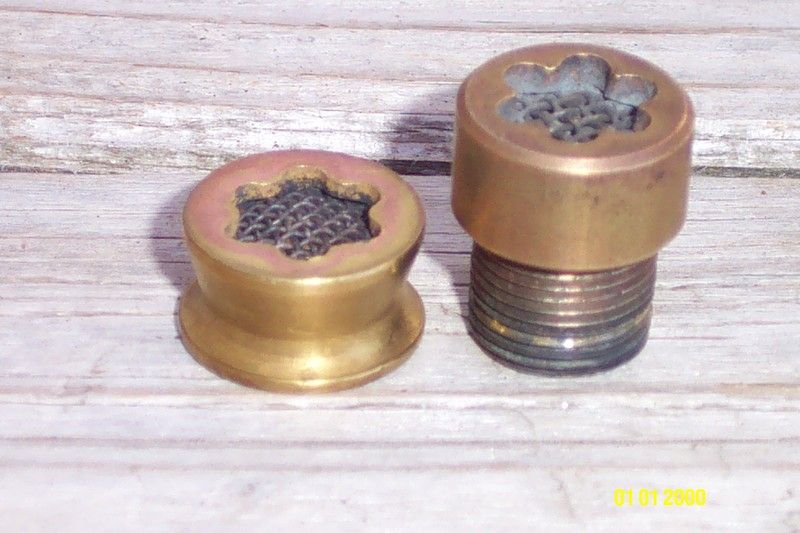

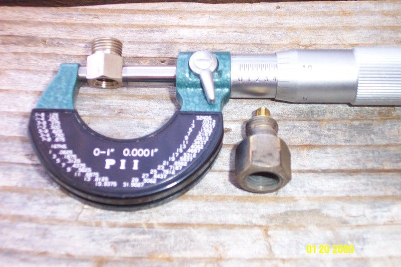

here is another thing i did , for the second lamp i only had one original model R style burner cap (there is no ring to tie on a mantle , the mantle ties directly to the threads on the burner tube above the burner cap . so i made a home made pair of burner tubes . the regular 220 burner caps are the same thread so i used a pair of them here . this puts the mantle lower . with the original burner cap set up the burner cap is almost in the middle of the inside of the mantle . something else i noticed is in the newer style of burner cap when a mantle is tied on it helps flare out the mantle making more round than oblong ? seeing little things like this are just part of the evolution of Coleman improvments over the years .
[DCP_2275_zps7lsvt2gm]

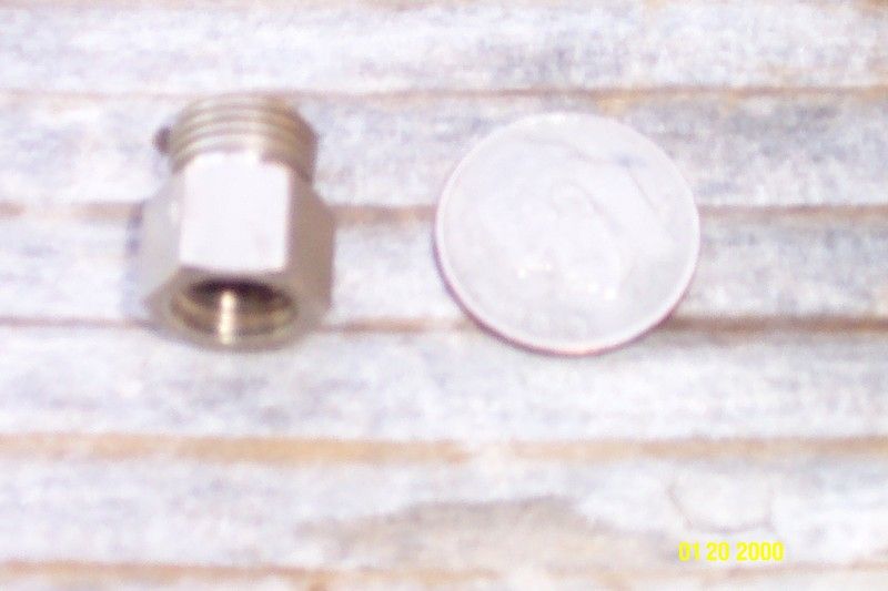

Looking good Steve! Are those gas tips similar or the same as the one on my Sunshine Safety Model AA lamp? It looks a lot like it from what i remember, but it has been quite a while since I had it apart.
Tim - ICCC Member #1217
Posts: 8254
#100
Tim , its a different animal . i tried thou :-)
