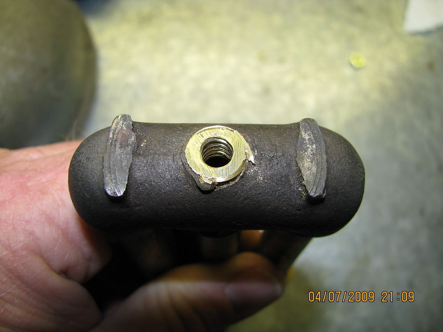

On my Quick-lite lantern the previous owner must have tried to do a restoration. Lucky for me, they gave up before they completely destroyed it. Apparently they removed the vent stud and wrecked the threads in the process. They then just screwed a plain panhead screw thru the vent into the wallowed out hole left in the top of the burner. I would hate to see the melted results if they got it to light off. It would have had gas shooting out the top of the burner.
My question is: Has anyone tried to repair the threads on the top? I have some poprivet type thread repair stuff at work. I have thought about trying to braze the hole shut and rethread the hole. Any ideas??

I think I came up with a fix. I was trying to find the right size of brass rod to thread a plug from. It's really hard to find brass bolts, no one has them. When I started looking in the brass water fittings. I got a 1/8 NPT x 1/8 tube adapter fitting. I think I'll drill and tap it to 1/8" NPT and screw the tube adapter in till its snug. Then grind off the tube fitting end. Then rethread to the correct size for the vent stud.
Wish me luck.
Added on 10/30/2009:
Here's a picture of the finished job:
