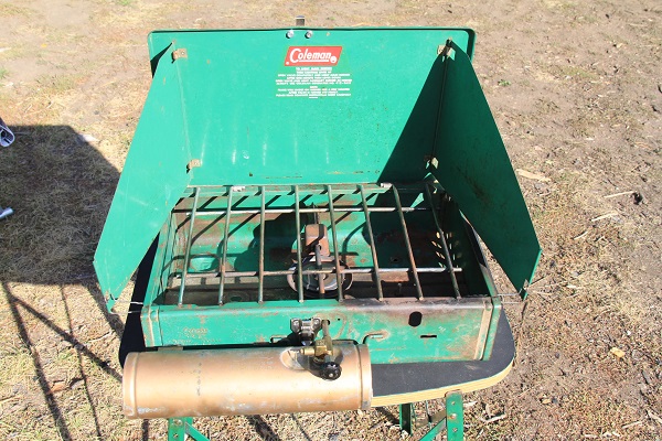

Stovie wrote: Sun Jan 31, 2021 11:41 am Appropos of nothing, I was looking over the design of my 425D and got to wondering about the myriad offerings Coleman offered over the years. Single burner, smaller stand alone stoves were of course well represented, but never in a suitcase design with windscreen. I think they could have made a go of it and would have been popular.
Sometimes a guy's gotta take matters into his own hands.
Posts: 930
Re: Why no single burner suitcase stoves?
Nicely done! And I like the extra storage space!

Zulu Kono wrote: Sun Jan 31, 2021 7:25 pm
That's a cool setup! need to show that to my son...
Ok I've been thinking about this post all day, about the extra suitcase stoves I have and cutting one down. Then I see this, best idea ever.
I've also been trying to figure out a stove setup to keep in my willys, mostly to make coffee or heat up lunch, well here you go. Not alot of extra room in old CJs, this would fit perfectly.
My only question is how did you plug the tube? I was just thinking of welding a plate over the hole.

bowenstudios wrote: Sun Jan 31, 2021 10:20 pm

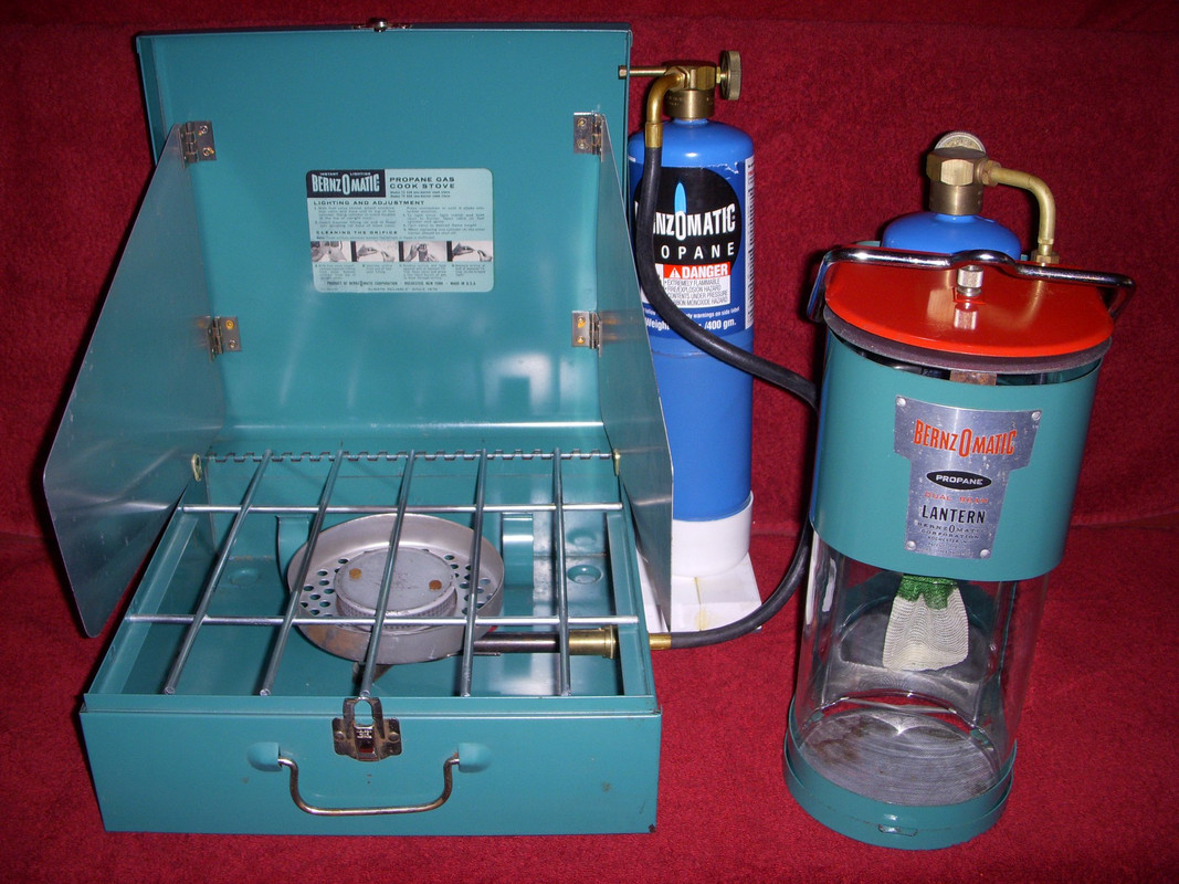

Maybe use a 502 burner then there’s no welding. Just have to secure it to the 425 burner base.

Zulu Kono, Great idea! And picking the 413 even better. While the 425 is a great stove, the 413 allows you to use any size pot or pan. My son routinely brews up a large stock pot full of corn or pasta on his 413 stove. All ready sizing up a old 413 for the "Zulu Kono coversion" Thanks.

Zulu Kono
Posts: 83
Joined: Sat Oct 31, 2020 5:51 pm
Title: Like a Butterfly A Wild Butterfly
Post by Zulu Kono »
Paddywonka
Posts: 194
Joined: Sun Jan 26, 2020 12:05 pm
Post by Paddywonka »
Clever on the plug. Would not imagine there wold not be any problem or leaks with out any real pressure.
Already pulled out an old 413E, for the ZULU mod. Thanks for the closeups and details, it will make it so much easier. I'm not a good innovator, but I am a great copy cat. Looks sturdy & well thought out!

I also thank you for the details and inspiration.
I foresee several copycats coming soon. I'll probably just weld or braze the hole. It would be cheaper and faster than going to find the plug, but good to know the option for those that dont weld. Finally something to a do with atleast one of the extra suitcase stoves I have squirreled away.
ok I never realized the burner parts screwed together on the earlier suitcase stoves. Now I know.

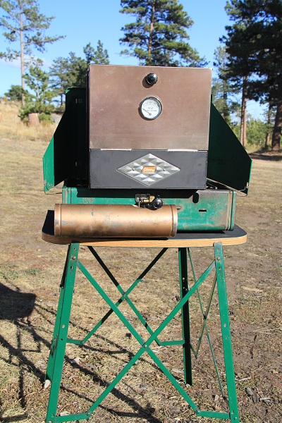

Posts: 2841
I cobbled this together so I could use my oven.
The oven hung out over the front quite a bit so I went back to my other frankie stove.
Paddywonka
Posts: 194
Mark, That is another great conversion. Sure would put an even heat on the oven, and not overheat the stove case. Looks like I will be repurposing a couple of stoves now!
Stovie
Posts: 251
Post by Stovie »
As an added bonus that thing should pickup 850 KOA loud and clear! :)

It looked like Outlawmws used a 413 and I didn’t have a 413 to sacrifice, but I did have a 425. I cut the aux burner tube about 3/4 inch from the main burner and capped it with two appropriately sized washers and a machine screw with nut. It took some filing to get the tube perfectly flat so the washer sealed. It also took some searching to find a coffee pot that would fit the smaller case dimensions. A Stanley stainless French press worked out perfectly. That along with cups, spoon, coffee, matches, cream and sugar are ready for a road trip. I wrapped a few of the items with a couple new shop wipes, so it travels relatively quietly (thank you Burnt Bacon).
I didn’t include a picture of the finished product because it virtually mirrors Outlawmws.

Gunhippie wrote: Wed Feb 03, 2021 1:17 am Or:
A 500 with folding windscreen works awfully well, looks good and is easy to pack.
Handles a #10 CI skillet just fine, too:
I couldn’t agree more!
From last Oct. while bird hunting...
