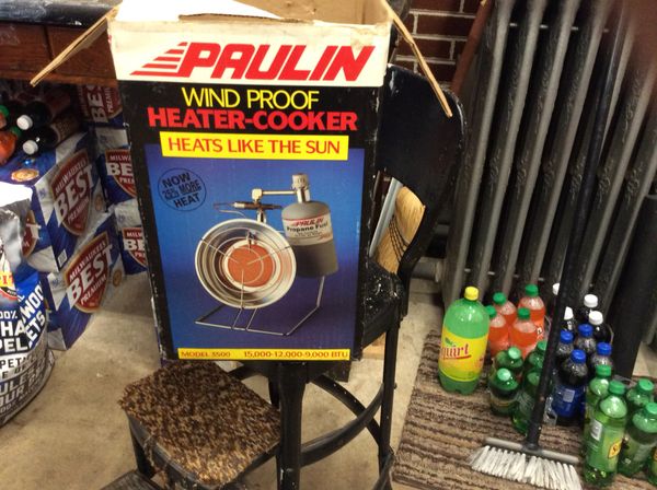

I updated my list with some heaters. I got out my Paulin 3500 to warm me up a couple days ago and looked up the Btus (15,000). Got it back in the 80s and runs good and duals as a stove. I usually run it on an 11lb tank. -Gar
This is a stock photo:
