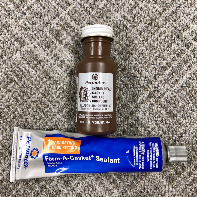

If I have concerns about clocking issues I use Permatex #1 hard set. I’d use Red Gasoila hard set if I had it.
For everything else I use Indian Head shellac.
Never had issues with removing fittings after either one of them. No heat required and will completely clean up soft or hard with DNA.
