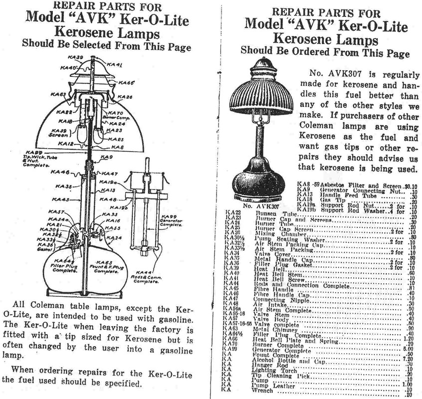

I had fallen off the Coleman collecting wagon for a few months but this find helped me get back into it.
Sitting all lonely like on a table at a garage sale, with a good old fashioned garage sale price tag!
This is an interesting lamp as it was obviously well looked after its entire life. The cap nut on top is interesting...never seen one like that before. The upper frame is also unique, or at least it is to me. Any comments on these items or anything else about this lamp would be appreciate. Date? 1919 ish?

The filler cap is the same one used on a 316 arc lantern and 319s

It is an “AVK”
A - is the fount designation
V - is the arc burner designation
K - is designation adjusted for kerosene.

coleman54 wrote: Sat Jun 05, 2021 8:46 pm It is an “AVK”
Thank you for the clarification Larry! I like these early ones 👍

That’s a very rare lamp and the early shade. I think it’s a Kero burner.
It’s a
1913-1920: Model “AVK” Ker-O-Lite Table Lamp

. OK this shows both early n late style burner frames . double click it for better viewing . that is a super nice find , id be all excited :-) so to my understanding you need to look at the gas tip marking and see if its marked for CF or kero ? dont recal the markings off the top of my head . one is an Arc tip ,

it is missing one thing , the upper shade holder . with it it hold the shade pretty secure . without it its easy to why its cracked , its too easy to flop around like this . the upper piece is part of a sandwich that holds it all together snug . you can sorta see it in the pic on the left .

Do you have a photo of said holder Steve? If it is what I think it is, it is there as well but the little "wings" designed to hold the glass were bent in so it was just sitting on the inside of the glass collar. That makes total sense Steve. Will carefully bend back and try fit it after I glue the shade. In the sixth photo on my original post it can be seen but isnt clear since it was bent in.

gota go one step further :-) n take off the nut that holds the fount ID disk off n look under there ? often these old un molested ones have a fragile paper label or tag under the disc , like a builders ID number . that hasent actually been determined but its sure cool to see ??? everything else is there , i think this is un molested . they sometimes disintegrate looking at em so take photos , or dont bother :-) just a super cool find :-)
