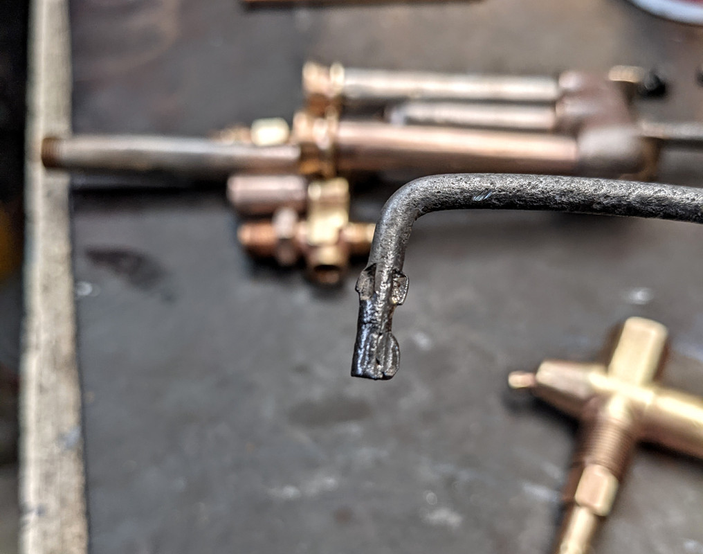

Majicwrench wrote: ↑Wed Oct 13, 2021 11:36 pm Both have keyed bails, BUT one of em is a mongrel, has a 228D collar, who knows what else has been messed with.
If the bails are swedged on the upper side only (what I call keyed) those were only found on 1930 models.
Here's an example I had to rebuild using a tack weld with a little file work.
