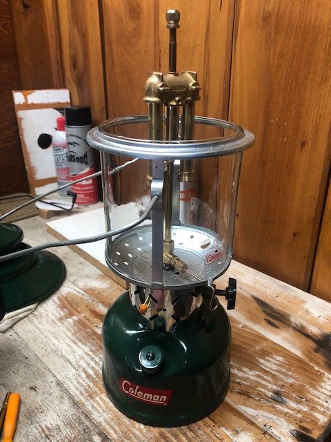

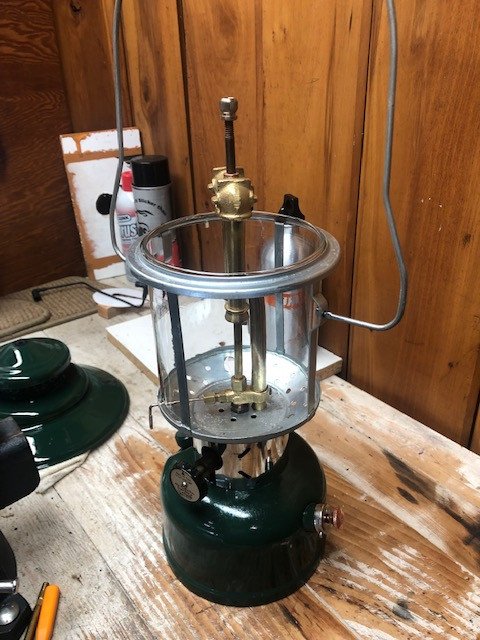

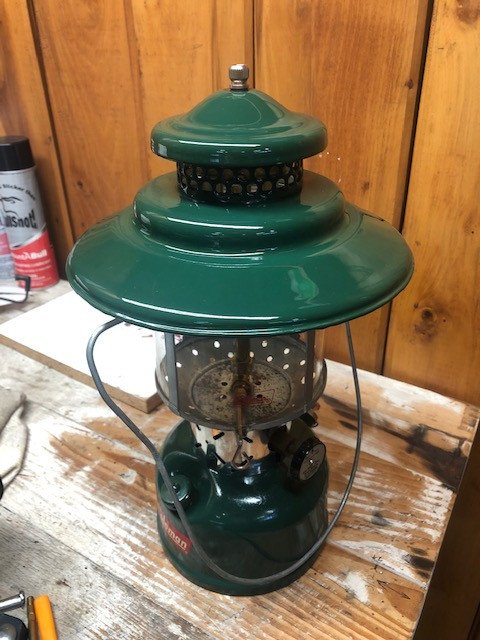

Hello All, I bought what I thought was a pretty good example of a 1/60 228E. I broke it all the way down and gave it a little polishing.
This is my oldest addition so far, and it predates me by many years too. I was impressed by the pump assembly(the pump shaft is threaded making the cup easy to r&r and the knob is what looks like copper(it was almost black as I received it)), otherwise it's very similar to the half-dozen or so 220F's that I always seem to find(I find it hard to leave a cheap lantern behind).
It's not perfect in any way...the fount paint is a little rough, the frame has a little rust in the bottom, the vent has one spot around the perforated area that is missing enamel and has some rust and a couple of other things.
Would I like to be better? Sure. However, with the way she is I plan to make her the sunshine of the night again soon.
I also think she's all original with no parts having ever been lost or replaced...What do you think?
My only regret is I wish I had some of the old coarse weave silk-lites to hang on her. I think that'd make her look perfect.

That is a nice lookin big hat E! The brass is like new! I think you did a nice job. The pump knob is brass, was anything soaked in vinegar to clean up? If brass is left in vinegar to long it will turn it a pinkish color.

Kgam1020 wrote: Thu Sep 22, 2022 6:50 pm That is a nice lookin big hat E! The brass is like new! I think you did a nice job. The pump knob is brass, was anything soaked in vinegar to clean up? If brass is left in vinegar to long it will turn it a pinkish color.
No vinegar used in my process. I have a hobby size rotary tumbler. In it I use lemishine and dish soap, for media I have stainless pins. I broke down the brass assembly of the lantern into individual parts and ran them in the tumbler for ~45min. They come out nice and bright...if they are really bad, this one wasn't, I just tumble them longer. Not sure why the pump knob came out more pink than the other brass, all parts were tumbled together. I also polished the frame rest with metal polish while the brass was tumbling and cleaned the globe, fount and vent too.

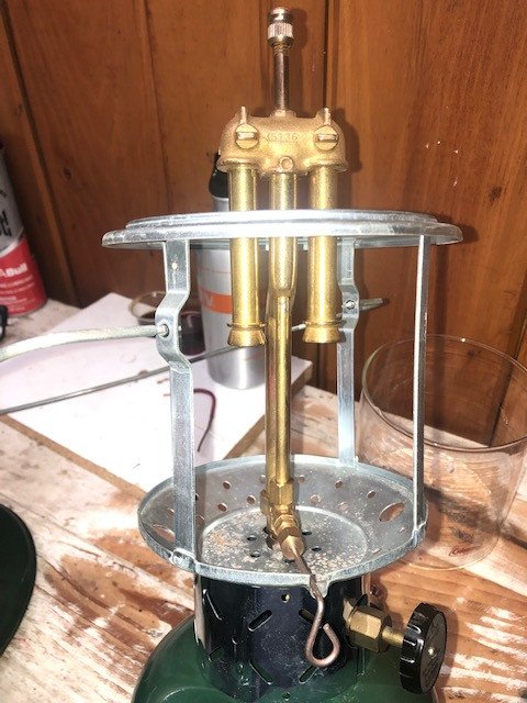

BTW, I didn't want to mar the burner tubes so after looking them over I tried a torx T55 which fit well inside the burner and I was able to remove them without issue. NOTE: If anyone does this just be sure not to insert it too far or you'll push the screen up into the tubes. A the butt of a bic pen can push the screen back down to the caps if you do stick it in too far.

That is a great looking 228. Classic style and a big hat to top it off. Agreed--coarse weave Silkies look right at home on them too.
