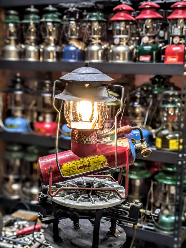

I was wondering if anyone here could tell me what type of propane cannister this Higgins lantern uses. Are they still available?

The standard long torch ones
Re: Higgins profane question
Not all will fit, sorry I don't remember the recommended bottles (worthington maybe?) Others in the know will chime in shortly. Cool lantern
I am not sure the modern ones are a perfect fit. Seems like some adjustments may be necessary. But I could be wrong. It could be that the adjustment was needed on the upright version but I remember a thread about this sometime.

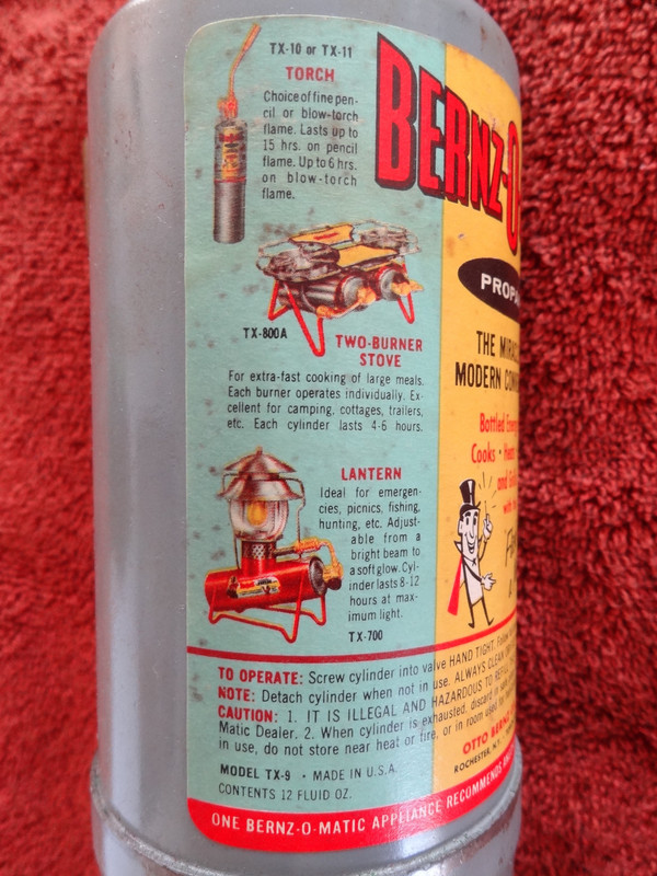

No, the modern ones will not fit. There's a seam in the current ones that will prevent you from inserting the bottle. I grab old bottles at yard and estate sales, and they can typically be had for a buck each.
Someone on the forum once mentioned grinding down that seam on the propane bottle to make it smaller so it would fit. I'm not sure if he is still with us.
An alternative is a modification to that tube by opening that weld, then spreading the tube open. Not something I'd want to do with a classic lantern like that.
That one is extra special. I've not seen or even heard of a re-badged Bernz-O-Matic rocket launcher. Plus, that's in really nice shape!

I've found that Worthington/Bernzomatic cylinders are slim enough at the center joint to fit. There may be a slight bump going in, but they fit in all of my rocket launcher lanterns and stoves and the dual beam.
The height difference is compensated for in the design with the gas tube sliding in or out for installation.

seems like the one on the left is a little fatter but shorter? is that the original that would fit? could be an optical illusion or i need to go to sleep and rest my eyes.

Or find an original to refill..campinut
