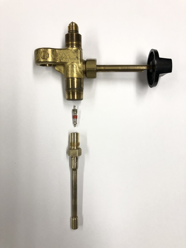

Here are some images of the valve assembly so you can see what lies within. At the very top is the nipple where the generator attaches. Moving down you have the valve body and at the bottom is the fuel/air tube.
When you remove the F/A tube you can access the Schrader valve core. The little valve core is nestled into the F/A tube.

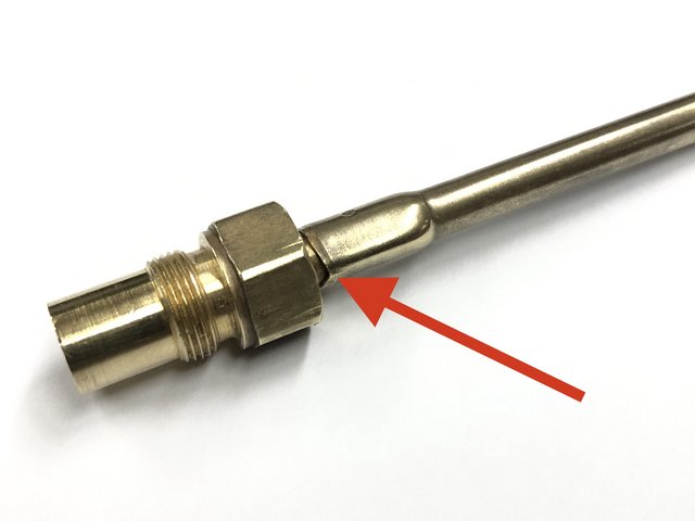

The F/A tube has a few openings. One air inlet on either side as illustrated by the red arrow:
When the pickup is plugged, that is where pressurized fount-air is going into then up through the valve.
And the fuel pickup orifice:
That fuel opening is very, very small--smaller than pin-hole size. I use the generator pricker wire to clean them when needed.
