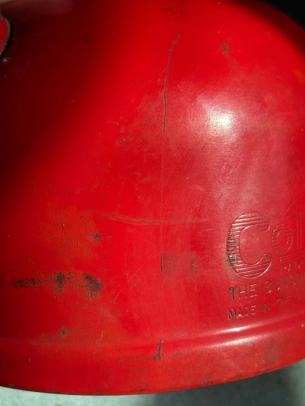

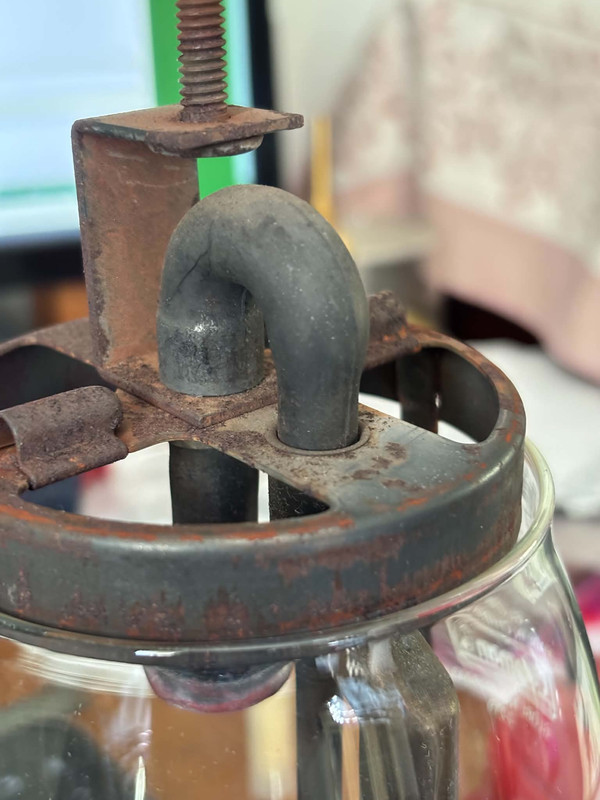

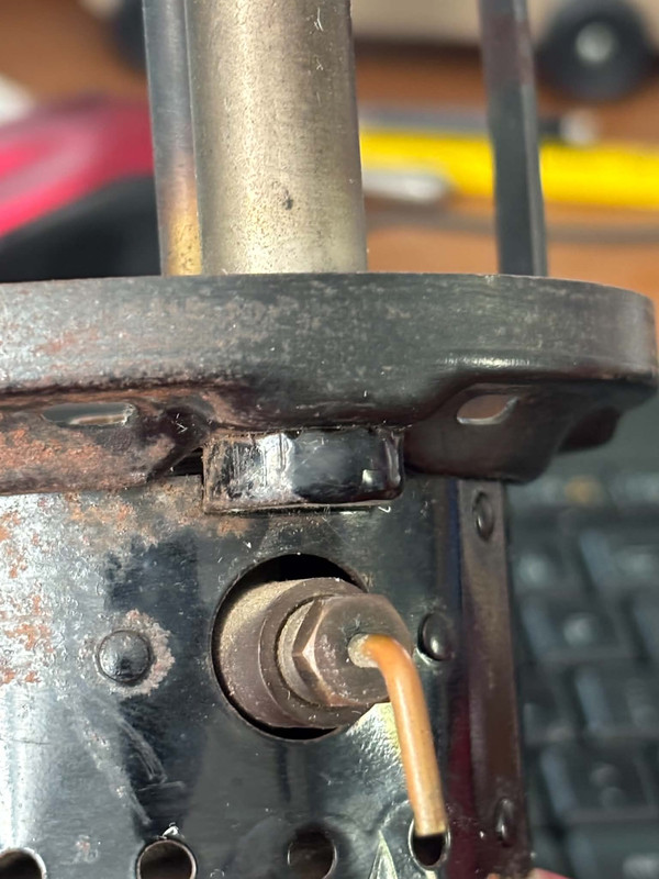

Just acquired a 1952 black band 200A lantern. Some questions are as follows...
1) Was the frame also black along with the frame rest (collar)?
2) Was the black band itself steel?
3) Was the fount steel?
4) was the fuel knob red or black?
I was surprised that the fount was steel. Thought it would have been brass with a steel bottom. Looking at the frame it looks like it was black as well. The U tube on the top is tapered, which is I think is different than my other 50's era's 200's.

The pictures of the fount was me thinking it was a stress crack but then found it was a steel fount.
Posts: 9311
Re: 200A black band questions
Yes to all the above and the knob was red with a solid back.

From what I understand, the frame rest is a gloss black while the frame above is a flat black.

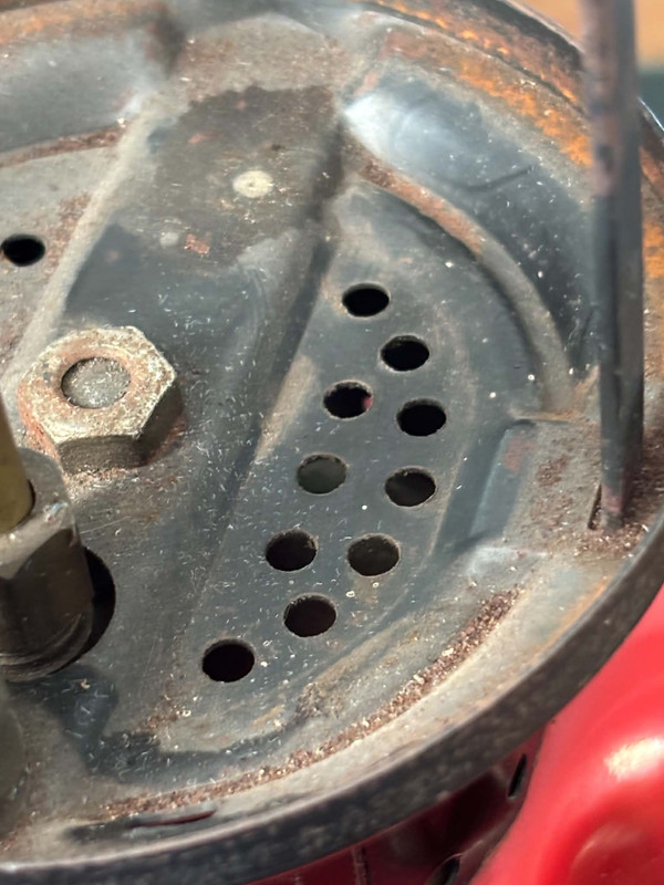

I really want to curb the rust but not take any of the paint away doing so. The lantern is in pretty darn good shape. I want to keep it looking the way it is. It does not look to be tampered with.

Nice find, that should clean up nice. I wouldn't refinish any paint. You could try WD-40 sprayed on some 0000 steel wool and go at it with a light touch. The one piece u-tubes sometimes need the tinfoil treatment of some muffler cement to keep them from smelling when running. Can't wait to see it fired up.

That original paint is in good shape. I’ve seen a number of black bands on which the black parts were heavily rusted.
I agree with Big Jack, approach the rust with WD-40 and 0000 steel wool.
